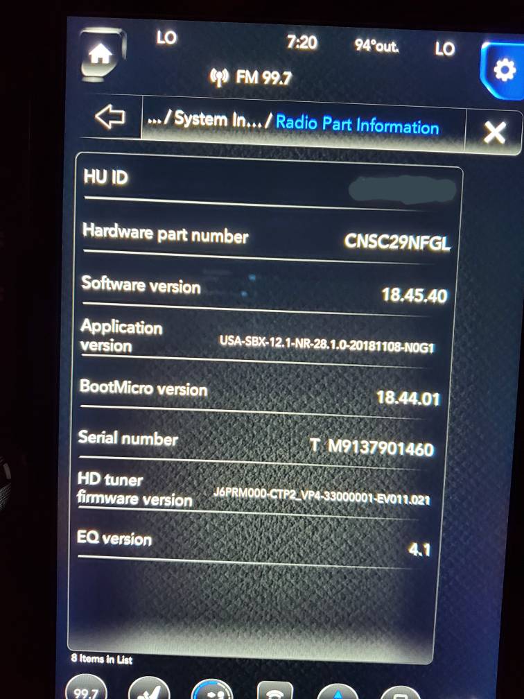

Uconnect 12" Software revision 18.45.40 Issues listed - PLEASE BUMP and respond so I can get this sent to the right person(s) at FCA.

My 2019 RAM 1500 Longhorn Laramie build date 06/2019 came with Software version 18.45.40 and didn't experience any issue.

12" screen version: 18.45.40

I guess 18.45.40 is the "latest and greatest"? I thought there was an update coming out, but I got my truck back after a month at the dealer and that's the version of software on it. :|

Picked up my truck a week ago, took photos of all the screens at the time. As you can see, I have software version 19.33.11 and with the limited time with the truck this last week, I do not have any of the various issues being posted by others. Could this be the infamous 4th Q update?
Build Date 11-07-2019
What model do you have? Mine is a September build with 18.45.11 and I have a Limited.
