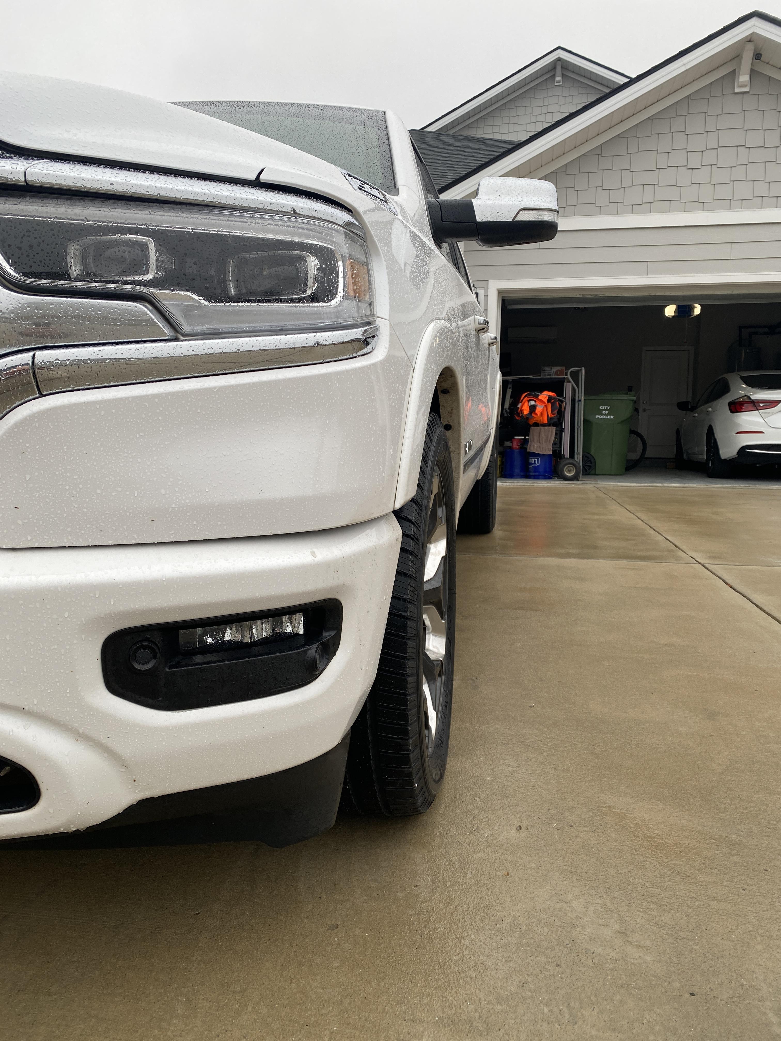

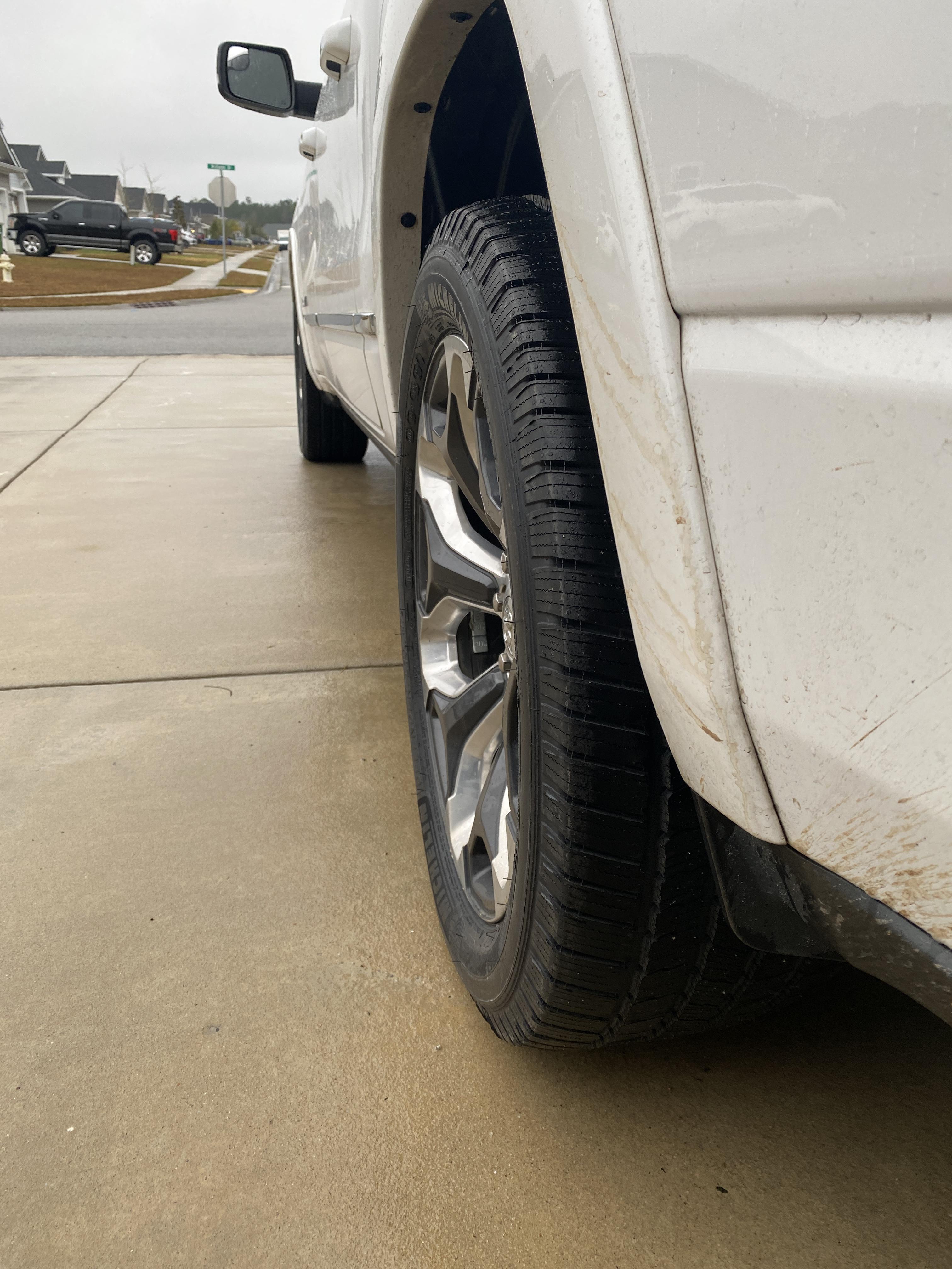

The tires came in early so I got them installed today.
These are the Michelin Defender LTX in 305/45/22’s.
The ride home was smooth and quiet and even my wife noticed a significant difference as a passenger. I slipped the tires once intentionally compared to 2-3 times that the old tires would have slipped unintentionally. There was some minimal rubbing at full turn, (in Aero mode), but once I was out of the tight parking lot, it never happened again. I'll look it into more once it stops raining.

Probably a stupid question, but why didn't you just get the defenders in the stock size determined by manufacturer to be best for the vehicle? I'm trying to decide if it's worth going slightly bigger for just the look...doesn't seem like there's any other benefit and I definitely don't want to worry about rub. What was the difference your wife noticed? Ride quality, noise, both?
I also switched to the 305/45-22 Michelins. I did it mainly for the looks. However, since there is more sidewall, I do think they ride a little better than stock size, especially on rough roads. There is minor rubbing, but only in reverse in full lock so far. No problem for me.

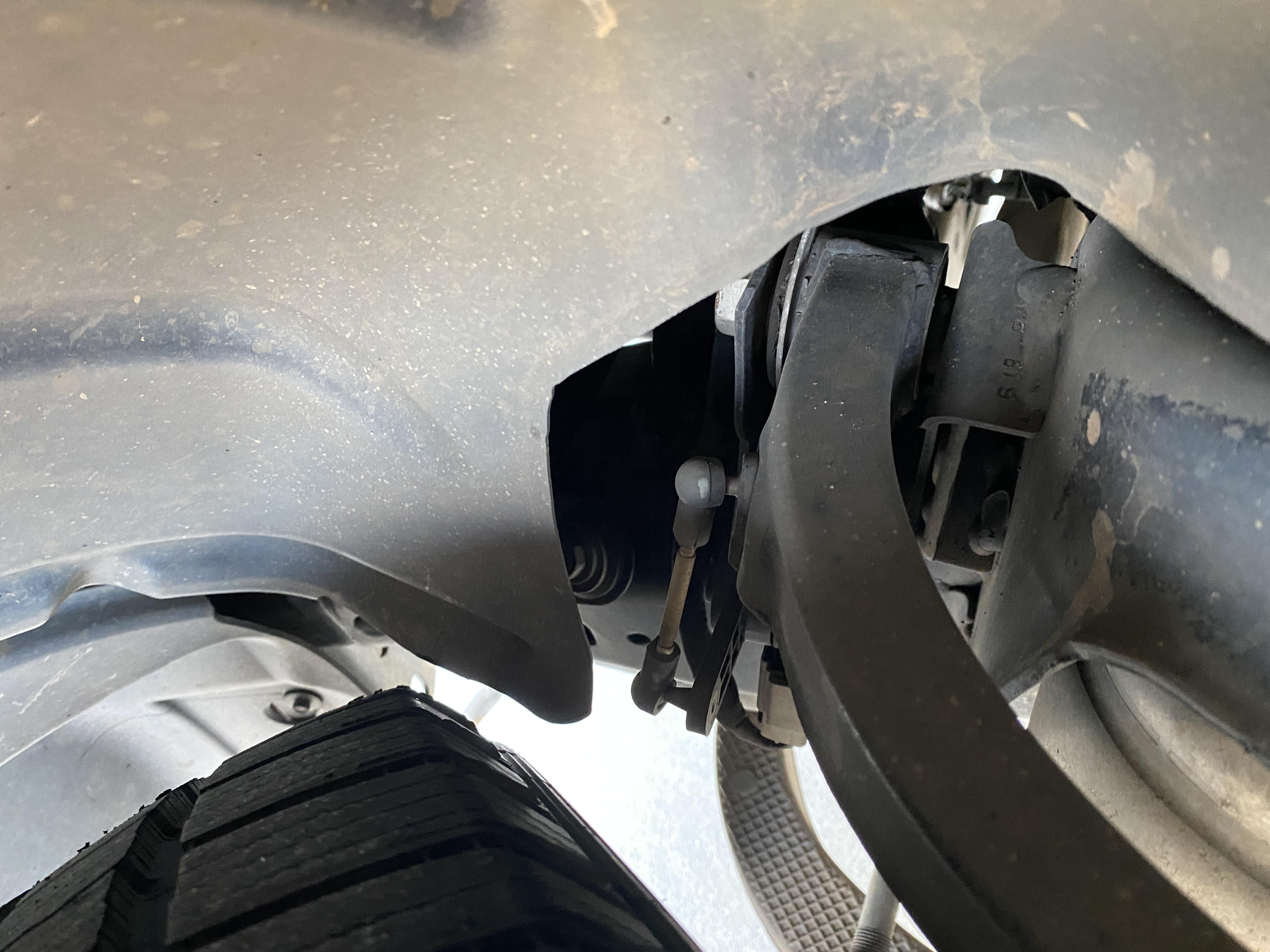

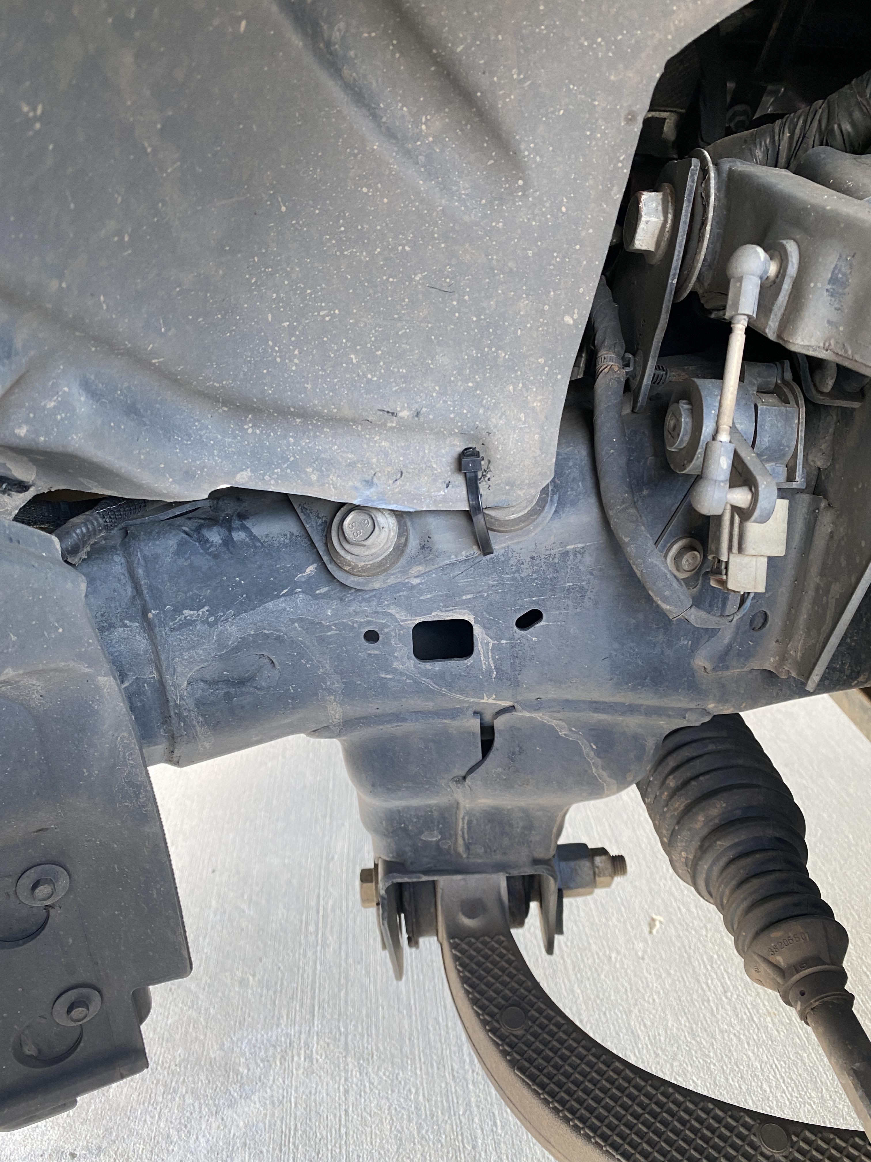

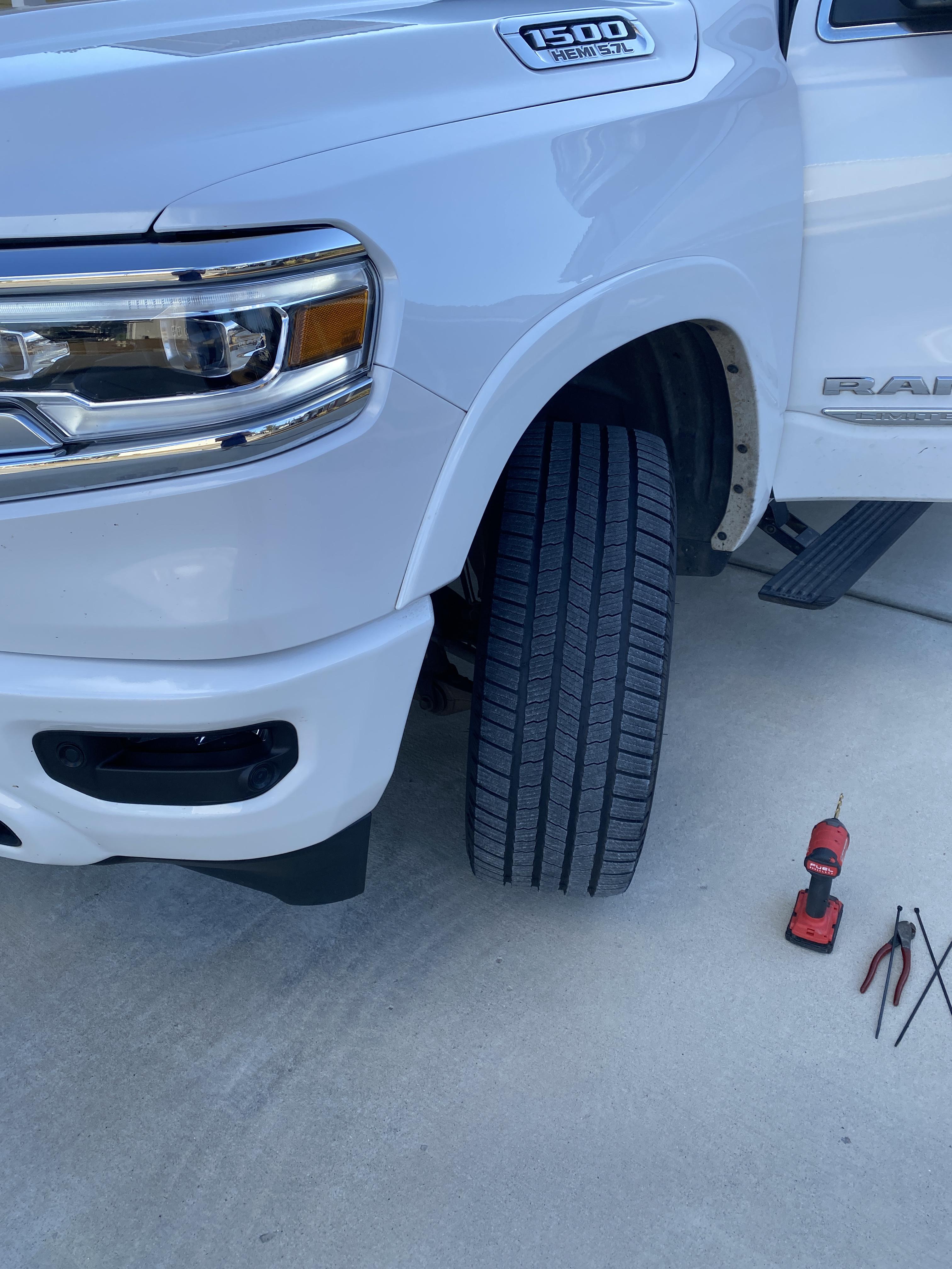

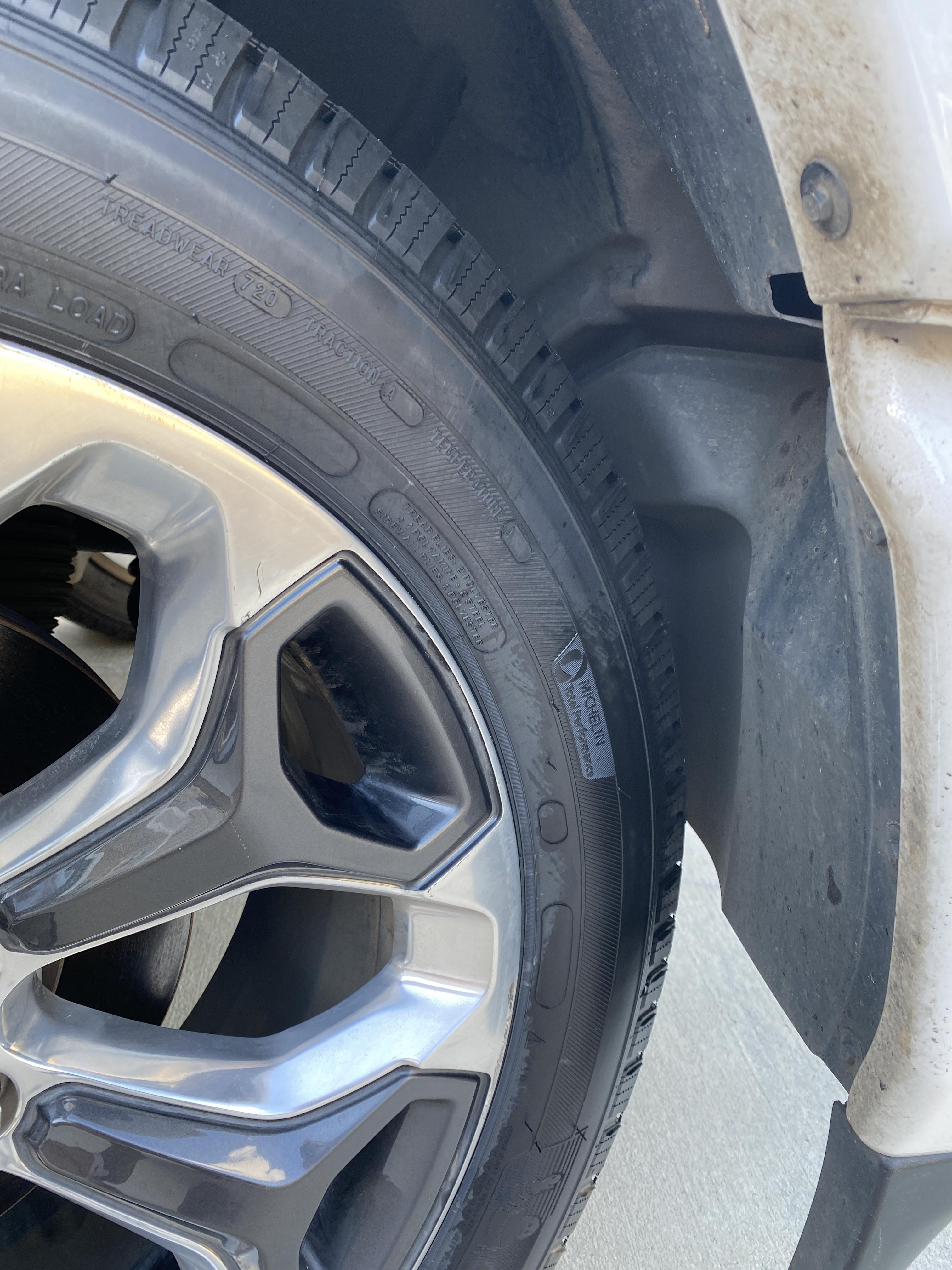

I had some minor rubbing when turning the wheel but as another member mentioned, it’s the inner wheel well liner and easy to resolve.
I drilled a single hole and used a zip tie to pull the plastic back on each side.

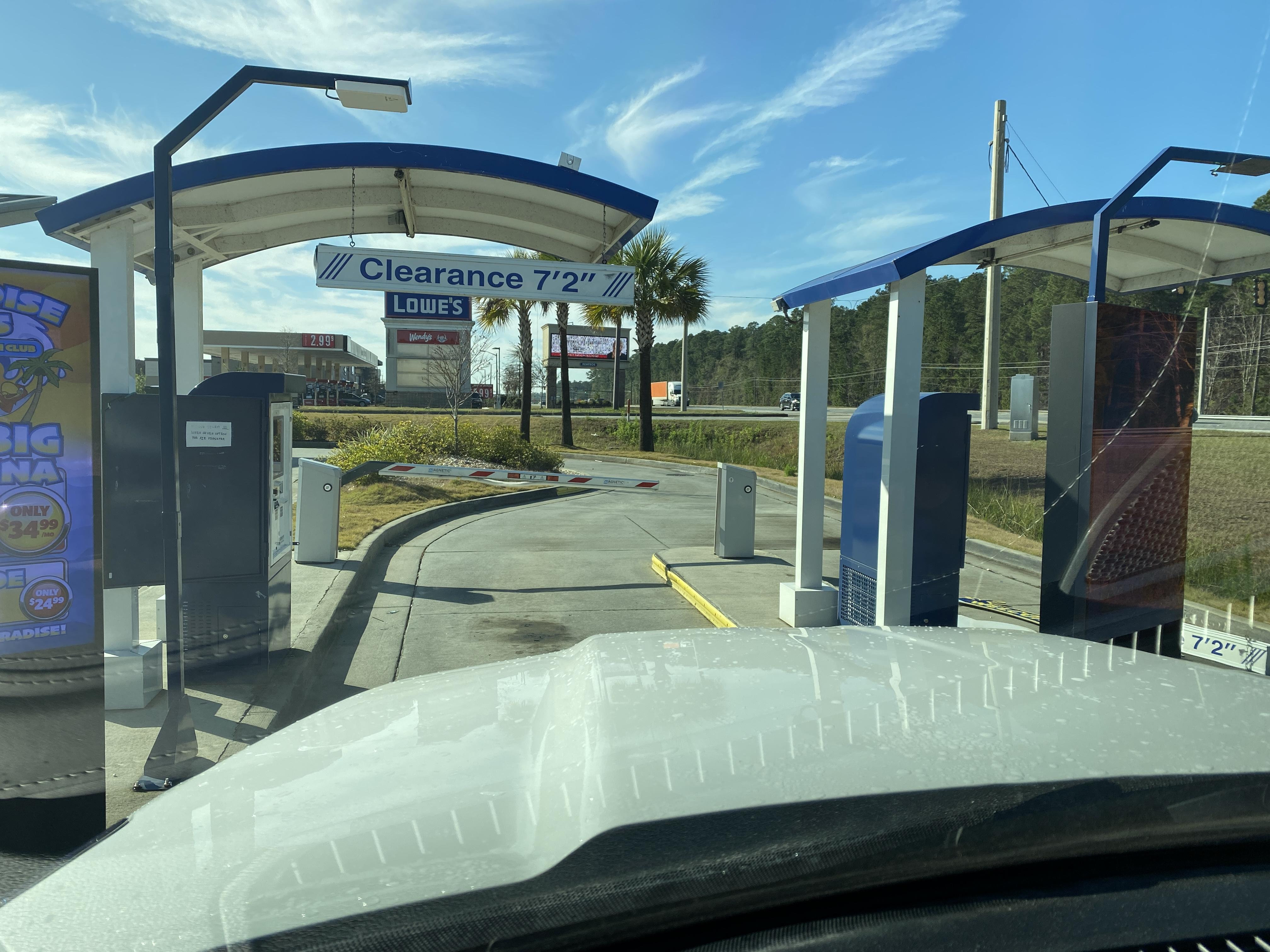

My local car wash is a perfect example of crap we can’t avoid. They have a straight lane that is closed off 90% of the time forcing everyone to navigate a tight S curve. I nail it about 80% of the time but those other 20% I either rub the front or the back.
That looks an offtly like Pooler ga

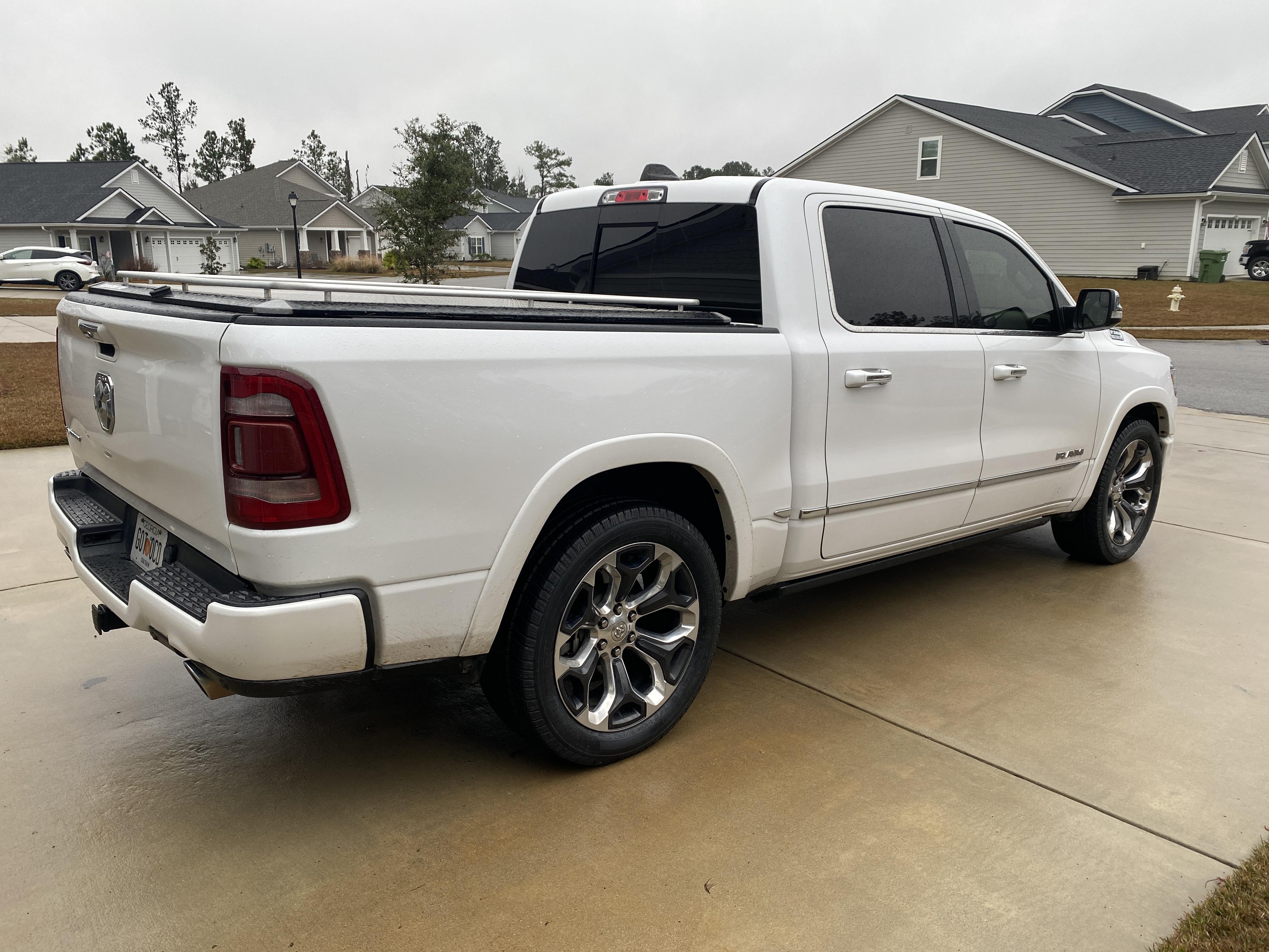

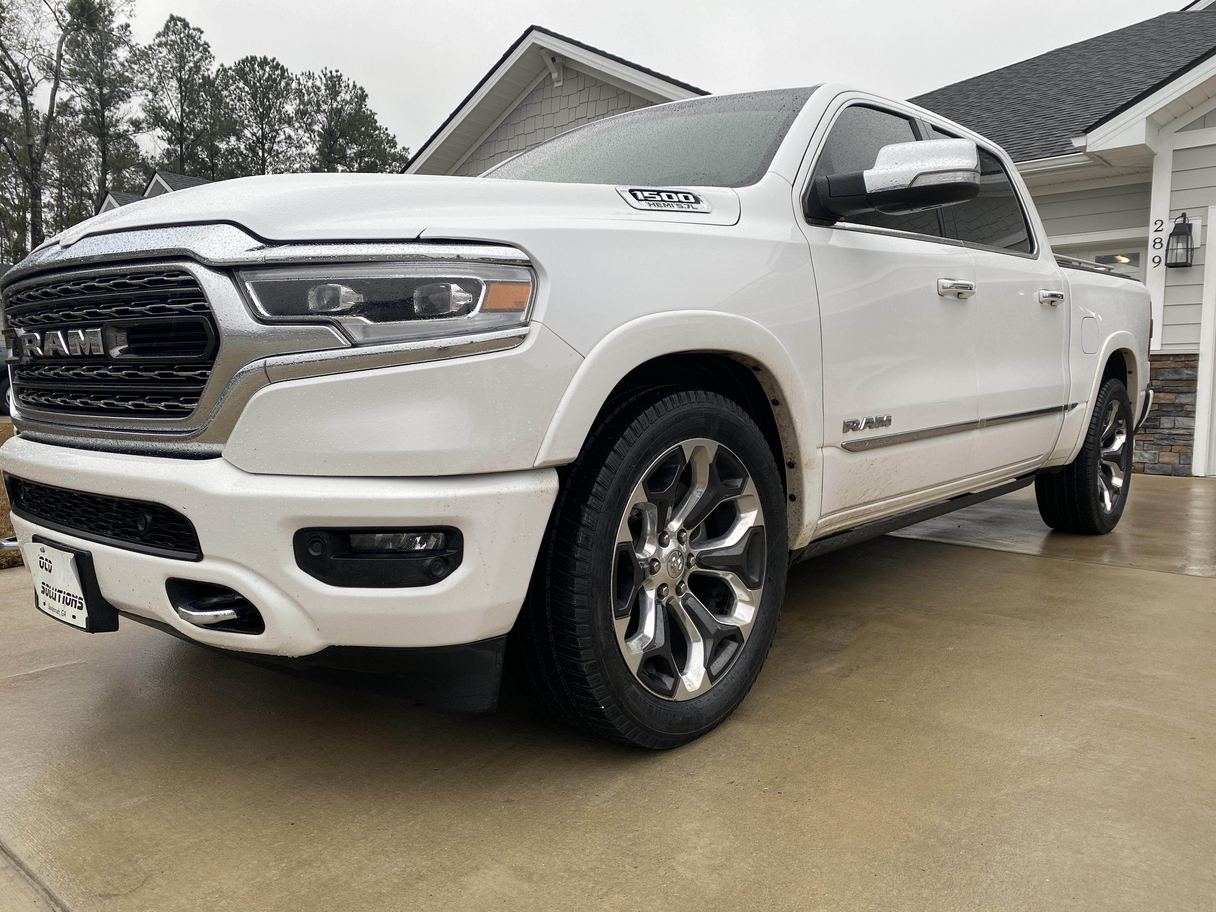

I put Toyo at3 305/45r22 on my Ram (Big Horn, found some Laramie rims selling locally). I don’t have any air suspension. No lifts or spacers. I get NO rub whatsoever. Discount tire had a pair in stock in California that they transferred to the store local to me.
Loving them already. Obviously a much more athletic feel over the stock junk tires. It feels much more planted and solid now. I wish I would have went with a taller sidewalk but overall I’m happy. Little to no road noise, only lost about 1 mpg. (Speedo isn’t calibrated however). After mounting these, I think my itch to get some spacers to make the wheels stick out a little more is relieved since these stick out a little more due to the width, I will probably grab some motofab pucks next week to level the rake out some however. 15B29CEA-BF6A-49F8-B9F8-9078A791DF9F.jpegD8B640F2-6C04-47FE-AAF1-2A87E811EF80.jpeg17A4848B-1FE3-4A44-BCF0-757102B3B65B.jpeg649DF1A0-B22F-4976-A605-559DB519A031.jpeg
Picture was taken in OR1. No lift, spacers or links installed - all factory original. I’ve been contemplating the BDS 4” which retains factory air settings, but so far very happy with the 305/45/22’s on factory ride height so may keep as is.
