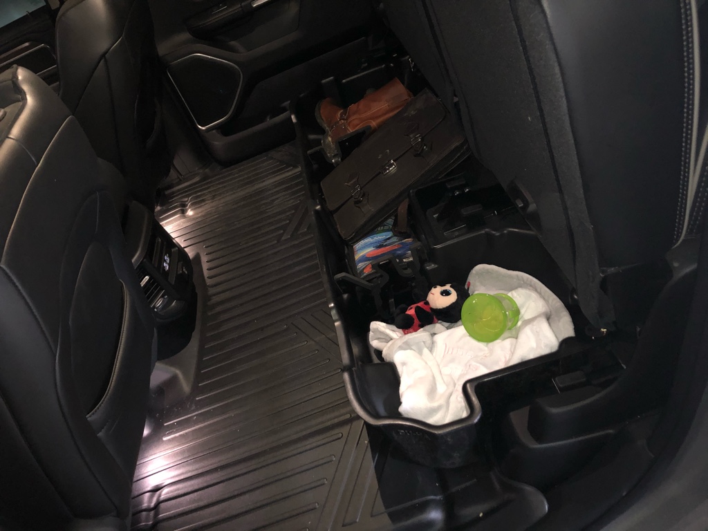

I got my 2019 Ram Laramie Quad Cab and I decided to get the WeatherTech under-seat storage bin. It’s not the biggest, but it does look great. It sits on top of Mopar rubber floor mats.
That’s why I ultimately went with the Du-ha. The double wall design of the Husky and Weathertech looks nicer but the Du-ha has a single wall, which gives you more storage volume.
