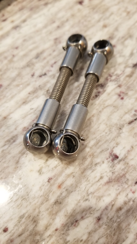

I don't think you can go wrong with either option. The links can be made for relatively cheap (pic is the ones I made). And the RC is also cheap.
I like those. Where did you source the ends? I'm not even sure what those are called.
