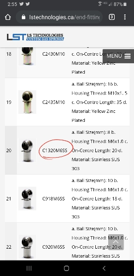

Ls Technologies of Canada.
$3.90 each. Stainless steel so they won't rust.
Part number in screenshot.
There is a lot of good info in that thread I linked. Definitely worth a read if you are going to do this mod. If you go with the links, you can adjust to your liking. I didn't see if the RC mounting plates were adjustable.
Just noticed my picture was kinda low quality. Part number is C13S20M6SS
