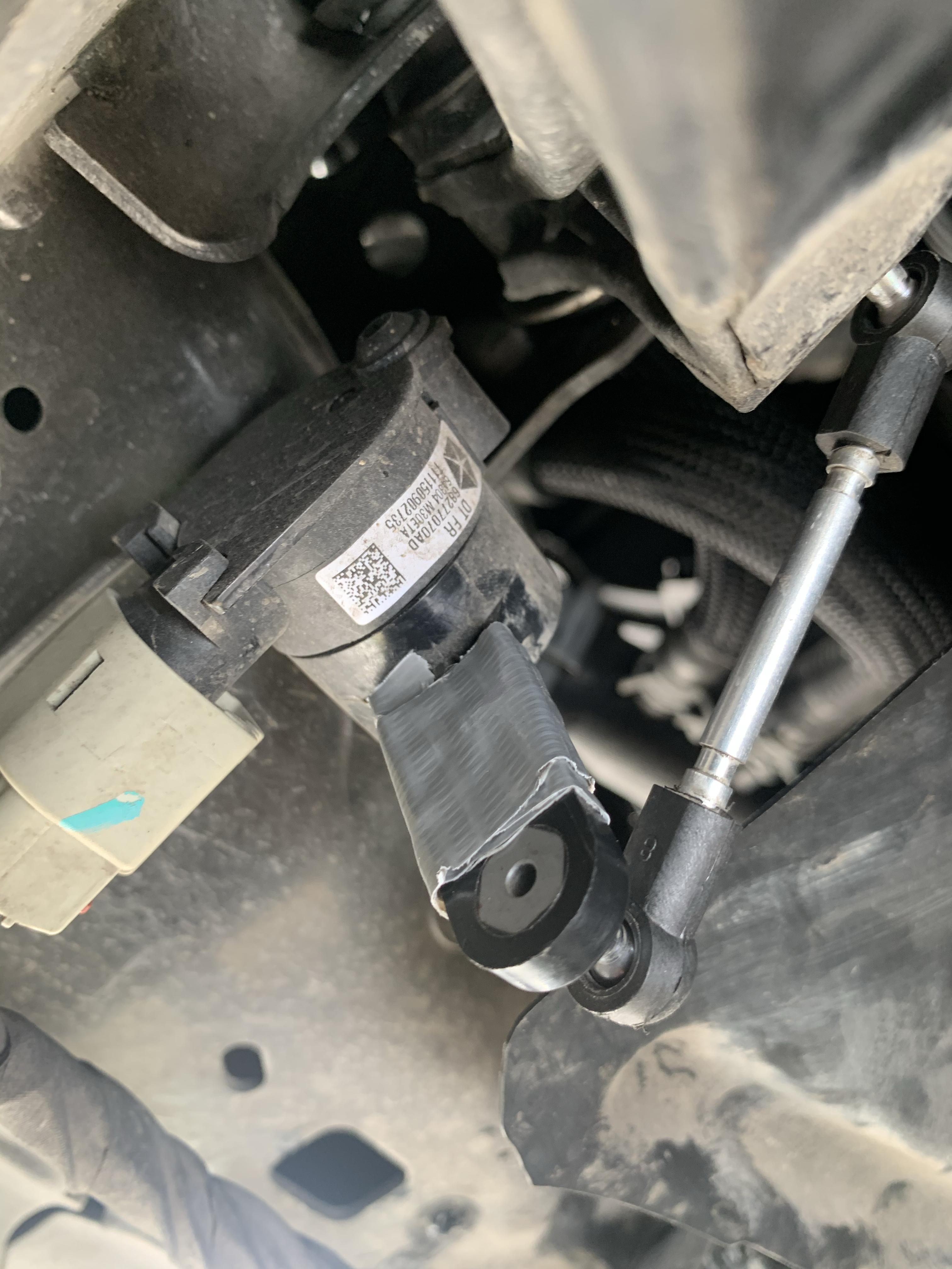

The system takes readings from each sensor (1 each on all 4 corners). This is how the system can adjust any corner it needs, not just the front vs the rear. The link/shaft is tied to the sensor on the frame at one end and the trailing/control arm at the other. As the suspension rises and lowers as you drive (or add weight) which causes the link/shaft to move up & down. This link/shaft drives the sensor (with built-in rheostat) and causes changes in resistance/voltage that the on-board computer interprets and does all the magic work to the air bag system to add or remove air. These numbers are looked at and can even be adjusted by your local technician to make the vehicle sit level - it does not always work, but it can help.
FACTORY :
Some aftermarket systems allow for those links to be replaced with longer/shorter, adjustable ones. You can cheat the system and make the vehicle raise or lower to reset the height. (This only allows minor adjustments to help you level out the vehicle) I've not played with those yet, so someone else would have to jump in on that. I would like to see the readings within the system, because I believe that the sensor only reads 0-5Volts. The air suspension system sends the inflator/deflator a % operation that resets the air bag pressure to a new normal ride height. (I have a non-Rebel rig, so I have 5 settings to choose from).
Yeah my tires broke mine, then used some duct tape to temporarily fix it till I jb welded it
Can you explain how it broke or when? The tire size? Which setting you were in? offroad 2 ? Aero?
