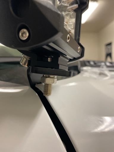

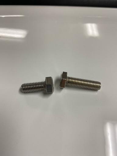

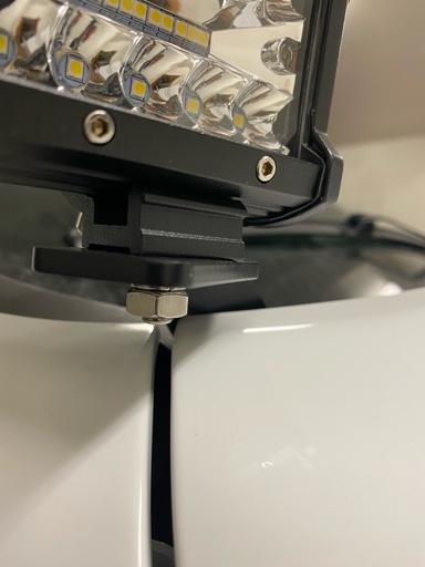

I replaced the bolts on the Niilight ditch lights I installed last weekend. The bolts were too close to the hood for me.
could you post a link to what brackets you went with please?
u da man mang this is on the short list i just needed to know some proven brackets.
