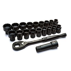

That's what the pass through sockets sets allow without having to modify anything
I don't have any but I did pick up a set for my father on his birthday. He's 10 hours away so I couldn't grab them. I should probably research a good set.
The set I have is from Harbor Freight. Nothing I use a lot, so don't need super higher quality
