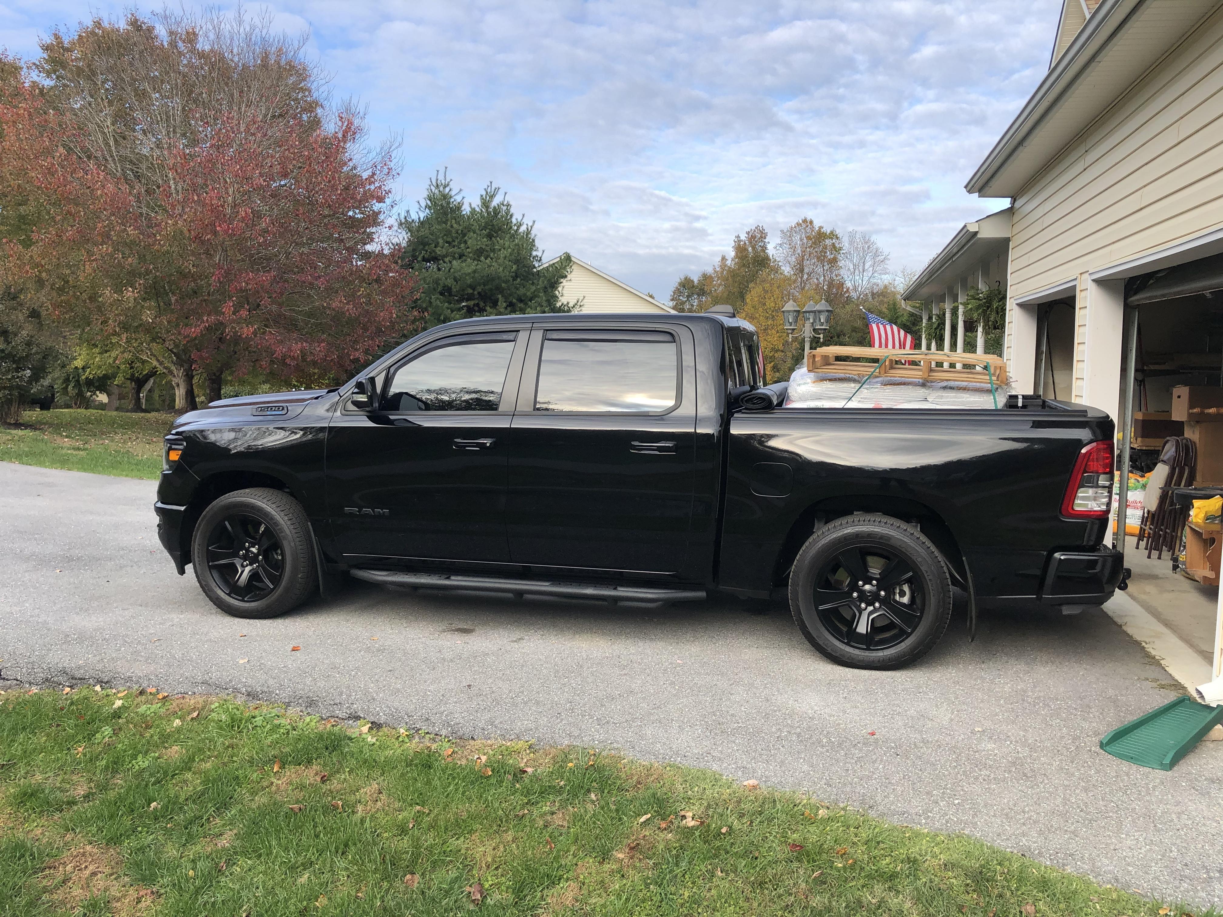

Helped the in-laws out and picked up pallets of wood pellets for them. Took half and went back for another. 1/2 tone makes her squat level.

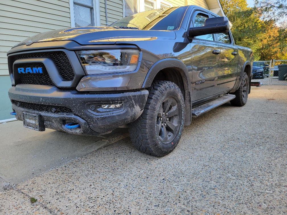

Dude, in a forum full of cool trucks…your truck stands out.Here is what I did to my ram today. Took her offroad for the first time.
P.s. don't know if you can see in the far right corner is my charger...hiding from the dirt...lol![]()

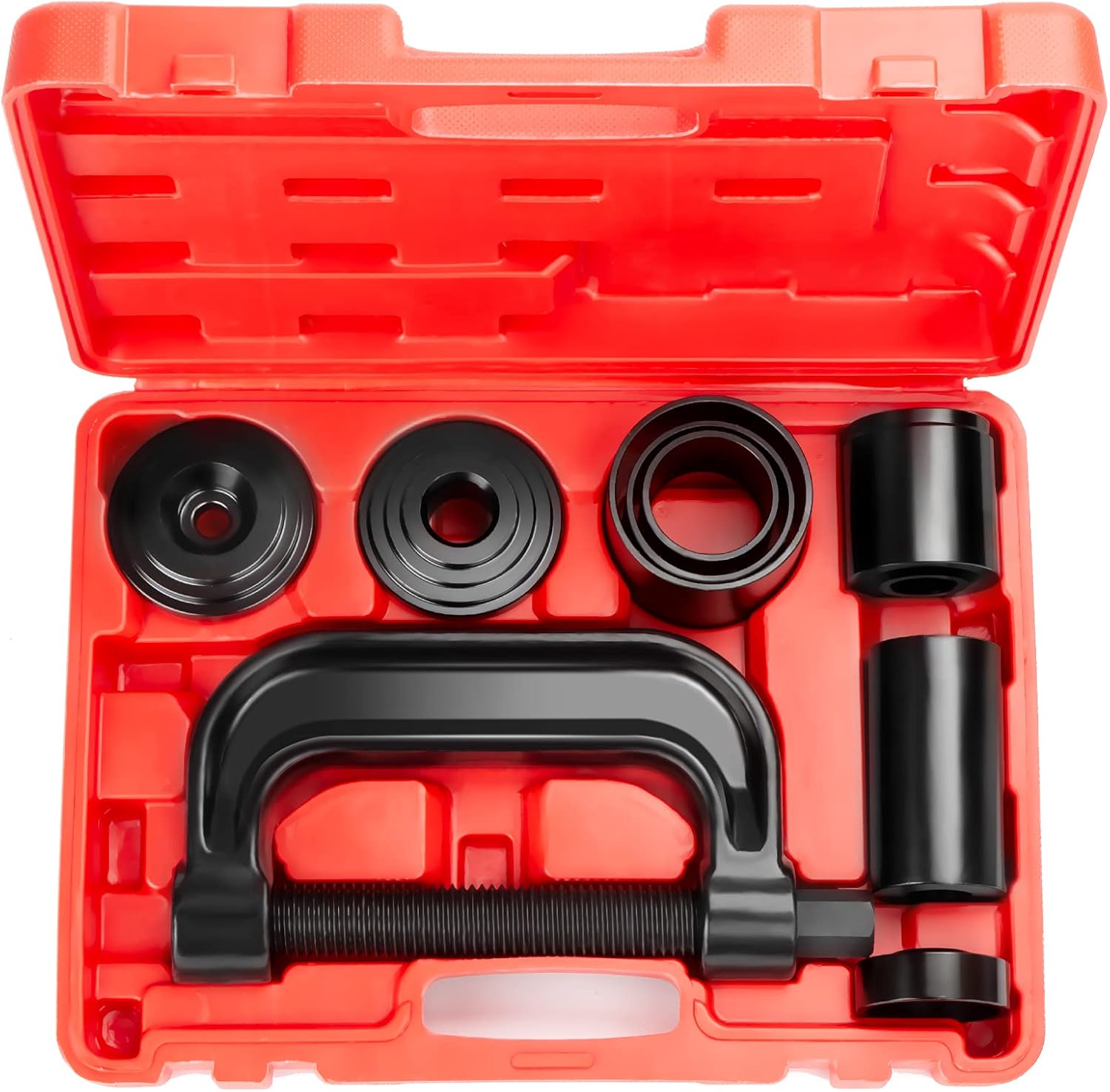

Don’t know if you’ve done it yet, but you could try leaving the suspension hanging, then putting a jack under the lower control arm and have it set so it’s just touching. Then hit that spindle with the hammer like it owes you money.So not sure if I post this here since it's not technically on yet, but trying to get new uca's on and I am having a huge hard time trying to get the, :Strike the ball joint boss with a dead blow
hammer to dislodge the taper part done. It's really in there good, I've been banging on it with 4lbs hammer on side and on the bolt and nut portion trying to pop it up, neither is working. I think next solution might be getting these u shaped prong things I saw someone using on YouTube unless anybody has and idea's.
Giving that another try this morning, will a little more umph this time. Was to afraid of busting it beforeMine would not come out with just using a hammer. I put a ratchet and socket on the hex part below the nut and applied twisting force when hitting with the hammer.
Mine only has 500 miles on it, lol. What also had me unsure was a one if the instructions for the bds uca's but same method of install except this:It all comes with experience. I have seen guys wailing on spindles with no luck, but the guys who’ve been doing it for a long time are a few hits and it’s off. It’s usually the rust buckets that cause the most issues, and I use a pneumatic hammer for those if I need to save the ball joint. A pickle fork is a last resort, at least for me.
