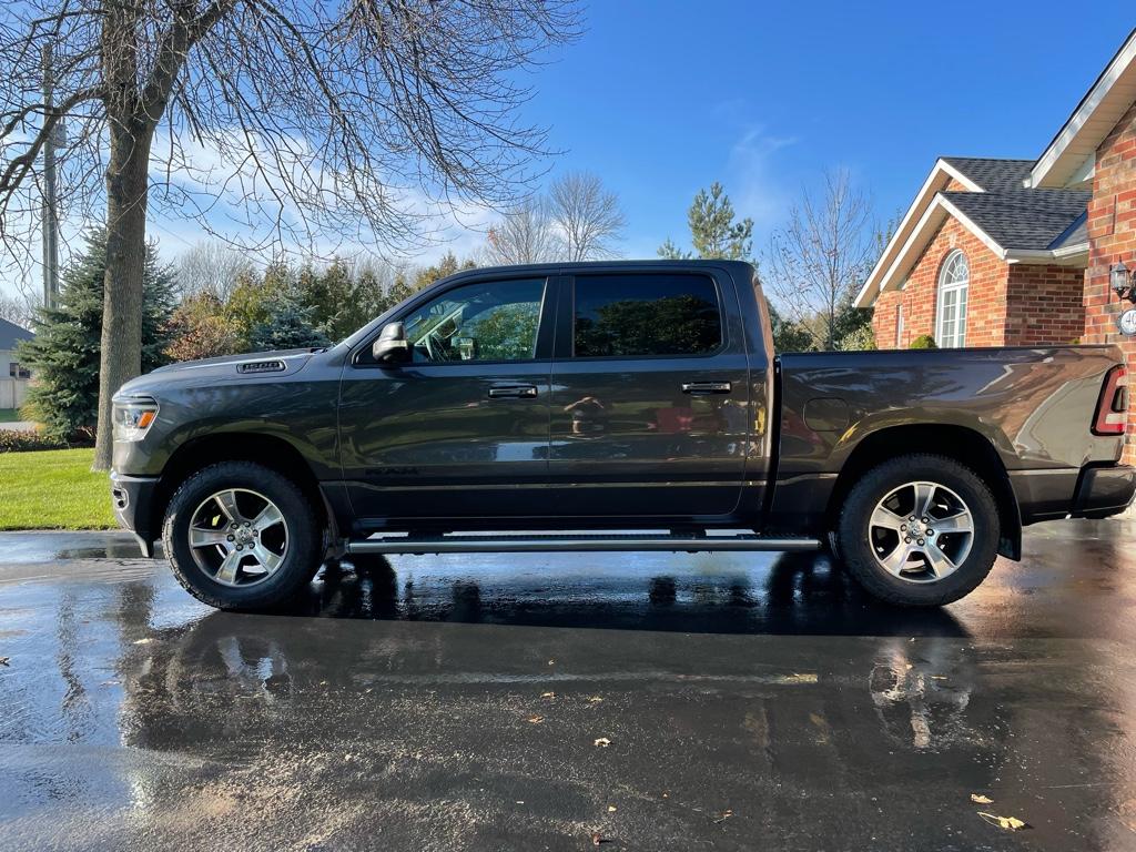

Finally washed my 2019 Sport with newly installed level and new rubber (Revo 3 lt285/65-20’on stock rims). Mileage may have taken a hit , but looks and seems to ride nicer than the stock 20” rubber
