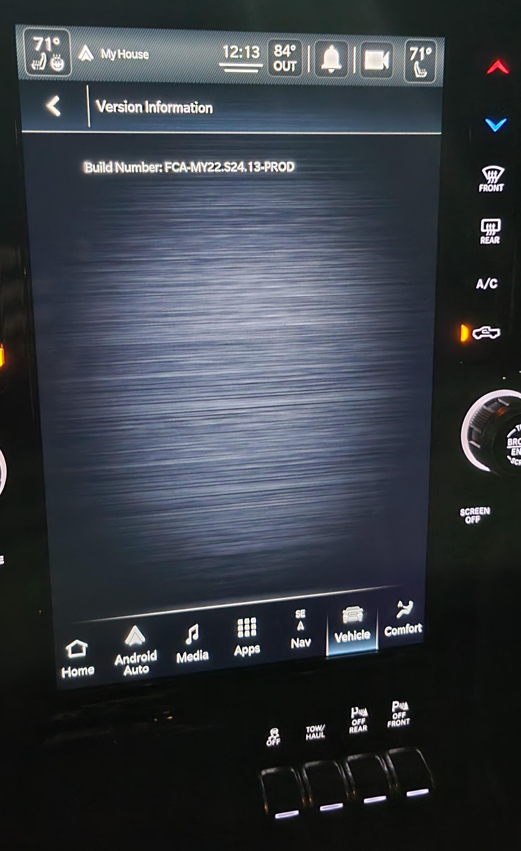

is this the correct screen to check for version? If not, where do I go? I have alot of the issues mentioned in this thread.

If you're not sure if you've received the latest software update, there are 2 ways to find your current Uconnect 5 software information:
  • VEHICLE option from App Drawer --> Settings --> System Information --> Version Information
OR
  • APP option from App Drawer --> Settings --> Version Information
