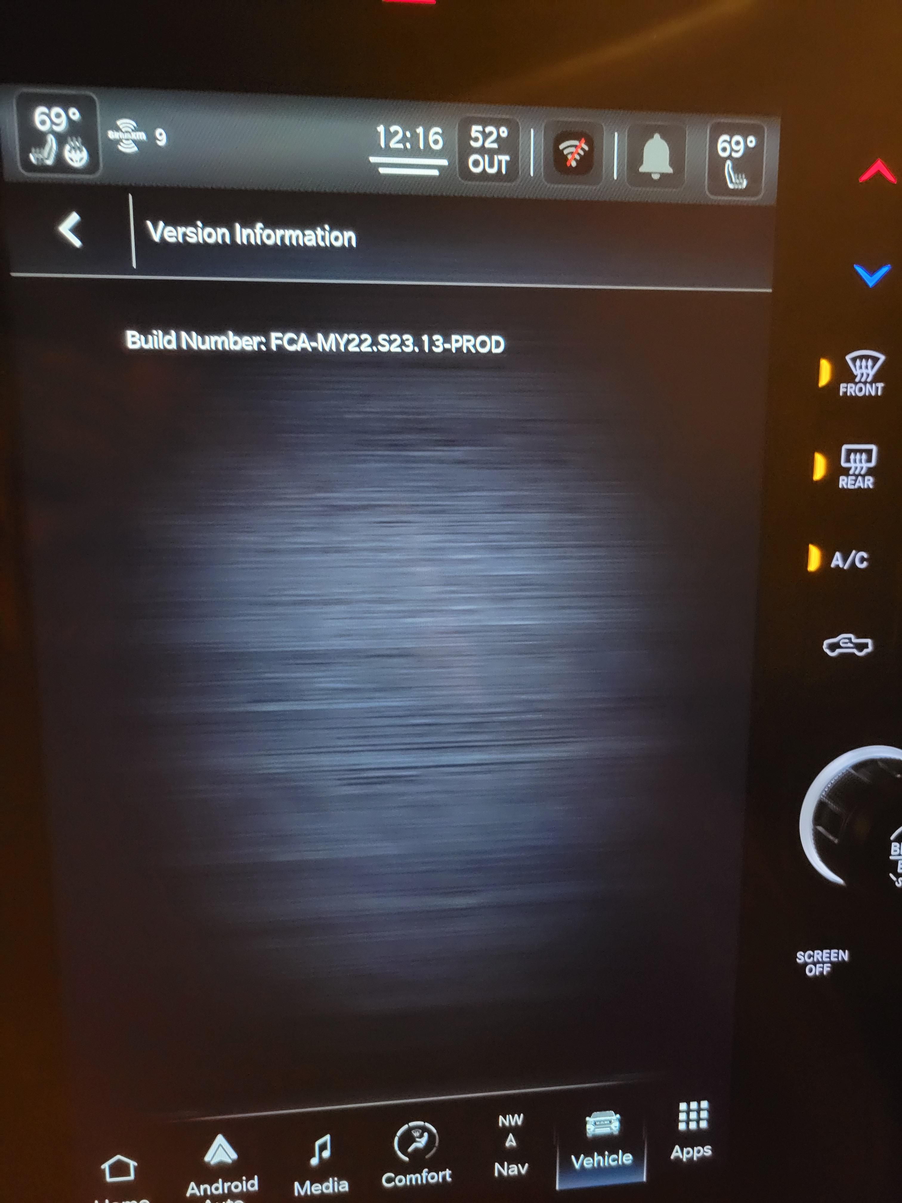

My 22 UAX 12" radio updated last night from previous versions above to...
FCA-MY22.S23.13-Prod
Any one have any info on it or a TSB for it?
(Hopefully the heated seat hot keys in the upper corners don't disappear regularly anymore and the the extra apps, weather, b etc work now)

so we went from S21-5d to S23 13... looks like a big update or where did S22 go
It went in the circular filing cabinet.
I’m on 13 also now. The only annoying thing about the update was that I got error code SXM_SDARS-INCORRECT_CONFIGURATION after updating, but it says I’m on 13 anyway.
Fingers crossed this update actually helps. I have discovered that wireless Carplay is causing most of my issues. It won’t connect or stay connected consistently and constantly freezes the radio up. If I turn it off my phone will connect with bluetooth no problem and there is rarely any crashes or glitches. Heated Seats and wheel kets still disappear though. Doing some reading wireless carplay uses both bluetooth and wifi to function and given how glitchy wireless hotspot is as well as connected services in general I believe the problems are related.
Can someone test this with Android Auto too...so we can rule out some things already.
