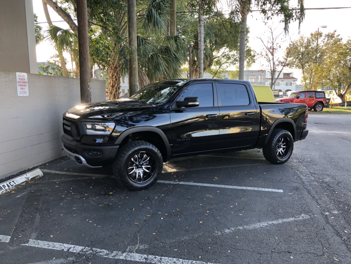

Update: I installed a 2” Motofab on mine yesterday, and it’s looking perfectly level (looks SO much better). I verified with my dealership whether or not you actually need/should also switch out the UCA’s, and they said “No”. “You don’t need to worry about the UCA’s, with only going with a 2” level”. “Anything higher, then yes you should switch them out”. But if I was gonna take it off-roading a lot, I would switch them out, just for piece of mine.
Next upgrade: 33’s
What do you guys think would look the best?.
Next upgrade: 33’s

33 will fit stock suspension. A 34'ish will look and fill the opening better.
