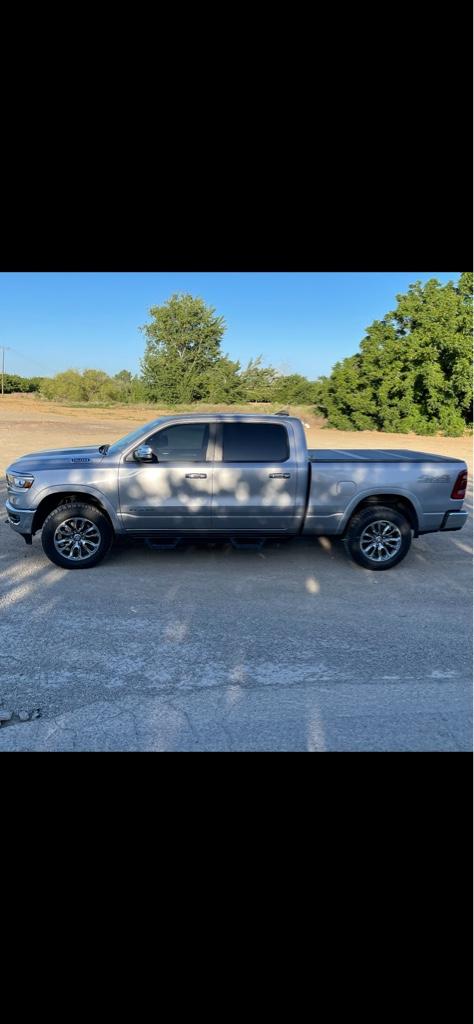

Bilsteins and mopar ucas bilsteins set to #5 line. 2” level. Sits perfectly. Rides great. Need to get it aligned tomorrow but tracks well so far. My mechanic said he didn’t see a difference between the stock orp ucas and the mopar 2” lift ucas. I told him there is. Either way looks even better in person. As someone else on the forums said this is how it should have come from the factory.
That looks good! What size tires? Looks like the toyo AT3 but could be wrong.
2019 With ORP and Readylift 2” kit with UCA’s and 285/65/20 Falken Wildpeaks on factory wheels. No rubbing and it sits 1/2” high in the rear. Again just like it should be offered from the factory.

I'm not sure why the ORP thing is so confusing to me! I have a 19 Laramie without the ORP. If I see that you leveled your truck 2", does that mean I need to lift mine 3" to achieve the same fender height?
That is correct. Orp adds 1” to the truck from factory. If you do the mopar or whatever 2” lift all around you are still 1” shorter than the orp.
2019 Ram 1500 ORP “long bed” - setting #5 bilsteins, 2”mopar ucas, hellwig sway bar, tonneau cover, bed mat, 20” Laramie sport wheels on 285/60r20 falkens. Flowmaster outlaw.
