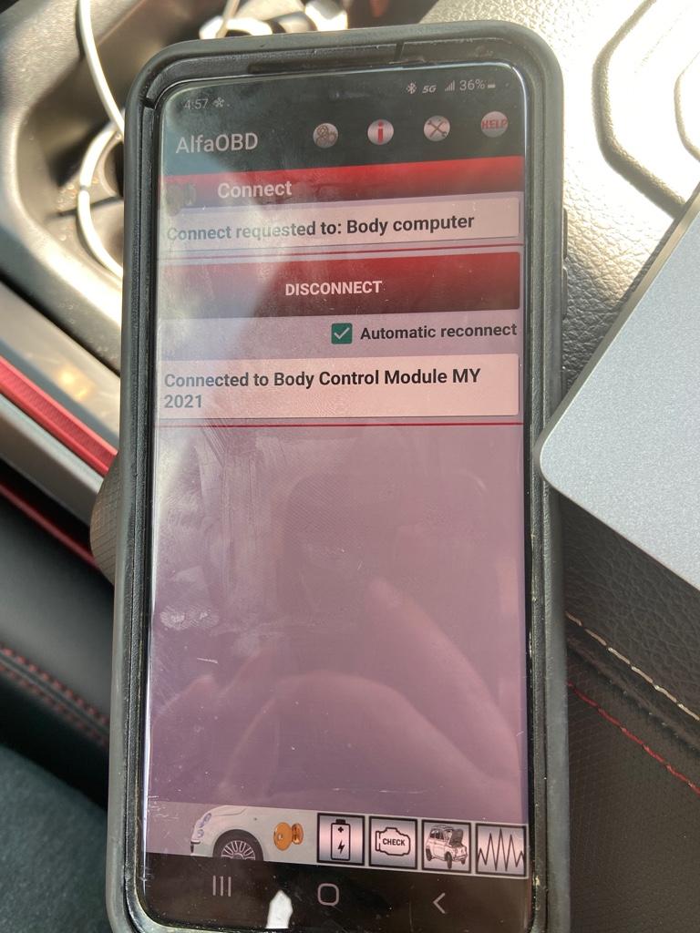

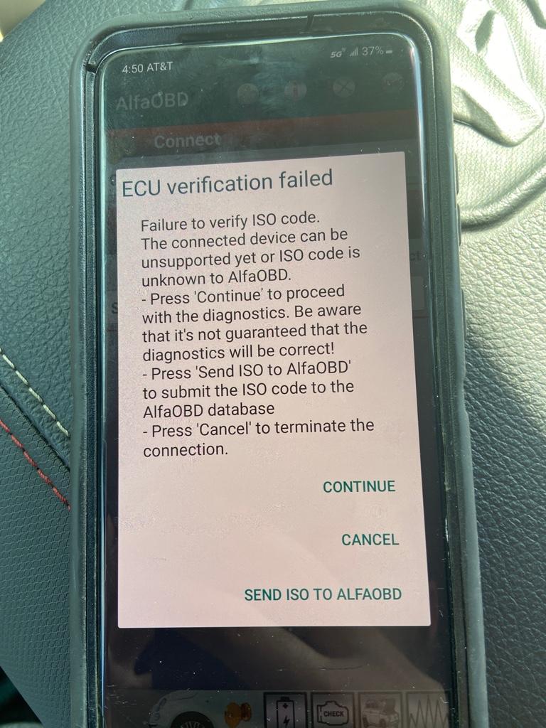

So I am using android version alfaobd.. do I have to put my truck in Acc or run? I keep getting this error when I try to connect to the BCM
Ignition off, acc, or run- it doesn’t matter. Just click continue.
I tried that. Still the same message
Where would I go from here?
The normal steps- car with hood open > car configuration change > find the settings that you need to change.
