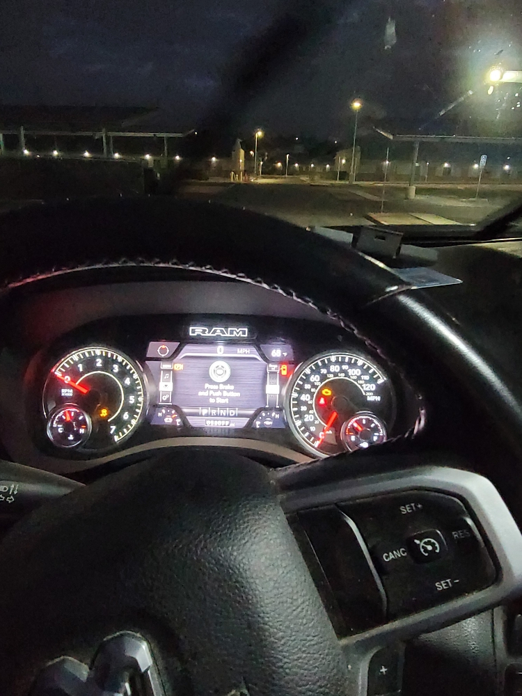

Good day everyone, I just repined the 8 pin connector. Like the photos on here. As soon as I did that my truck went crazy
Windshield wipers won't stop
Turn signals won't work
Compass is gone
Check in light on
A couple other light are one
I went from uconnect 4 8.4 too uconnect 4 12.1.
Any ideas

Double check your re-pin and make sure the pins are seated all the way. This should not interfere with any of your issues.

I've seen this happen when power is applied to the CANBUS and/or a short is introduced.
