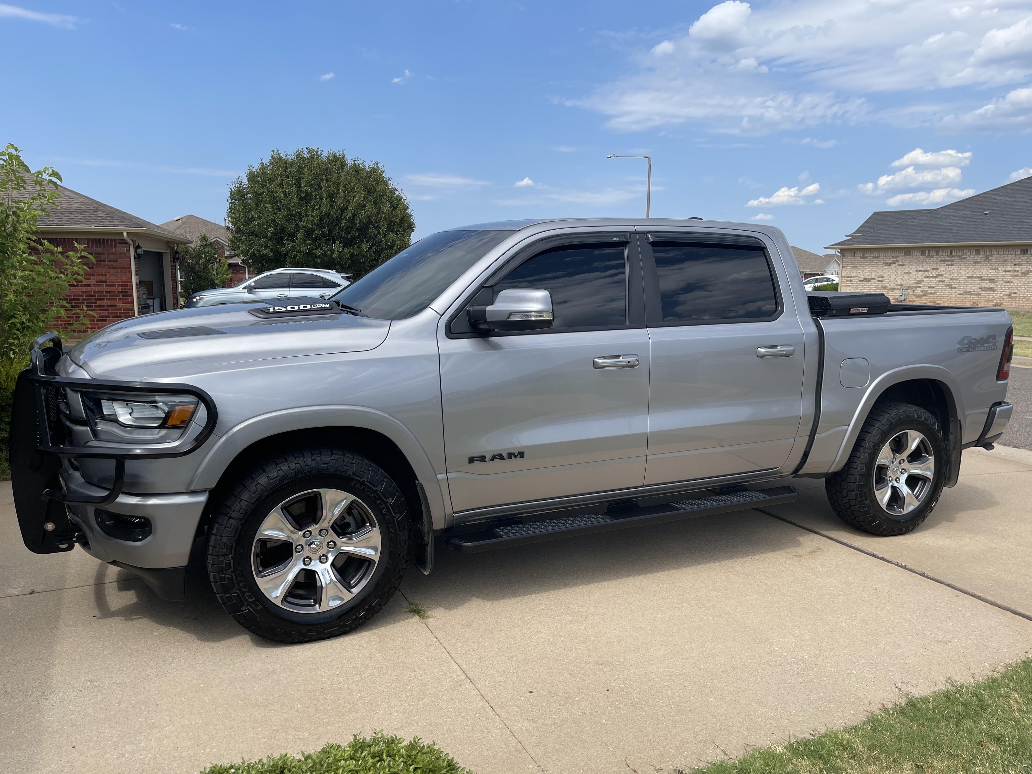

Finally mounted my @BRINK WHEELS. The ride is amazing. Love the Mastercraft MXT tires. Wasn’t sure how that was gonna turn out. I love the look. Everything has turned out perfect. Won a set of brinkwheels I wanted to buy. Zero offset has the perfect amount of poke. Finally mounted them. Zero rub. I believe my tires are 34.69inches per internet. Recalibrated my speedo. And dialed it in on the first try. Now to get some professional photos done. Here are some iPhone pics. I don’t have the fancy cameras but 🤤🤤🤤🤤🤤
Looks great man!
