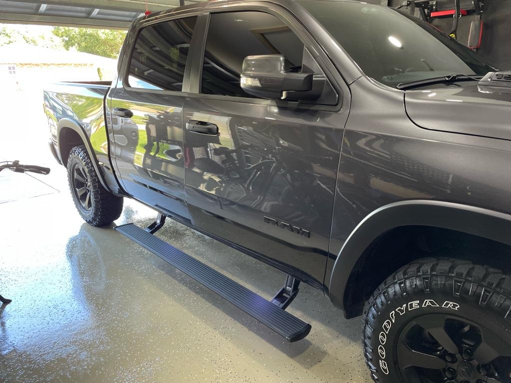

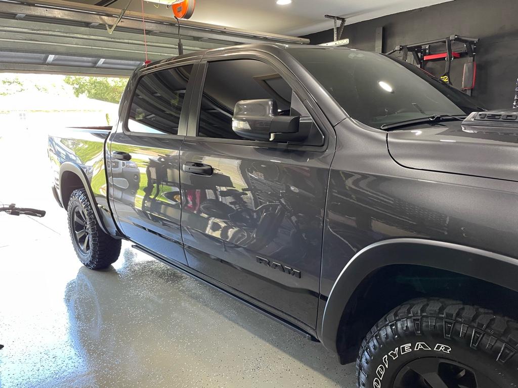

Installed my amp power steps. Way easier than when I installed them on my gladiator. Thanks to Alex @Realtruck for hooking me up. These things are impossible to find anywhere.
