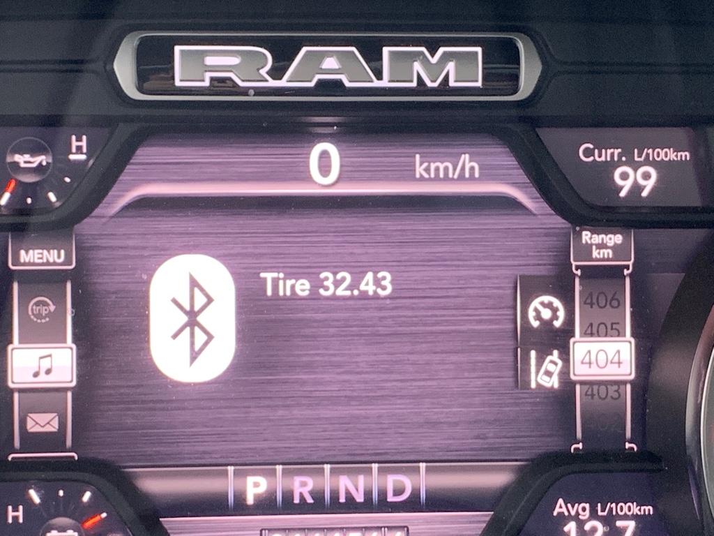

Can someone let me know what the stock tire size with stock 22” rims reads on the DT Tazer. I forgot to take a picture of it before I messed around.
