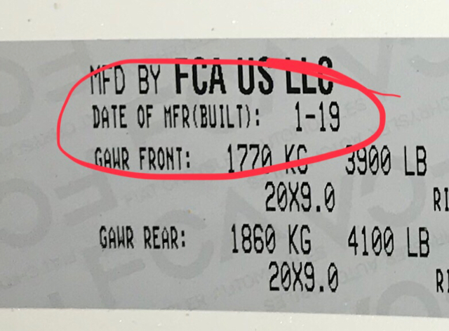

Just for clarification, the date of mfr (build) is month and year?
Any way to determine the build date (day of the month)?
Other end of that same sticker gives an “MDH” number which is likely month day hour, though I’ve heard those numbers don’t always match the MM-YY number perfectly... not sure why.
My Build date of 1-19 has MDH: 012910 473AA. ???
Just for clarification, the date of mfr (build) is month and year? JHill says ......you can actually see the month/day/hour (military time) off of door sticker. I added mine for reference as mine built July 8 at 8pm on right side of label that says mdh : 070820IMG_2726.jpg

Yep, what JHill said... think of that number as MMDDHH -> 012910 = Jan 29th 10:00am
That seems to makes sense except it doesn’t jive with the label’s 1-19 build date...a 10-day difference.
It jives, 19 refers to the year over on that side of the sticker. (y)
