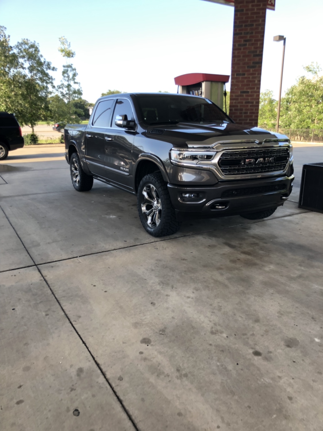

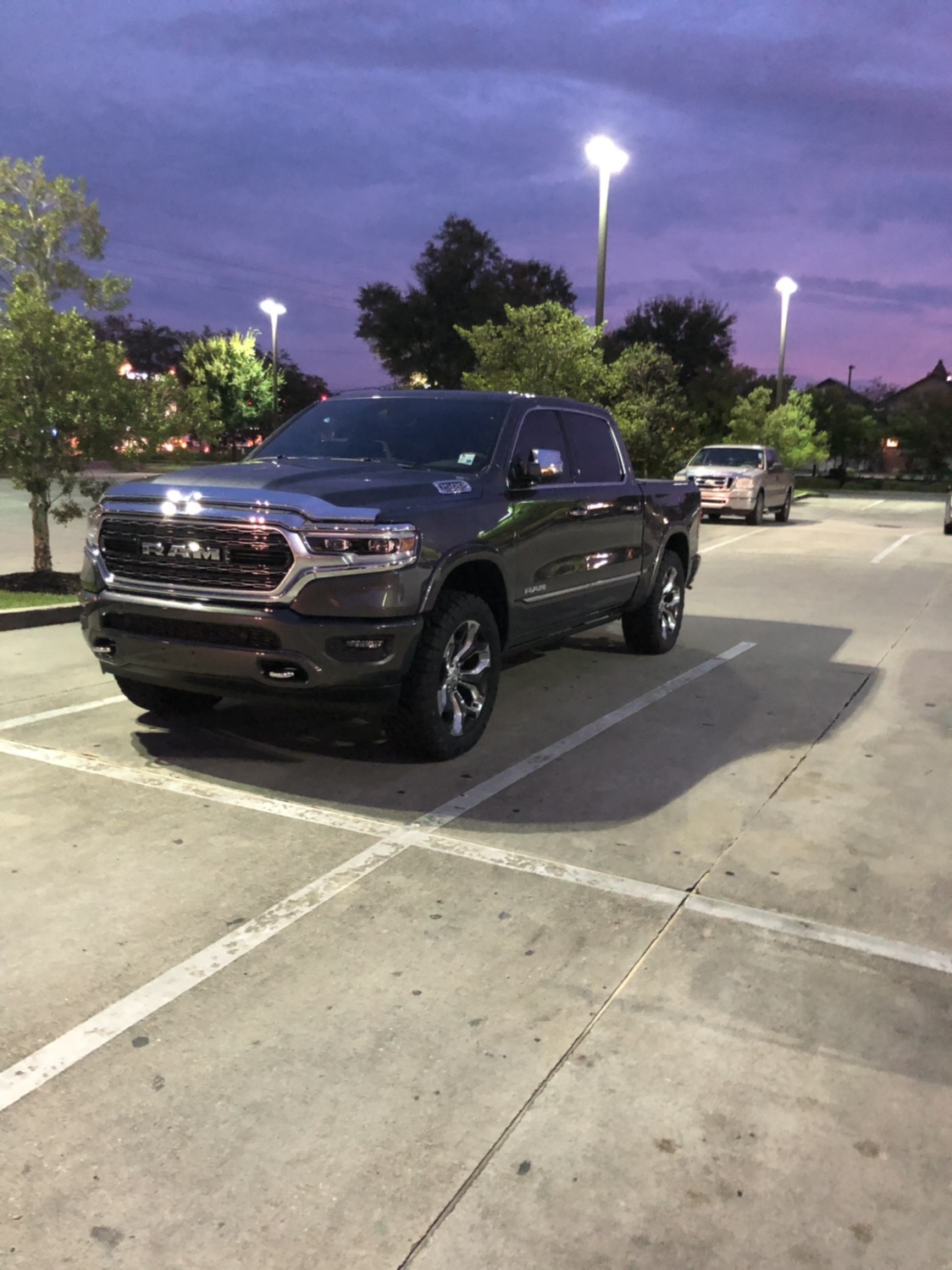

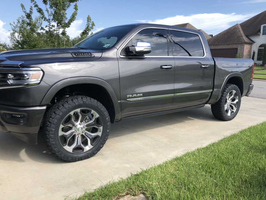

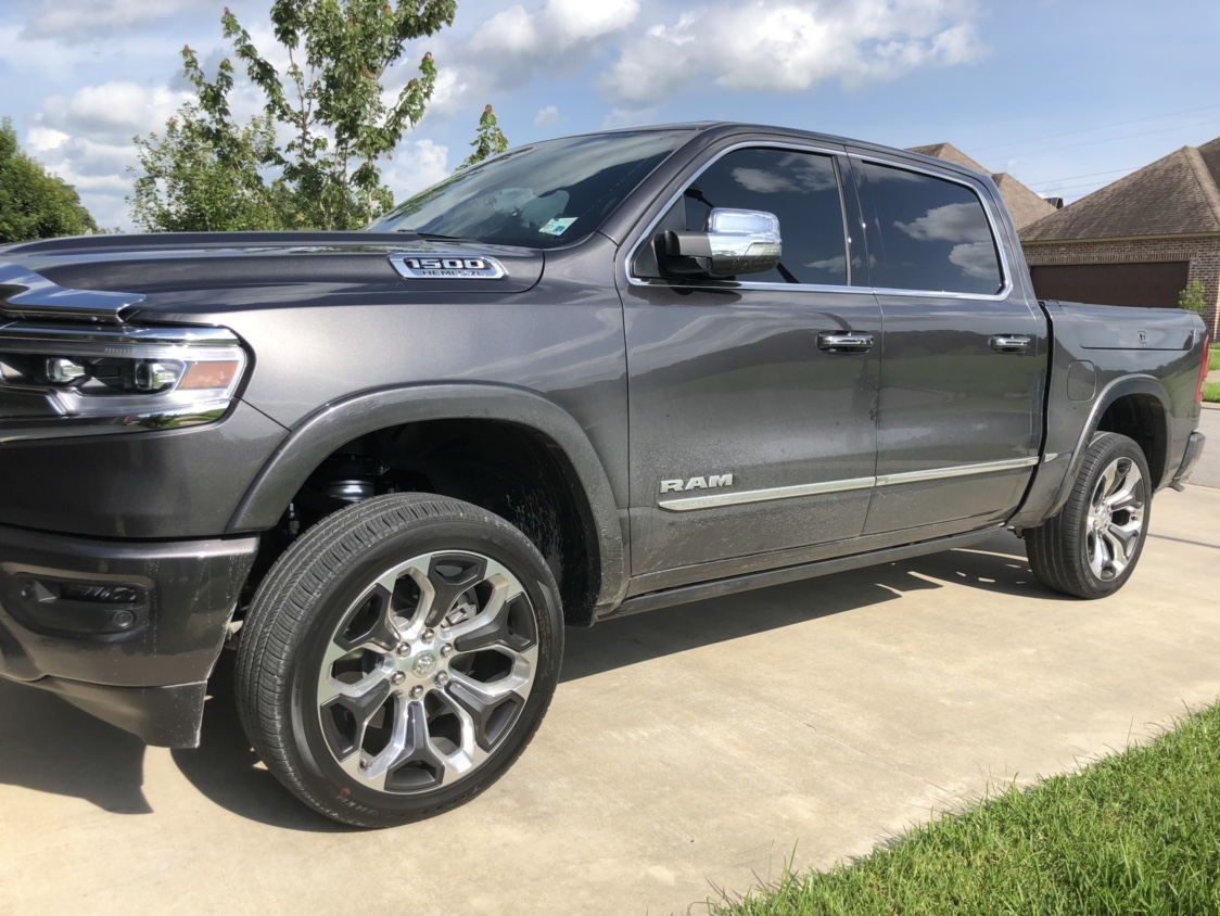

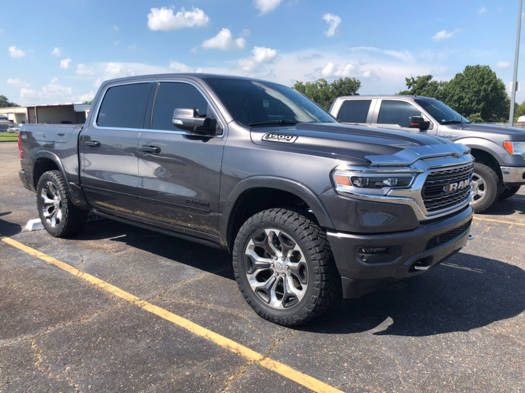

What ride mode is your truck in in these photos? Thx
Normal height, leveled, factory tires
Aero on the ridge grapplers
Normal on the RGs
Normal on the RGs
What size tires did you go with ? they dont look any bigger.
Has anybody just done the rear links to level out their Ram?
Thank you for the extra photos and lift modes. Much appreciated.
