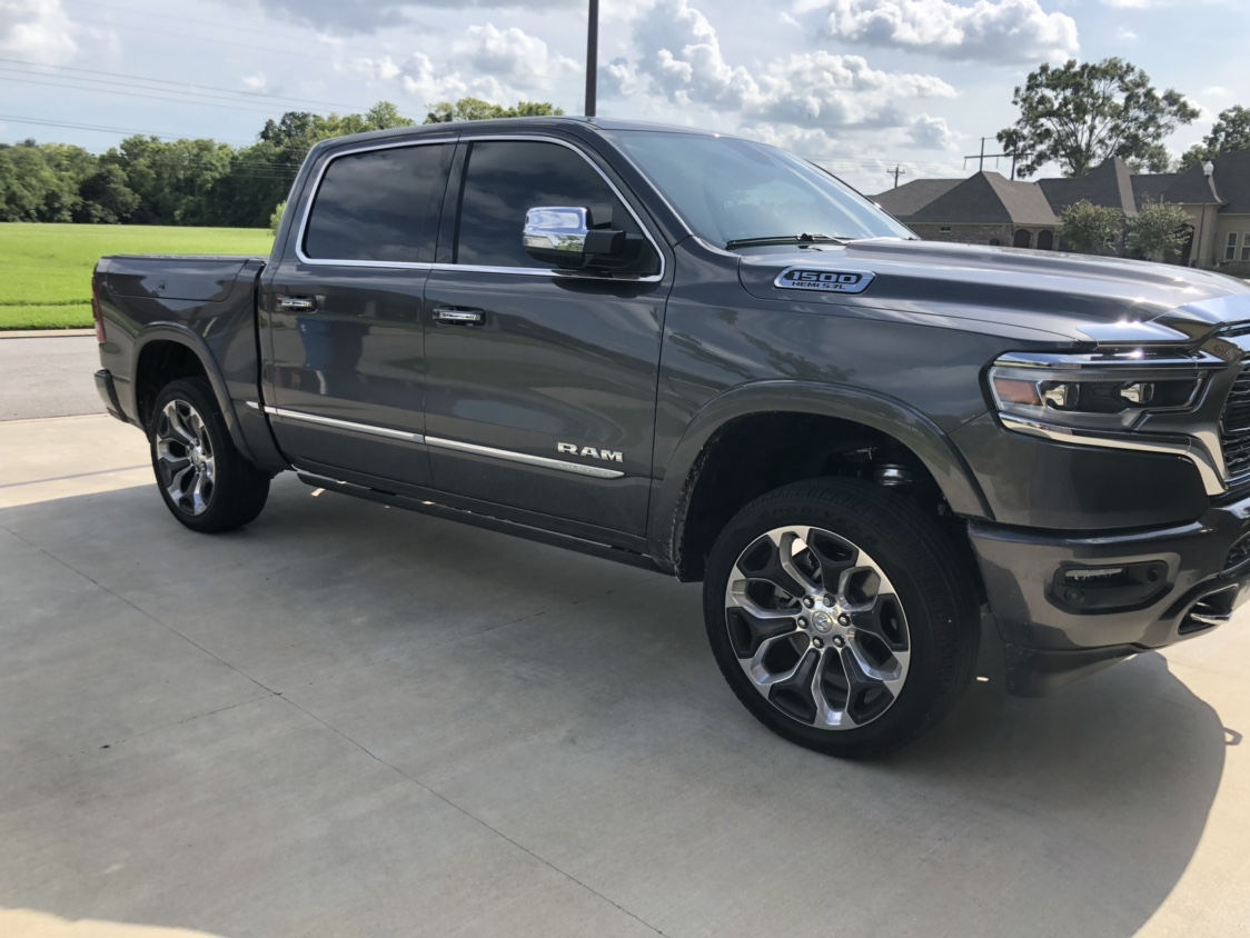

Just installed the links and I'm very happy with the outcome. I raised the front and lowered the rear. Went through all 5 settings and no error codes. I'm happy with the ride in Normal but I have the Daystar spacers and will eventually install them as well. Overall I'm very satified.

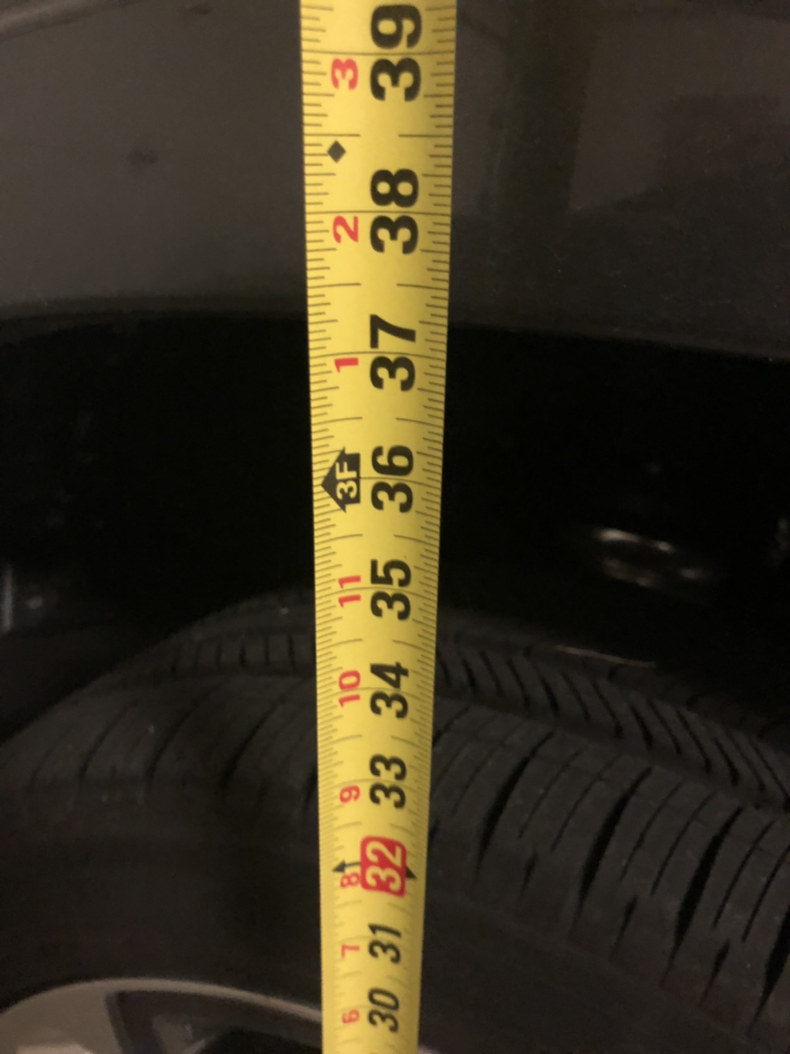

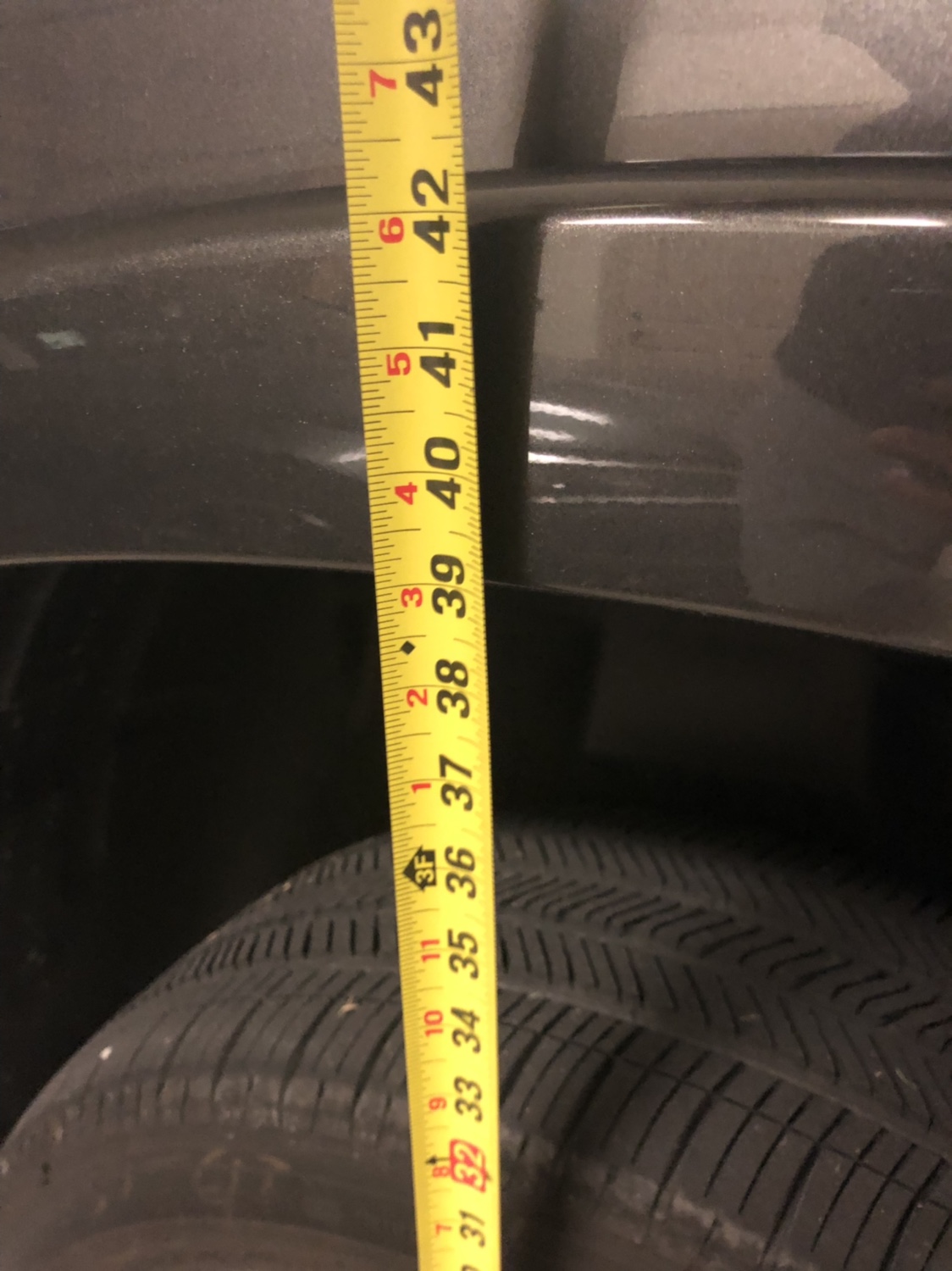

Pre-op front and rear, normal ride height, stock 22s.. about 37.25 and 39

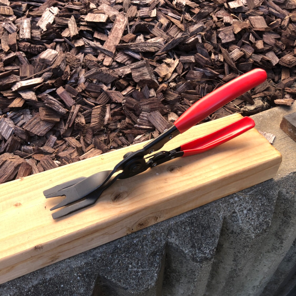

Btw, I know most people have been using a large screwdriver to pop off the links but if you have a tool like this, it makes things super easy and you’re less likely to break something.

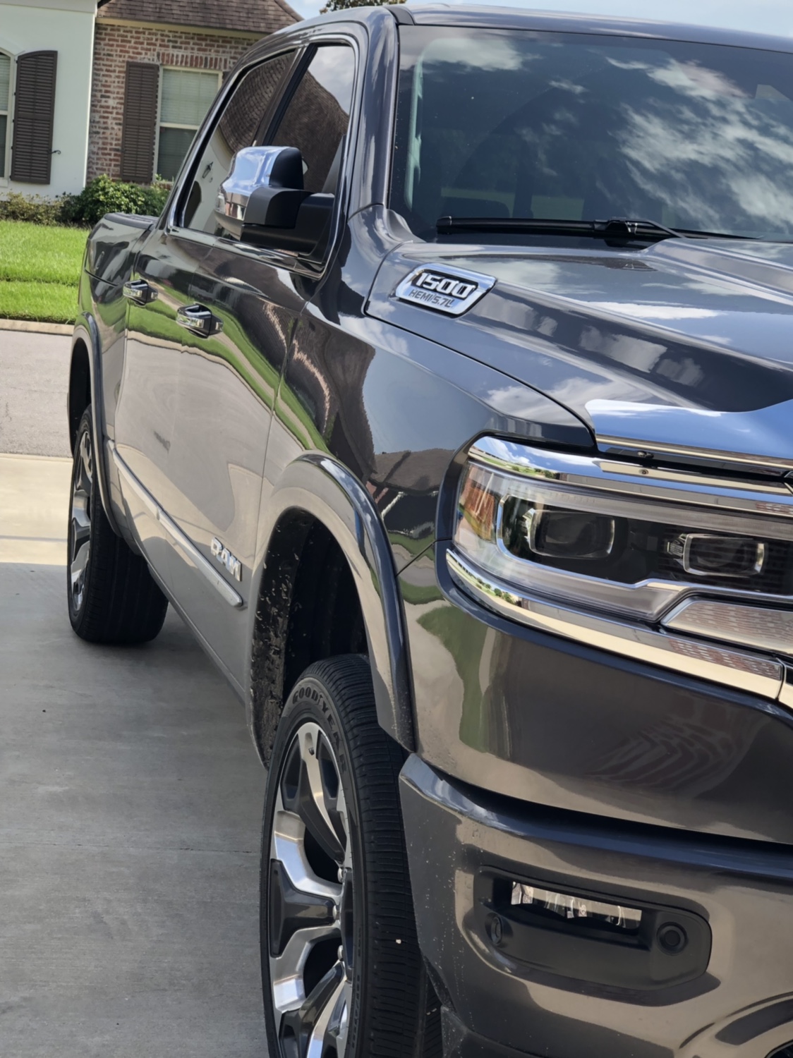

I had an idea of how much to shorten them based on the discussions here and they shipped close to it so I popped them on as is and it worked out great. I might raise the rear a touch but I'm pretty happy where she sits right now. Here's a better pic than the last one.
