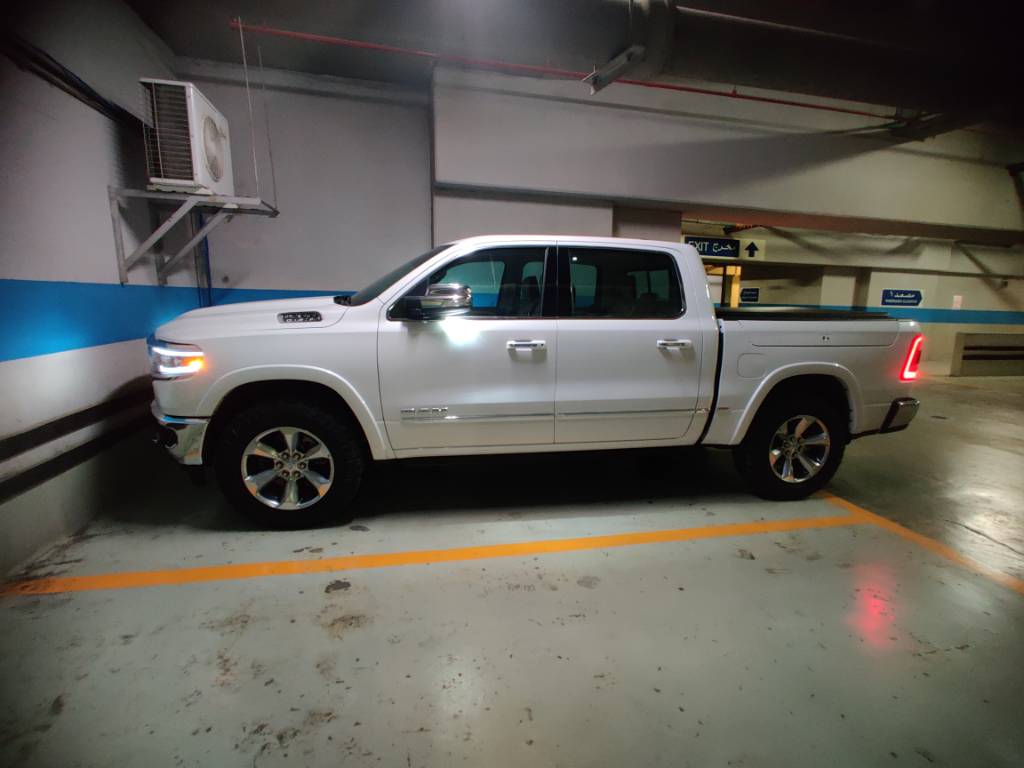

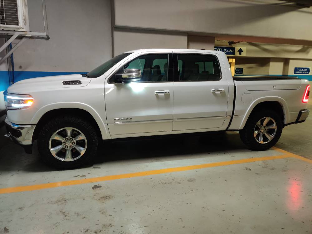

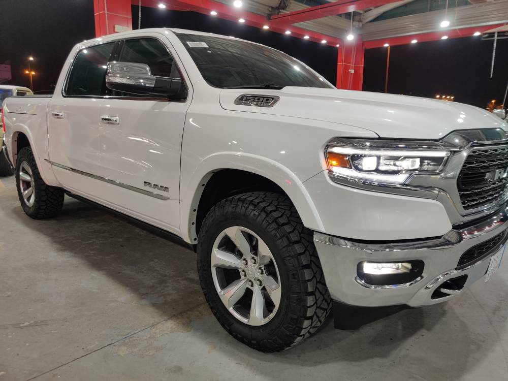

I only have the front links installed and measured them both at 2 1/4" eye to eye on the link. I'm perfectly level rear to front and side to side. I also have the day star spacer so maybe it's easier for the truck to level side to side since it doesn't have to fill up the airbags as much as it would without the spacers. Do you have spacers ?
Daystar leveling kit up front. 1 1/2" lift plus the revel links adjustment for the extra 1/2" to get the 2" rake.
ridge grappler 285x60x22, corrected 285x55x22 sorry.

Looks great, who did your daystar leveling kit? Did they seem to know what to do since we have an air ride suspension? Any issues with the install?
Did it myself at home, straight forward install. Factory front rake is 2". Kit is 1 1/2" the extra 1/2" comes from the link adjustment. What took the longest was the constant adjustment of the front links to get that 2" rake leveled to rear.
You disconnected the air line to install?
yes, I read some where the lines can be disconnected up to 3 times before they have to be evacuated at the dealer.

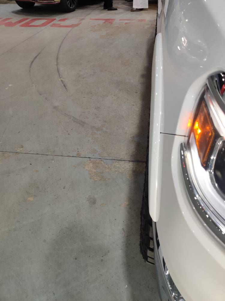

Do you have 22 or 20" wheels? 285/60/22 does not seem to be a tire size. 285/60/20 or 285/55/22? Not trying to bash...just educating myself before I take this project on next year. Truck looks amazing and glad to hear we can remove all rake...I don't tow and if needed a simple adjustment to the links should make towing a bit easier if I end up with something to haul behind my family hauler/commuter. Are you able to use all height adjustments still? Any rubbing with your setup in entry/exit? Trimming?
yes nitto makes 285/55/22, which is 34.6" tall. no rubbing but is very close. if I was to do it again. I would opt to a 285/50/22. all 5 height adjustments work. I also added mud flaps which do rub and had to trim. so yes no rubbing it you stay away from 55 sidewall and stick with 50 or less.
yes nitto makes 285/60/22, which is 34.8" tall. no rubbing but is very close. if I was to do it again. I would opt to a 285/55/22. all 5 height adjustments work. I also added mud flaps which do rub and had to trim. so yes no rubbing it you stay away from 60 sidewall and stick with 55 or less.
in 22 inch they make a 285/45,50,and 55 no 285/60r22 that would be nearly 36 inches tall .
