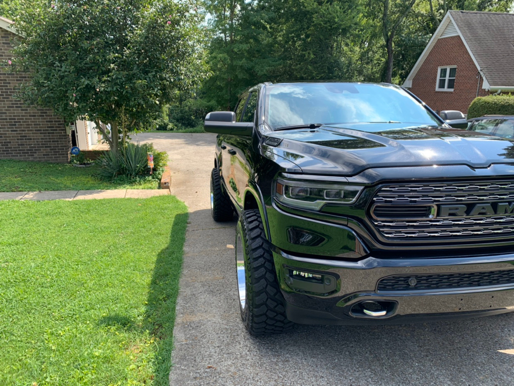

Thanks Guys...always makes me nervous tearing into a brand new truck and you never know what exactly the final outcome will be till you're done, but pleased w the outcome!
If I can be of any further assistance, don't hesitate to reach out.
Is your truck pictures taken with air in normal or lowered entry exit mode?
Picture is in normal mode. Factory front links are 71mm center to center. It says 5mm shorter links will raise it 3/4 to 1". I went 8mm shorter with my setting. So I still have a slight rake but like the stance. I could go more, but I think I'm going to leave it exactly where it is at.

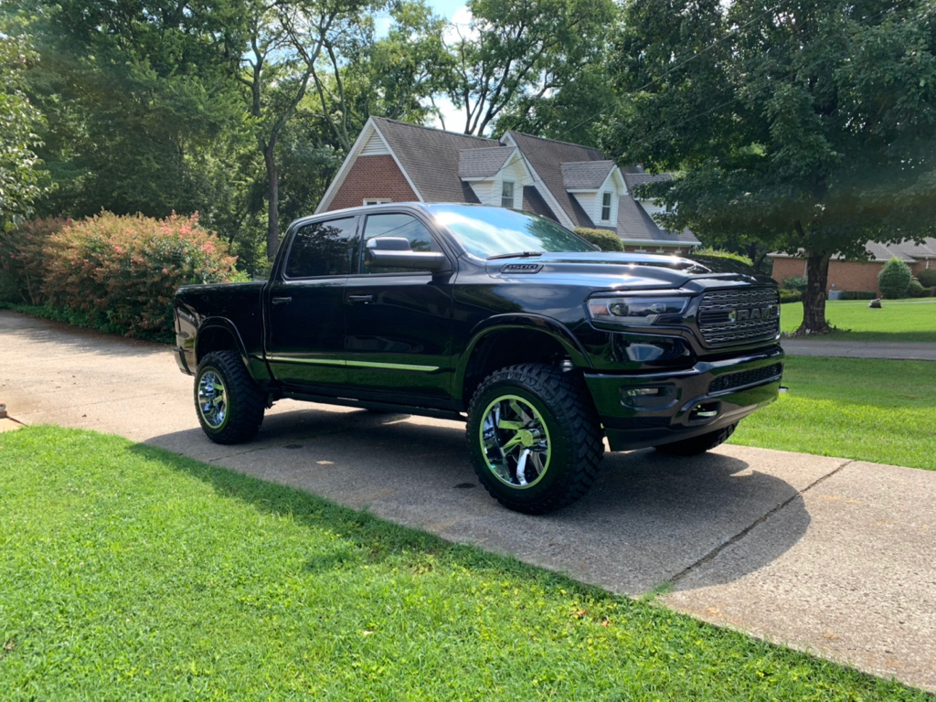

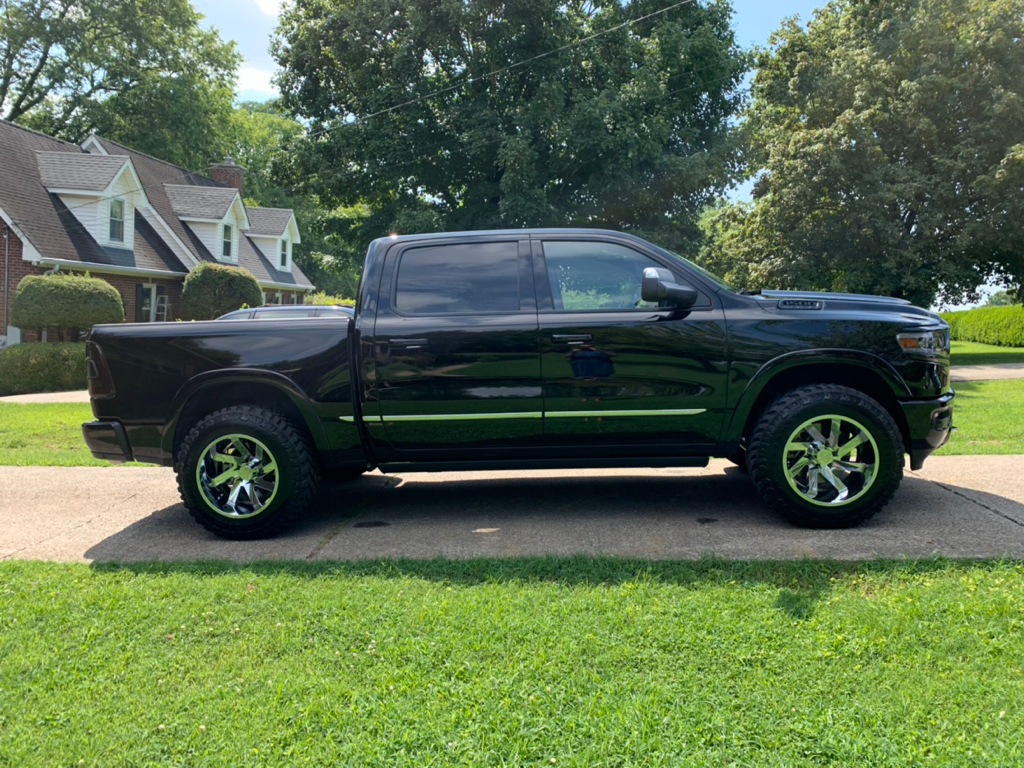

Photo after tint was installed today. If anyone lives in the Minneapolis area and looking for tint or wrapping....a huge shout out to Rob @ Bings...stand up guy that does outstanding work! We ordered in wrap for the grill as well, but hasn't come in yet....that will be the last thing to do and then just enjoy it!

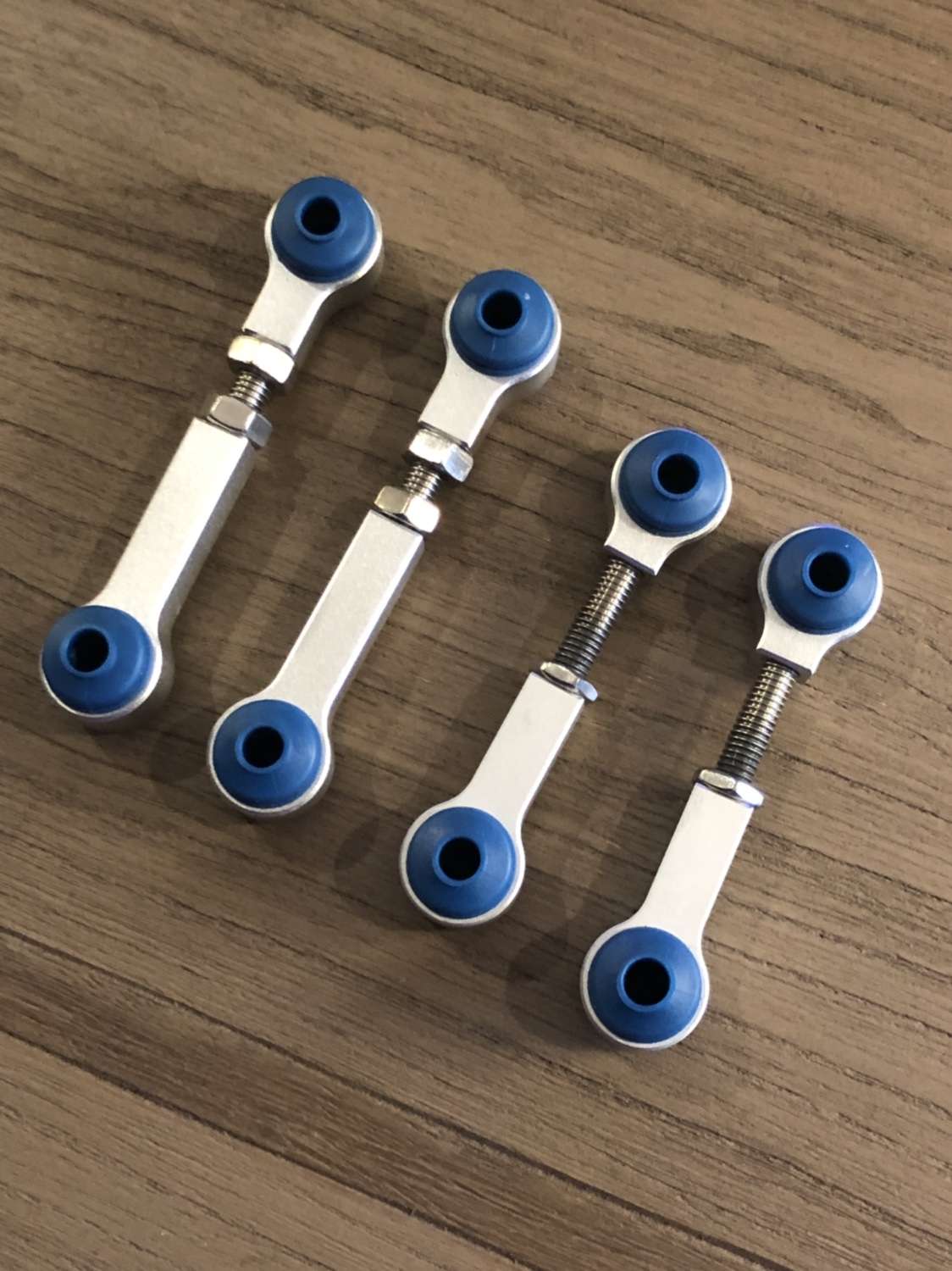

I made my own links to level the front. It still has a slight rake of exactly 1” but I am satisfied with the look and all modes work with no errors. I added the Daystar spacers at the same time and did not experience any change in the performance or feel of the suspension.
What size tire are you running? I wanted to go w Toyo RT's but they didnt offer a 33x12.5 in a 22 when I was shopping.
Your truck looks outstanding!
Thank you.
35x12.5
Dang...for real...I was nervous to jump up to the 35's. Was concerned about rubbing issues. Did you have to do any modifications in the wheel well or was the level enough to give you what you needed for a free range of motion?
Homemade links, daystar spacer, 35-12.50, 20x12, -51mm offset. Trimming required. OR1 maxes out height, only used when in TIGHT parking lots.. OR2 off limits (payload limited), usually drive around in AERO.
I used the other links and slightly customized with studs. Also running pro comps but 35x12.5s on -12 wheels. Just did the splash guard mod and no clearance issues in any mode.
I ended up not liking the bumpy ride and added a Daystar spacer, this brought back to stock ride if not better!
