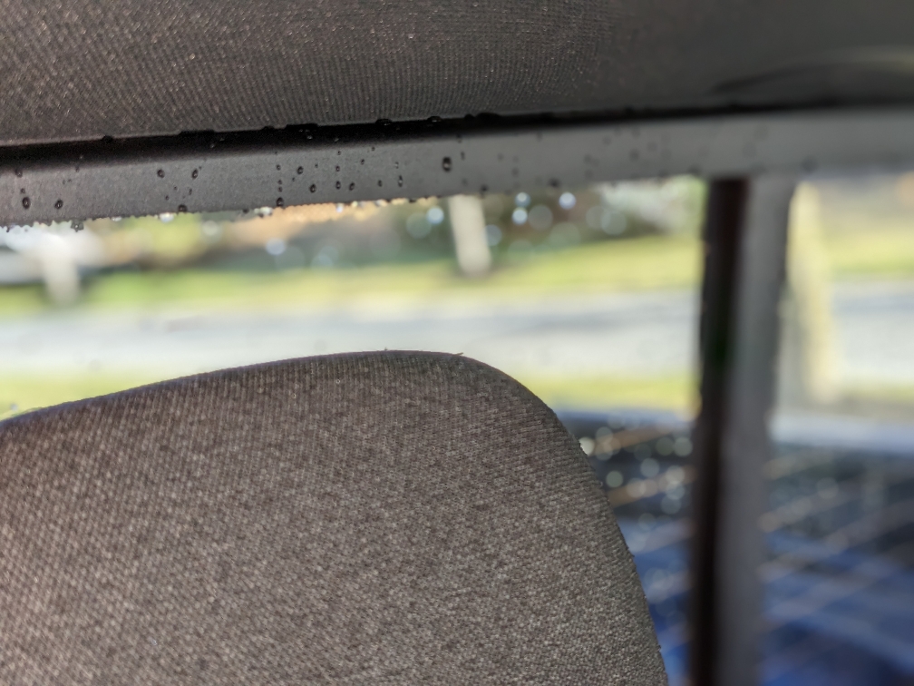

We are having light but steady rain this afternoon. Just got in the truck and happened to glance at the back seat. Leaking again. Or still leaking. It’s a 2020 but I’m at 41,500 miles. These warranty (and now out of warranty) issues are really getting old.

I would pull the third brake light and inspect the seal.
Press down on the seal with your finger and if it is gummy or water-logged, it is bad.

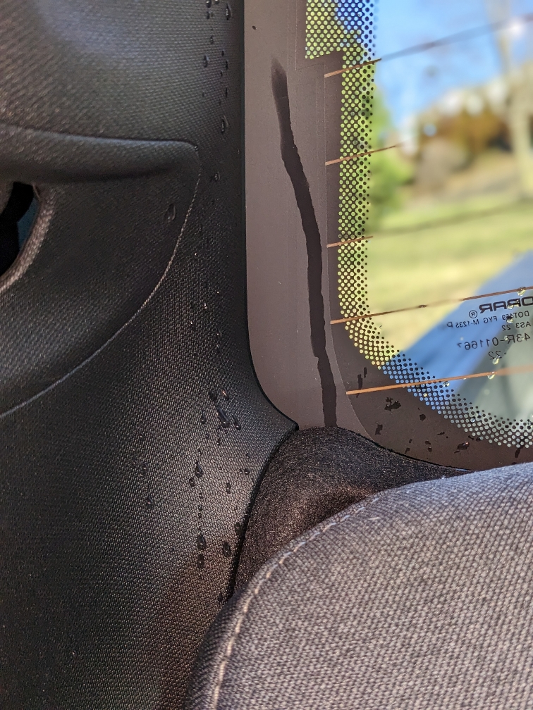

Purchased my 2020 Laramie Night Edition in November. Beautiful truck!...... Except, today I go out after a snow and hop in. my daughter says "daddy, where is all this water coming from?" look back and of course there are two cracks in the frame and two streams of water flowing in. incredible. I just switched jobs and used to have a company car, took a slightly reduced $ number for a high upside job that should ramp up by the end of this year, but for now things are tight (as they are for a lot of folks of course).. the feeling I had when i saw that was just such disgust and disappointment. I've owned many cars and trucks, never have i ever had water flowing inside when it rains or snows...

I would just buy a solid rear window and have your local glass shop install it. I think you can get one for $300-400... maybe a couple hundred to install. Done and no more leaks.
Interesting.. would be disappointing to not have the power rear window I guess, but certainly better than a leak! and that's certainly a cheap fix! is this particularly an issue with the opening version of the rear window? and here comes a real dumb follow up to the dumb question I just posed... the window frame that is cracked on the inside, is that....part of the window that would be removed...and a new solid rear window would have a new frame/trim? man i wish I knew more about this stuff...that was so dumb it hurt to type
The rear slider has a plastic frame that is bonded to the glass. The solid rear window is 100% glass, like the windshield.
I would try to seal your rear window with flowable Permatex first. If that works, you're good to go. If not, the solid rear window is the next best step, IMO.
