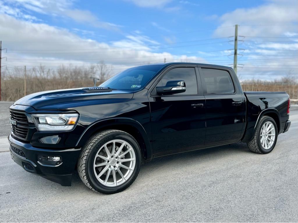

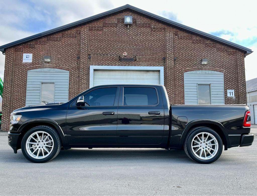

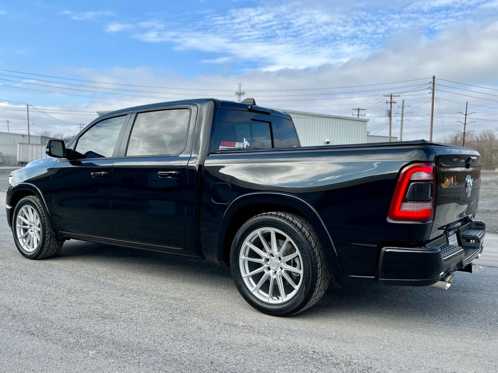

I haven't found a detailed thread with all the P/Ns and info in one easy to find post. Here ill post all the P/Ns, specs and links for the parts im installing. Most of this info is thanks to @Mopar_maxi
Truck is a 2021 Laramie Sport, CC, short bed, 4x4,non ORP, with etorque.
Suspension-
Mactrac 2/4 in lowering kit - P/N K332724
AIR LIFT 1000 Series Rear Airbags designed for a Durango- P/N 60824.
Spohn Performance Adjustable Rear Panhard Bar- P/N D09-1500-104 (you can get red or black)
Rear Bilstein 5100 shocks from a early 90s ford ranger. P/N 24-185684, ASIN # B004WO9JK2
With the spohn panhard you do not use the maxtrac relocation bracket, nor do you use the sway bar spacers in the kit. For the 5100 shocks you swap the maxtrac shock sleeves into them.
Wheels and tires-
Vossen HF6-1 22x9.5 +20- P/N HF61-2G20 with their Vossen lugs in black
Kumho Ecsta STX KL12 305/45R22- P/N KUM-1649113
As my truck sits right now with the 2in drop springs in the rear, I'm at 36in F and 37in R. My plan is to set the front struts to 1.5in, which should give me close to to no rake, and help keep the front alignment in the green. And use the helper bags when I load the motorcycles in the bed. Since every 2/4in dropped truck ive seen still has rake.
So far im right around $5k for everything since I was able to find a few deals and discounts. Pictures and video to come as I start everything based on the weather and snow on the ground.

Hauled the two bikes today and gear. Left the bags at the normal 10psi and really no sagging.
I assume with the two street bikes I’ll need 15-20psi

I am very happy with mine. Ride is great and looks awesome.
Ride quality is subjective. I think it’s better than Oem because I hated the floaty feeling the stock trucks have.

I’m going to have to figure out exhaust also. What are you guys running? My Borla already hits with the 2inch coils.
Yeah, any of the cut and clamp systems will work fine. As long as you keep the OEM over axle pipes your golden.
