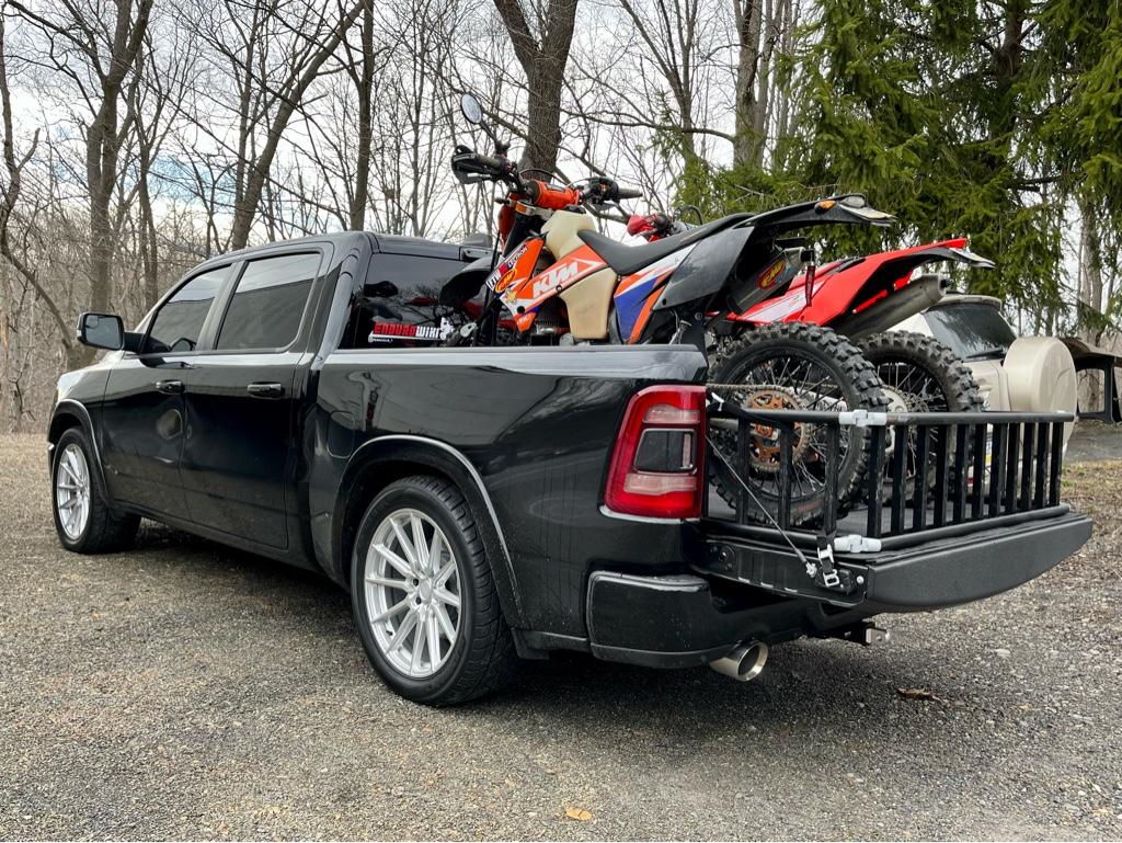

Hauled the two bikes today and gear. Left the bags at the normal 10psi and really no sagging.
I assume with the two street bikes I’ll need 15-20psi
really nic truck man, is it possible you can tell me what air lift bags you are using and what bilstein shocks please
