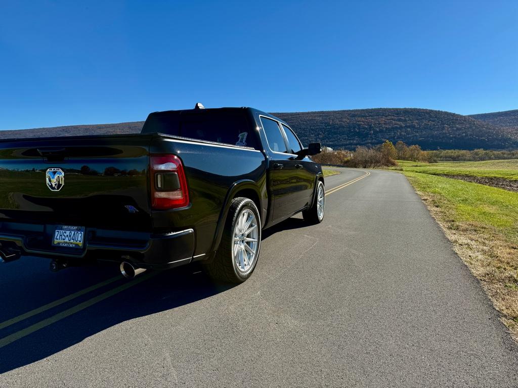

I had the Maxtrac 2/4 lowering kit installed on Monday. I did use the 1-1/2" spacers and the truck measures an inch and a half lower on the fronts with the split ring on the 4th groove. The rear measures 3" lower and still has some rake to it. It might settle some after a few miles, we'll see. The ride is close to stock with minimum air in the Airlift 1000 helper bags, but I do feel more small bumps or road cracks than before. I love the look, and am satisfied with the ride.1000003214.jpg1000003212.jpg
Bringing this back up to the top. Thanks to @ferraiolo1 for this thorough breakdown of parts and part numbers. I was able to replicate this install for my 2023 Built to Serve.
Everything went smoothly for the shop and I am very pleased with the results. I had to additionally purchase a set of stock front springs as my BTS came with the ORP springs, and I opted for the adjustable panhard bar and the Bilsteins with air bags and did not have to cut the bump stops and have not bottomed out yet (smooth Florida roads so ymmv). Next will be deciding on wheels, currently between the 22" Limited wheels and the 22" Night Edition
