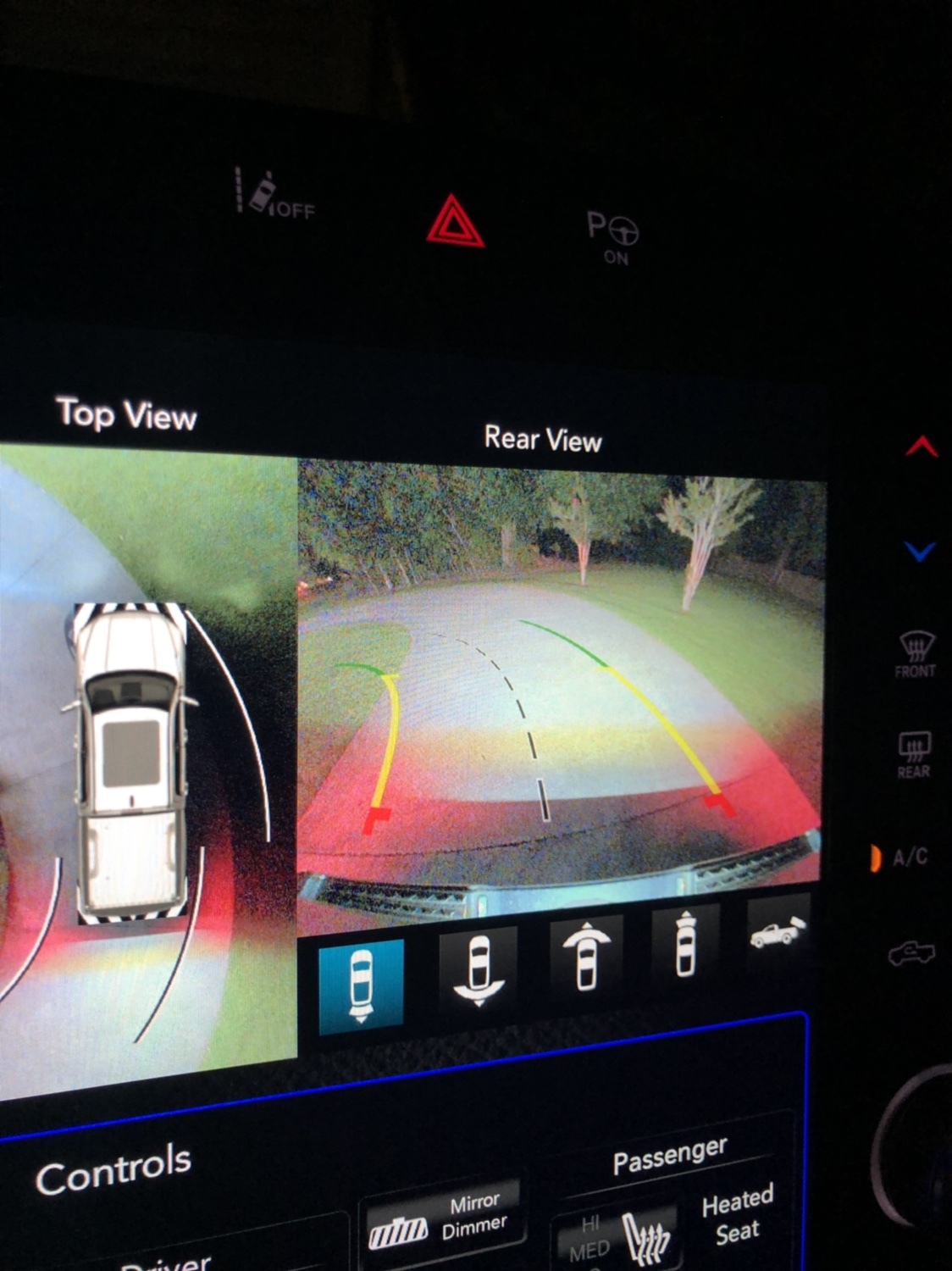

First time really using em at night, I'm impressed
