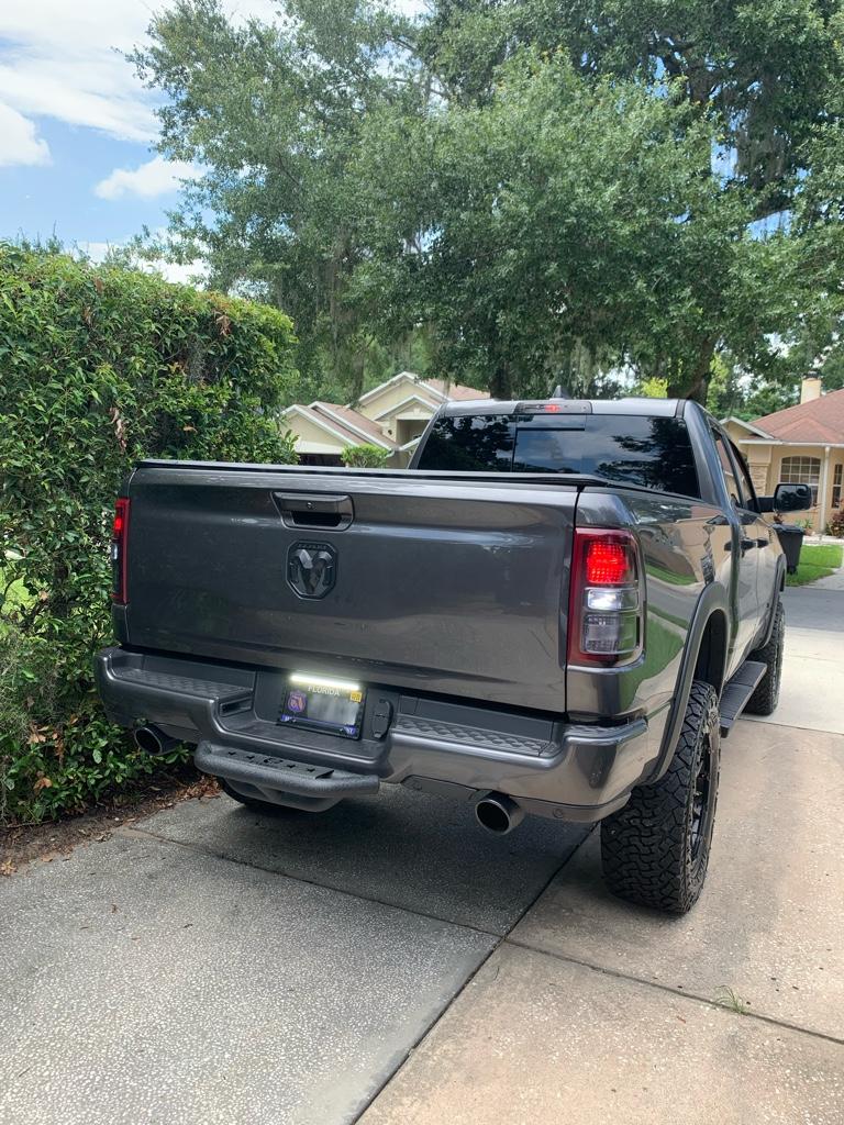

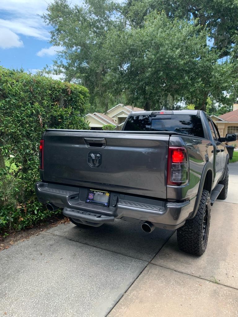

License Plate Reverse light
i have those "VLed"s also they always blow out in section,never a straight line of light.but i live in a very cold and snowy area.may hold up for you guys in warmer parts.
I live in BC, Canada. Yes it gets cold and snowy here believe it or not. LOL. No issue with mine here in that respect.
I did the XTR LP a couple of days ago. Unfortunately mine was one of the ones that the tailgate hit. Thanks to this thread and the advice given, I trimmed the bottom of the plate off and it doesn't hit now.
I tapped into the passenger tail light. White with purple.
The light output is excellent. Almost night and day, hahaha!
Thank you for the great advice here!
