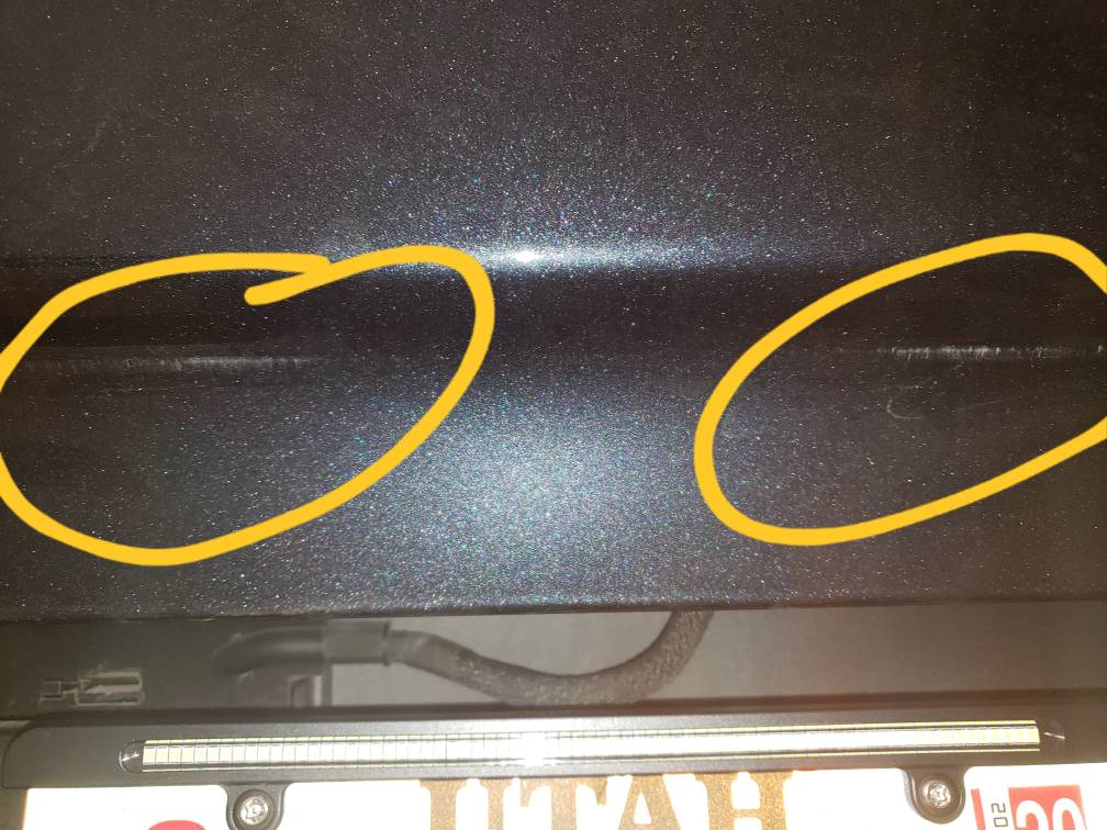

My VLEDs are hitting the tailgate when it is down. Anyone else had this problem? Laramie sport.
Just checked....mine is hitting the tailgate as well. Glad you posted as I didn't noticed this previously.
Will have to flip it around as well I guess.

Very interesting Mine is the gloss model and it was rubbing. I flipped it and tested it tonight and it still lights up the neighbor's yard across the street. I'm happy with it again. :)

I have the satin finish and mine is rubbing.

The problem is that the way the LPR is made, it only lines up with the screw holes in my tag (top or bottom) if the tag is set into the groove on the back of the LPR. That means that the LPR adds about 1/4" of height to the tag, whether it's on the top or bottom. With the LPR on top, it was barely rubbing on my tailgate, and only does so just when the tailgate gets to being 100% open. With the LPR on top, my tag is sitting all the way, so the bottom of the tag is resting on the bumper itself. In other words, it cannot go any lower. So, there is no way to mount the LPR on the top of my tag where it won't rub.
And if I put it on the bottom of the tag, I have 2 problems. One, with the LPR holes lined up with the bottom tag holes, it pushes the tag itself up about 1/4" from resting on the bumper. That means that the holes in the top of the tag no longer line up with the screw holes in the bumper. And, two, I didn't actually check, but I would expect that, since that much extra height caused the LPR to rub the tailgate, the top of the tag would rub against the tailgate.
At this point, I don't see any feasible way to use the LPR as it is currently designed. What I think they need to do is mill down the top of the LPR so that it does not extend above the top of the tag at all. It is an unfortunate and poor design choice that they made that results in the LPR adding 1/4" or so of extra height to the license plate. I suspect it would work fine on many vehicles. But, it does not work on my truck.
Just spoke with Eli at VLEDS. Unfortunately, he confirmed that there’s about 1/16” overlap when the tailgate comes down that rubs against the LPR and scratches the paint on the tailgate. Cancelled my order. Bummer...
On a positive note, however, he said the engineers were aware of the conflict and could work to resolve it, but it probably wouldn’t be until the fall. I’ll be keeping an eye out for this fix, as I could really use the extra illumination.

Yeah, I emailed VLEDs and Eli emailed me back. He wanted me to try cutting off a little bit at the top and bottom of my license plate, etc.. I emailed him back to explain why that doesn't help at all. I.e. because the holes in the LPR still line up in the same place with the holes in the license plate and the holes in the bumper.
The only way I could see it working is to cut off a strip from the bottom of the license plate and then drill new holes in the bumper to allow mounting the license plate and LPR in a slightly lower position. Personally, I'm not really interested in cutting off part of my license plate or in drilling extra holes in my bumper.

I was able to put it on the bottom of my license plate without issue. I did drill two screws into the bottom, but I didn't see that as a huge deal. No shaving of the plate required.
So now you’re plate sits up higher than before? And the plate doesn’t touch the tailgate at all?
