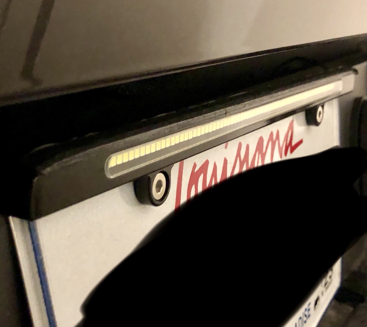

Interesting to see this fitment issue come up. I DO NOT have rubbing on my tailgate at all. I checked this before I ever wired it up. I've got a clear air gap between the light and the opened tailgate, and I just checked with two 50# bags of oil dry on the gate and can slide a business card between! My hypothesis is that it is a function of how tight the rear bumper was aligned on the line.
I have to at light again. My tailgate is touching it. Slight marks on tailgate. I love this light. Second truck it’s been on
Will try some adjusting or move plate lower if possible

got mine all done today. did the folding license plate method and fits fine. Ideally i would've likes to not do that and even use the LPR frame since they look so nice together but this will do just fine.
Finally had a chance to install replacement VLEDS , everything is bright again!!! Hopefully the one that failed was a fluke and not something related to my trucks electrical system. Have to send a picture showing destroyed faulty product. Thanks VLEDS
so far the weatherstripping has held up and not scratched my tailgate. I’m gonna drill some holes and trim my license plate for a more permanent solution
After trimming, I ended up setting the license plate down as far as it would go, resting in slot on bumper. Drilled holes in plastic approximately 1/2" lower than original holes. No rubbing. Had son get on tailgate (200lbs), no rubbing issues.
I did the same as Zeeya, I trimmed a 1/8" of the top and bottom of the plate with a tin snips, smoothed edge with a grinder and file, then made the top holes in the plate to slots to fit to the top of the VLED fixture. In all lowered the backup light about 1/4" from original plate position and original holes in bumper covered by VLED. No rubbing issue, at least 3/16" gap between the VLED and the tailgate. Love the light for backing.
