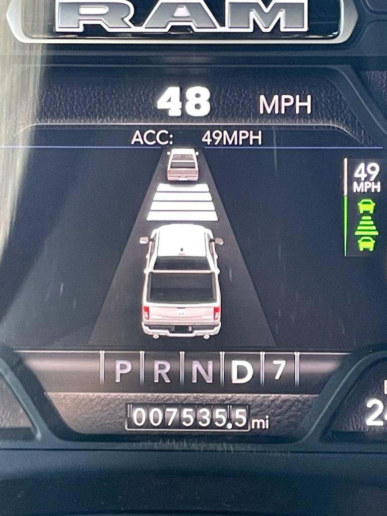

Messed with the settings a little more tonight now that I have a functioning windows tablet that actually connects.
@Jimmy07, any ideas as to why as long as I am connected to the abs module, I can get ACC to come up and display just fine without any warnings, but as soon as I disconnect I lose it along with AEB?
Disregard my last post. Good news....I got ACC functioning, still have FCW/AEB, regular cruise, and have no warnings on the dash. I only went around the block and didn’t have the chance to test it in traffic, but I’ll do that tomorrow. Also haven’t cycled the ignition more than once since I got it working, so I don’t want to say there are no issues and it’s here to stay until I’m sure of it. I’ll pull a log and post up the changes required on my truck, cause they don’t quite match up with what was posted by @tdb0021 for his truck.
Can you elaborate on what settings or procedures you did to get it working?
I want to hold off until I know it’s a permanent change or not. I cycled the ignition again and got warning lights and had to go back in and undo then redo changes to get back to having it work. So something is still acting funny and the change isn’t sticking permanently. I’ll see what I can come up with tomorrow.
Only thing you did was change like one or two additional settings right? So maybe we don’t need an ABS module. Look forward to seeing what your results are tomorrow!
Wasn’t any extra, just a different configuration of the ones listed. Doing a little more testing this morning. Had it working on the highway and it would speed up and slow down based on distance selected. However I’m not confident the brakes engage to slow the truck if someone slows down quickly, as I had to manually hit them when I got a little too close for comfort. After a few miles the system kicked off and I got the lights again. I’ll see what codes might be in there and mess with it again later.
