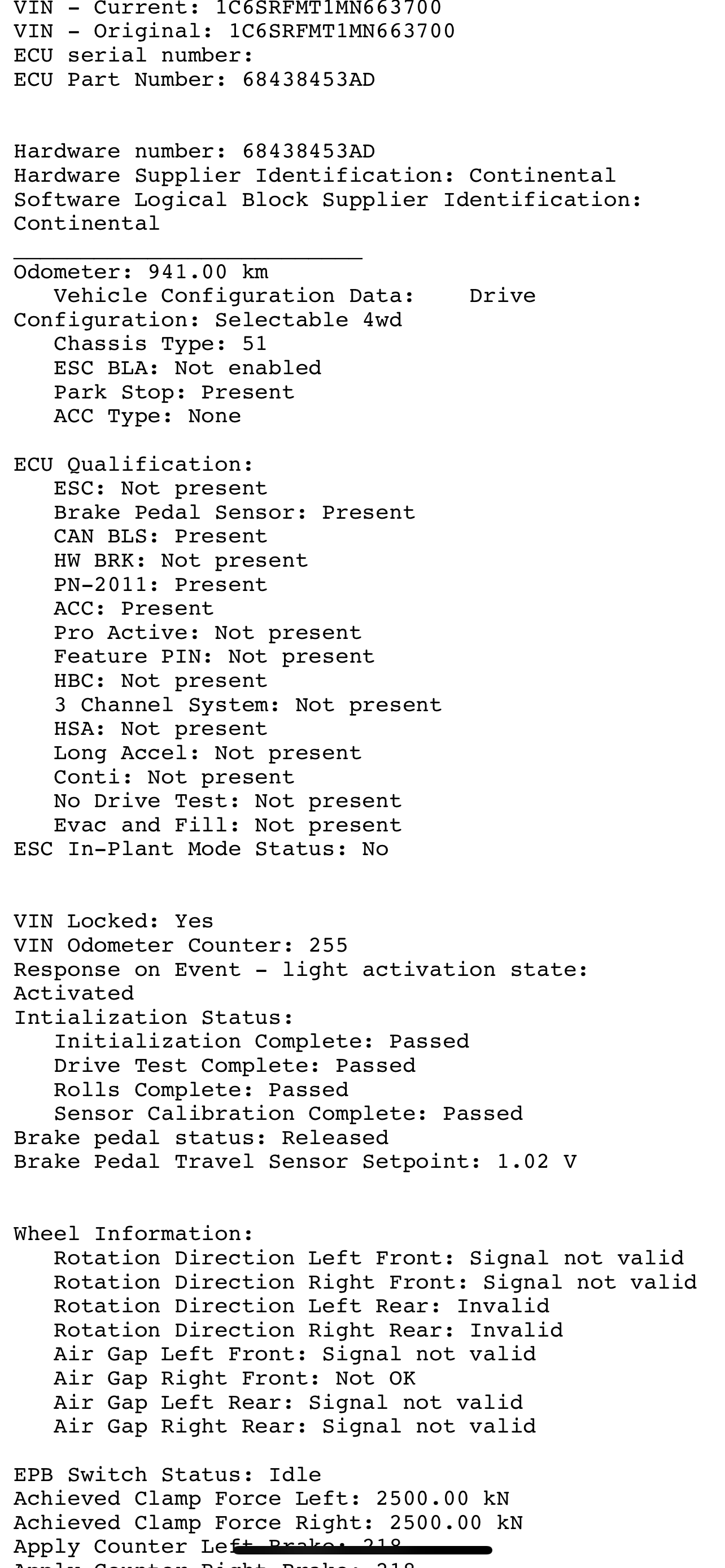

Can you use AlfaOBD and connect to the ABS and see what part and hardware number come up? I’m guessing it will probably be the same as mine. I have FCW but not lame sense from the factory.
From AlfaOBD this is the part number I get 68438453AD
Funny thing this is the reading from my ABS module before I changed anything, and under ECU Qualifications it says ACC: Present
