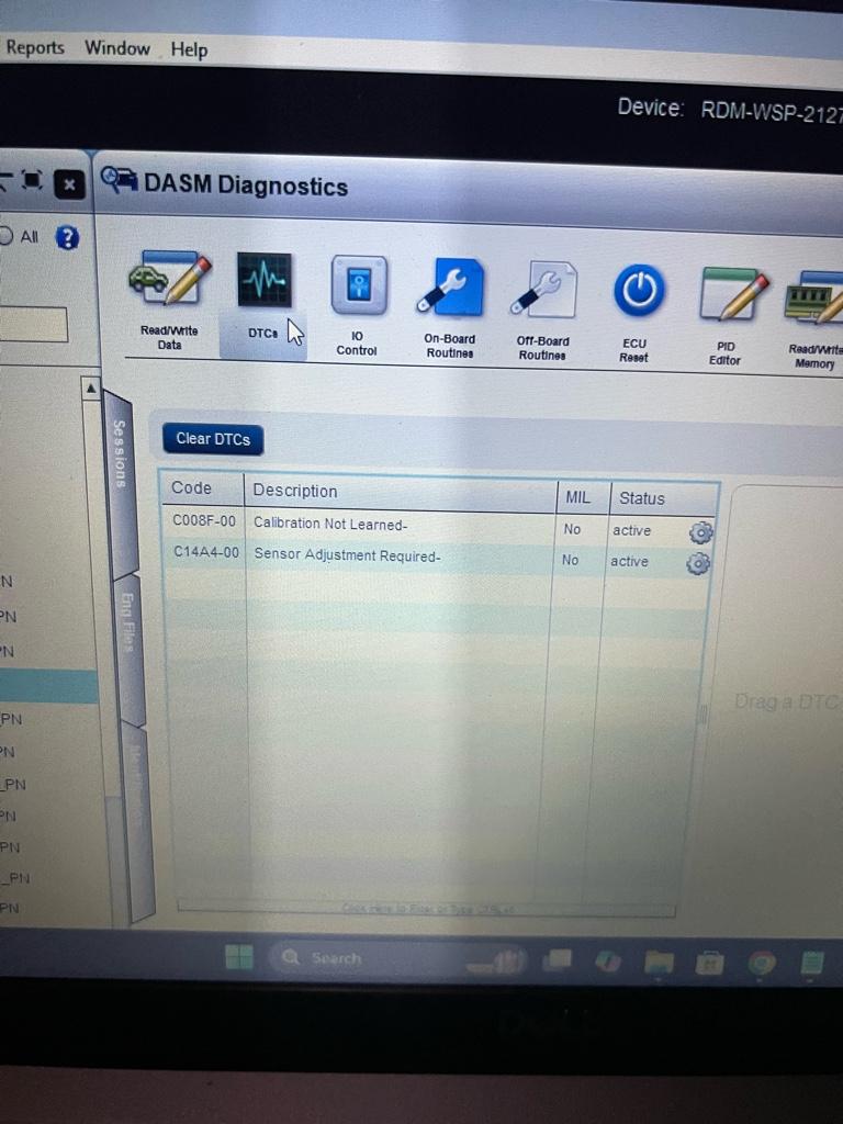

UPDATE: I went to the dealer and they actually broke the DASM lol. After i left the dealer and was going home all the ACC FCW LKA AHB warnings came on. When i went back to them they made me wait another hour only to come back and tell they couldn’t work on it. I spoke to the tech and they used a actual bubble level and guesswork to make the DASM sit straight
I asked the tech to show me the service procedure and as [mention]Jimmy07 [/mention] mentioned it needs to sit at -1 degrees. The document process he showed me on screen had a digital level like device but its not the same because it can read angle in negative degrees.

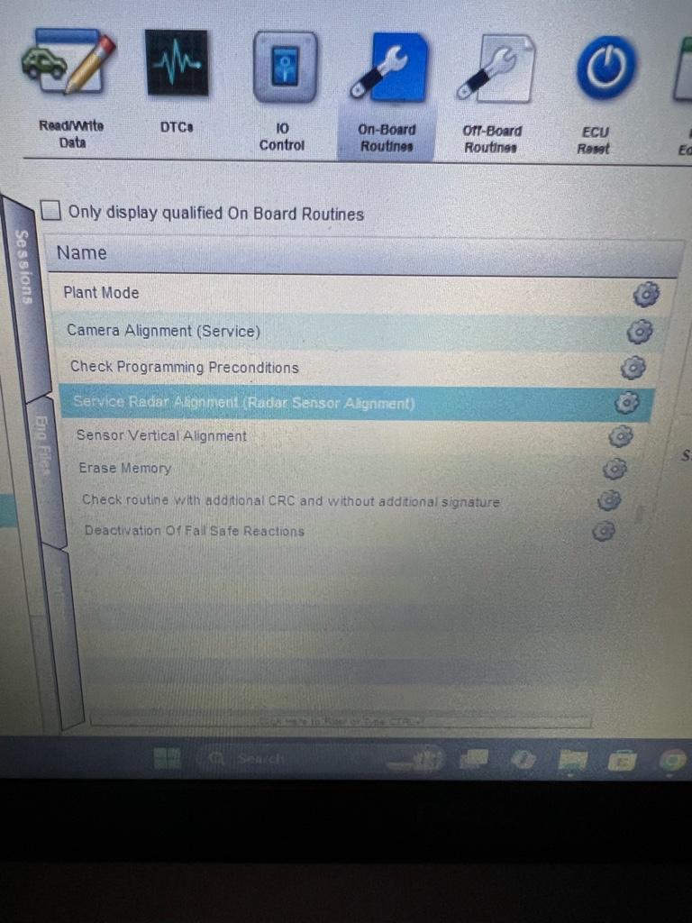

FIX: I do have cda6 so i decided to tackle it myself because the dealer said it will be a couple of weeks to get that “inclinometer” that reads negative degrees.
I decided to give it a shot myself. After messing around for a bit this is what i did:
The codes in DASM:

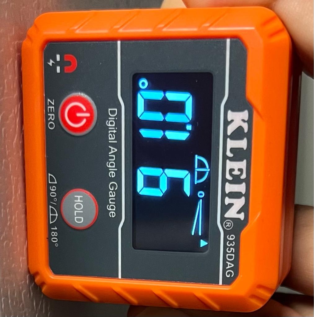

Get yourself one of this on Amazon. The model number is in picture. Around 30$
There is a E torx screw on right side of DASM bracket. I used E6 socket and turned it clockwise/anticlockwise until i got the 91.0 degrees on the screen. Make sure the digital level is in 180 degrees mode and not 90.
The dealer had it set at 85 degrees no wonder it was freaking out
You will need to hold this digital level flat on DASM.
DO NOT APPLY PRESSURE. JUST HOLD IT GENTLY AGAINST DASM.
I measure the DASM near the right bracket, center, near the connector. I made sure all 3 spots on the back heatsink read the same 91 degrees.

Go into CDA6:
Start this process. You will see the cluster display FRONT RADAR SENSOR ALIGN MODE.

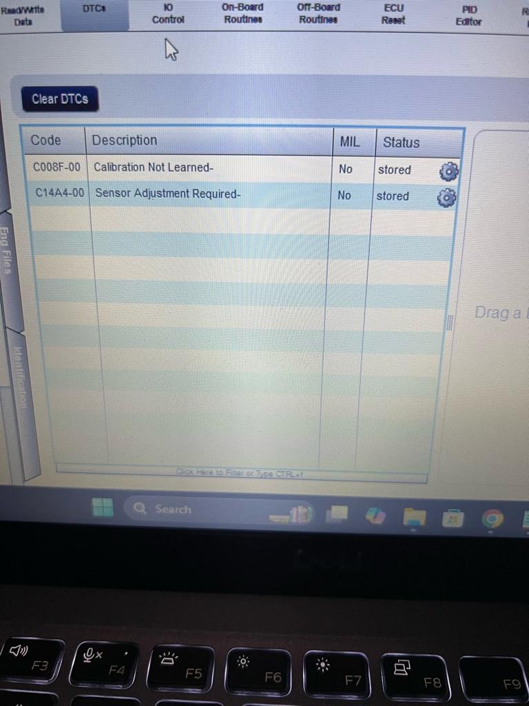

You can check the status by randomly tapping the ACC button after a few mins and you will see the ALIGN MODE message displayed. That means its still processing.
Once it finished it will automatically display ACC FCW LKA enabled and all the warnings go away. I drove around for a bit and tested all the systems to make sure it works.
If all went well there should be no codes and you can clear everything.

[mention]Jimmy07 [/mention] if you know the digital level they use to read negative degrees can you link it here so someone who needs it can buy it. The one i used is a reputable one but just doesn’t do negative angles.
I wasn’t sure if -1 degree would equal to 89 or 91 degrees on this device but after a bit of messing around for hours 91 did the trick and that is correct because it has to be pointing up a bit to ignore the hood and front of truck plus have additional distance to scan ahead.
The codes in DASM:

Go into CDA6:
I wasn’t sure is -1 degree would equal to 89 or 91 degrees on this device but after a bit of messing around for hours 91 did the trick and that is correct because it has to be pointing up a bit to ignore the hood and front of truck plus have additional distance to scan ahead.

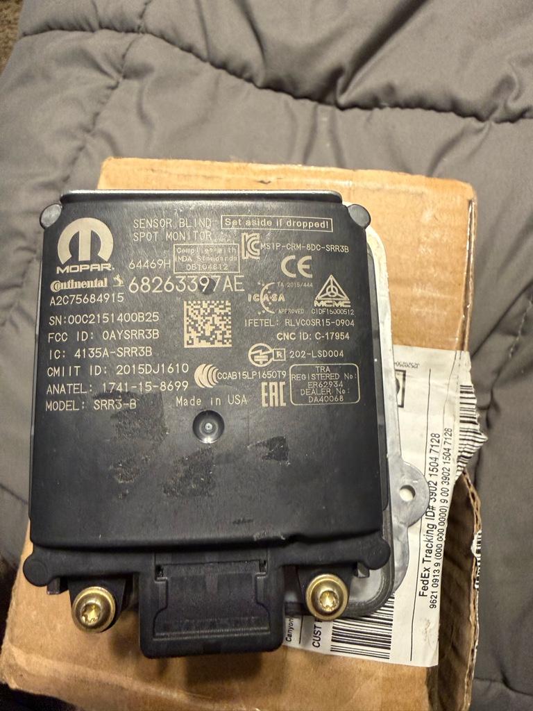

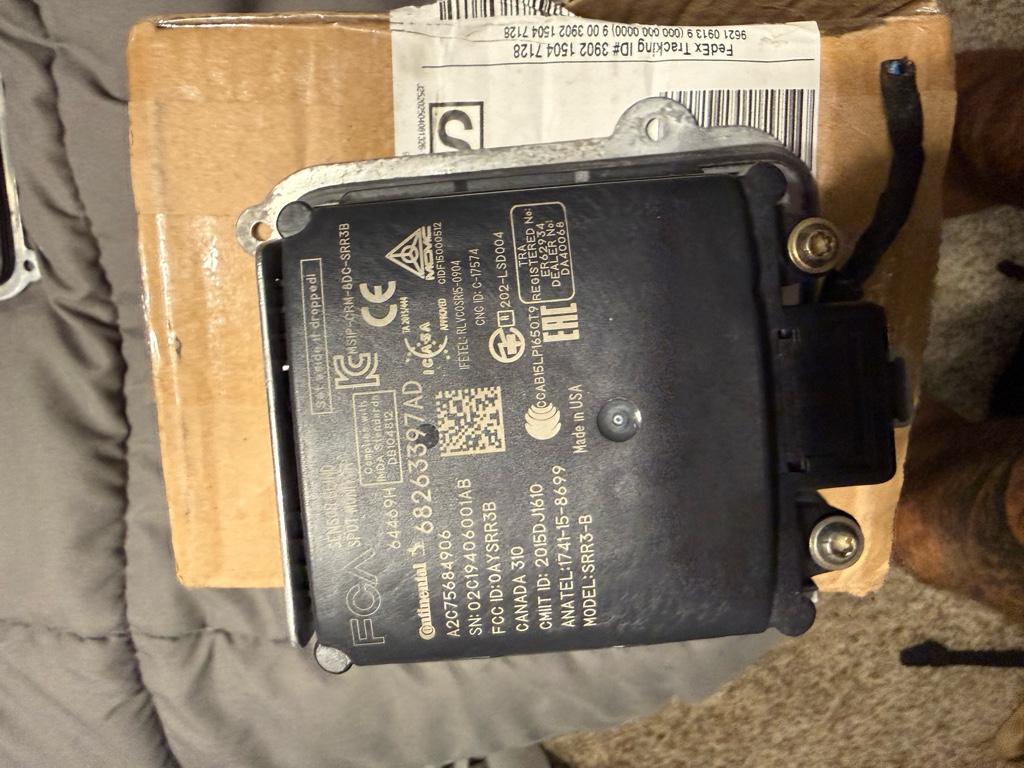

Hey all, selling the blind spot modules if anyone is interested in adding that feature. Ended up grabbing the already built in taillights from a junkyard. Shoot me a message.
