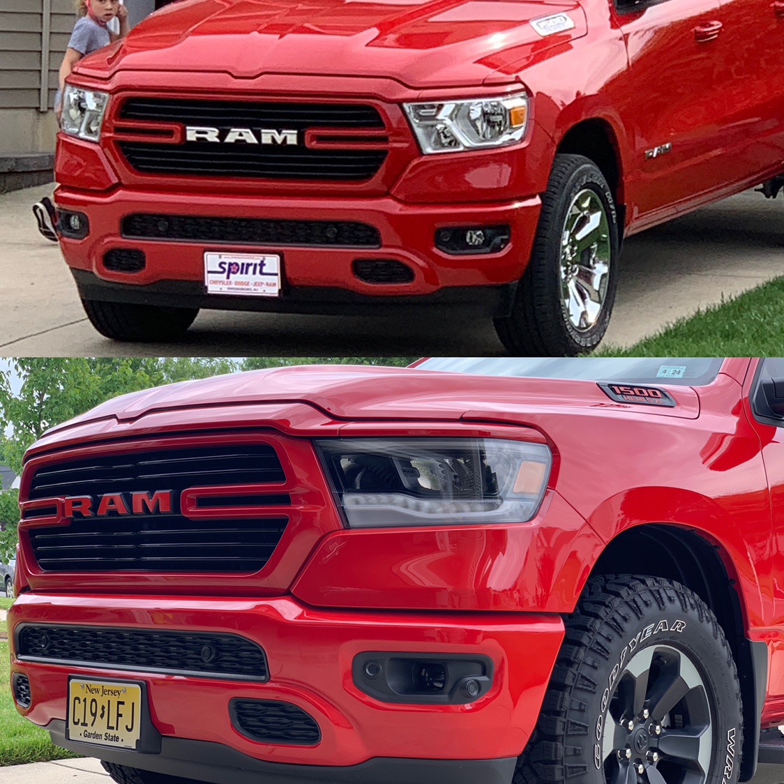

For anybody that wants to upgrade... comes with wire harness 58B18219-D25D-447C-9CCF-6FA441B9B8D1.png
