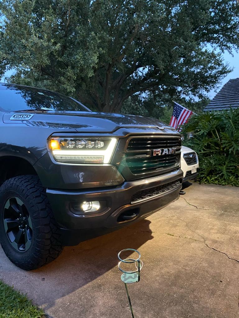

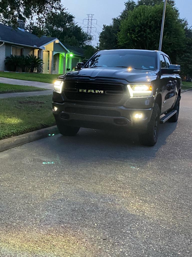

Put Alpha Rex Nova series headlights in today. Absolutely love them they are badass
Look great.... how are they holding up? Any issues? I'm on the fence between getting LED bulbs or new LED heads for my BH. Any advice?
Only issue was the DRL wire got pinched in the fusebox so it quit working but i've gotten that fixed now. No problems other than that
Those look like the halogens, are those in fact the Nova series with LEDs all the way around? Debating getting the Nova series or contacting my stealership for price on just the LED heads. Have a BH that came with the LED tails but stock halogen heads...very weird.
Yes they are the nova series full LED. The halogens only have 2 projectors, one for low, one for high. These have 3 for low, 1 for high.
