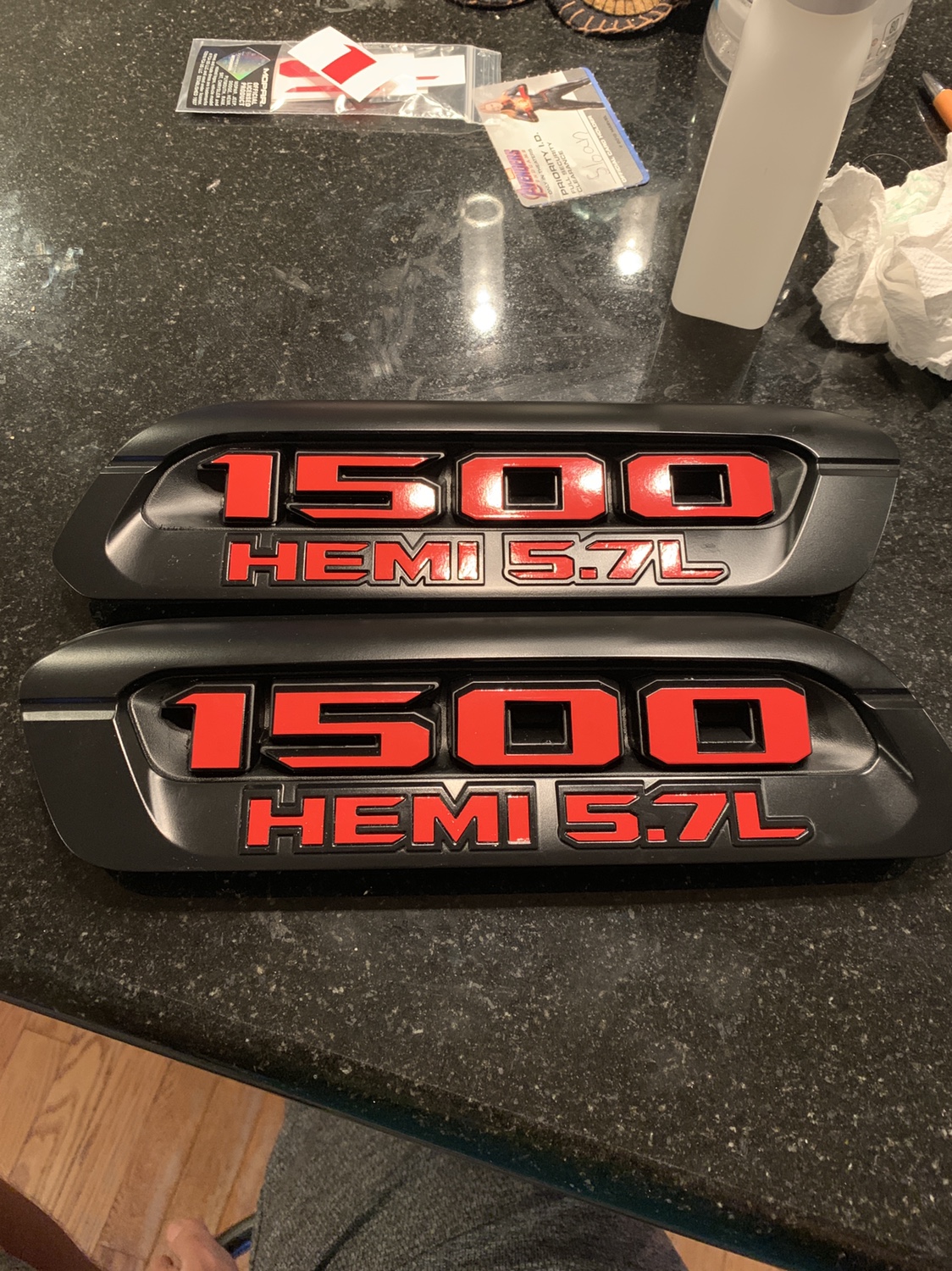

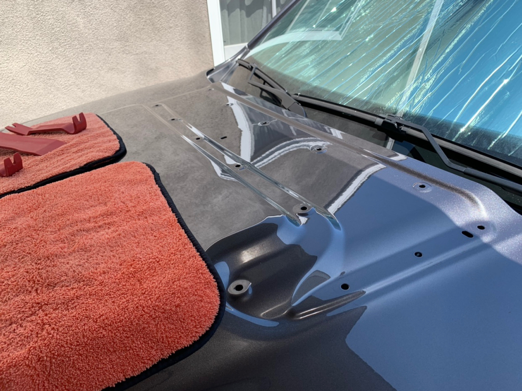

Heat w a hairdryer to loosen glue, then just pry it off w a trim removal tool or a flat head. You can try fishing line too, but there are posts in the badge that go into the main bezel so you won’t be able to get the line all the way throughMay I ask how you removed the panels?
Awesome, thanks for the feedback & tips.Heat w a hairdryer to loosen glue, then just pry it off w a trim removal tool or a flat head. You can try fishing line too, but there are posts in the badge that go into the main bezel so you won’t be able to get the line all the way through

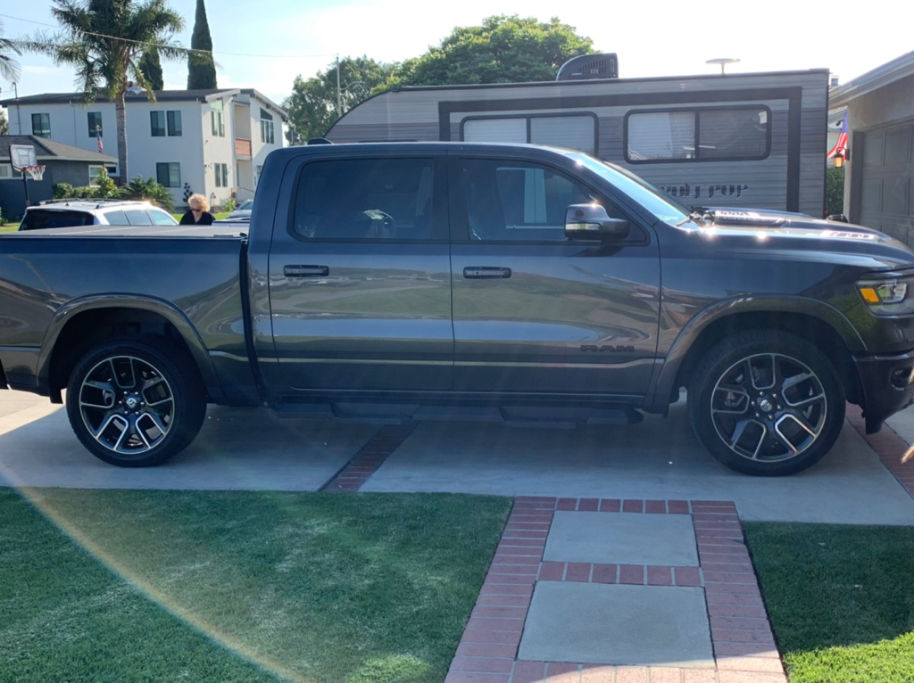

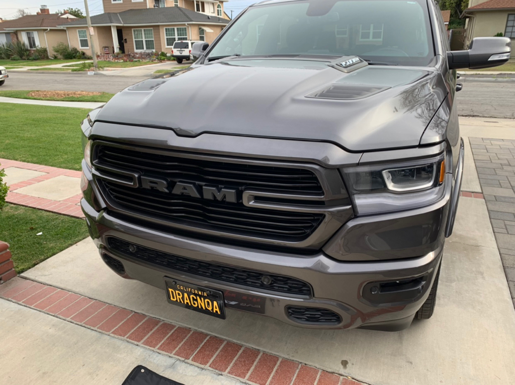

Did the new blacked out one come with all new clips? Also, how was it taking off the old chrome one?Well it’s done, all badges changed!!!!

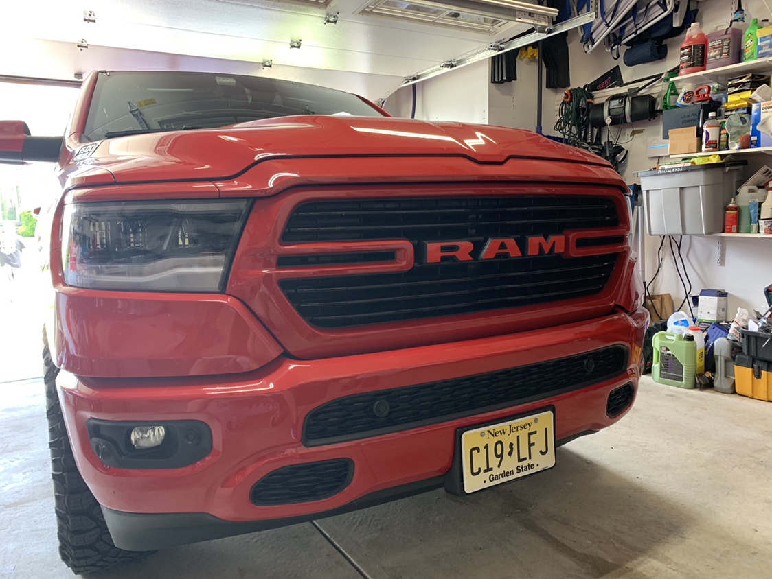

I have a black Longhorn. What do you guys think about doing blacked out grill RAM letters, Hood Emblems, and Tailgate.
Then have gold overlays on the text to bring the interior outwards. In my head it makes sense.![]()

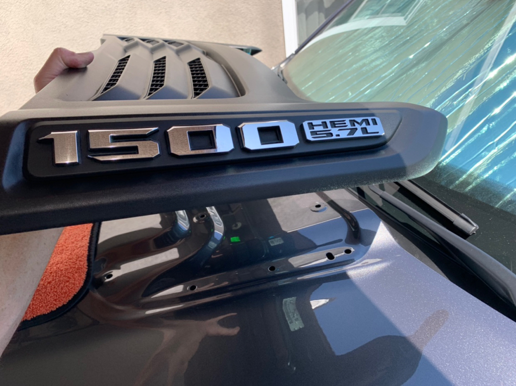

Yes, new one comes with all the clips, as well as new rubber washers for each post. Getting the old one off took a bit of work, but once you get it started, the clips (or posts I guess you could call them) pop right out. Quite a few of them broke off during removal, but I wasn’t too concerned as I wasn’t going to reuse it anyway.Did the new blacked out one come with all new clips? Also, how was it taking off the old chrome one?

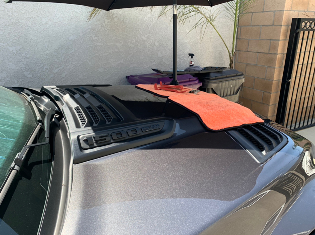

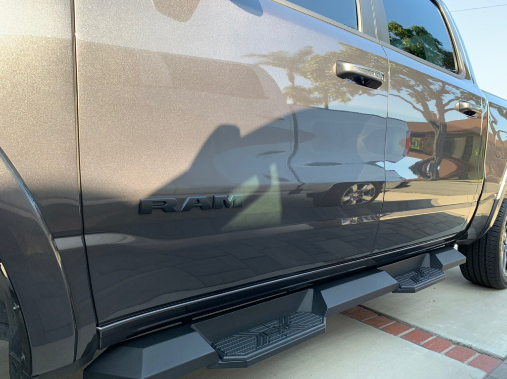

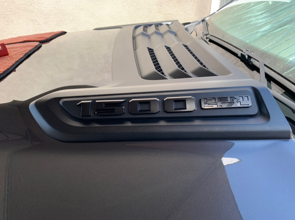

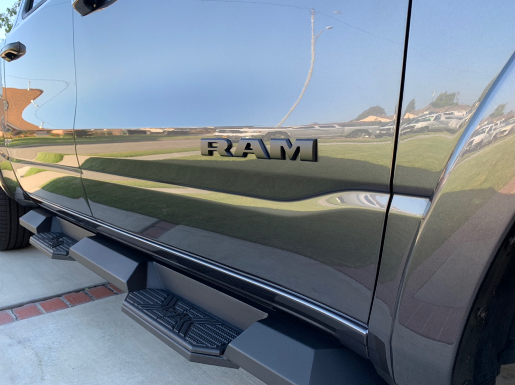

Just finished up changing out the doors. The only piece I have left to do is the hood. I have the whole louvered piece (sport hood) and just need to figure out the best way to remove the old one. I’m a bit nervous to take a pry tool to it and start popping clips. I think there’s a post from a member who’s done it.....without damage.

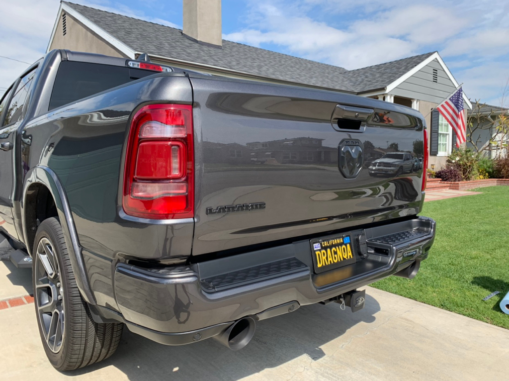

Sorry about the delay in responding, but I'm glad you located the part number....and thanks for posting it up for the others who may need one. Make sure to post some photos of your completed work.I've got the same truck and am doing the same thing with the badges. I've ordered the front, sides, and rear already and after seeing what you've done, I'm going to have to order the hood and Laramie ones too. Do you mind sharing where you got the black Laramie emblem on the tailgate? I cannot locate it anywhere. I've put in the VIN for a Lamarie with the blackout appearance package into multiple Mopar part sites and can't seem to find this one.
Update: I found the part number. Thought I'd share it here for others that might be interested. 68282678AB
