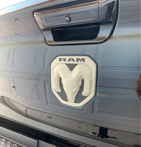

how did you paint the tailgate ram head emblem?
I did mine with Plastidip. Just mask off a box about an inch away from the emblem and spray several coats (I do around 6 because you want it to be thick). When it's dry you just peel the Plastidip off your paint and it'll cut itself all around the emblem. Check out some tutorials on Youtube.

Unfortunately I have not heard of anyone being able to pull them off without breaking the clips. I plastidipped my tailgate emblem without removing it. I just made sure to cover and tape all around it. The hood emblems are next. Here is what my tailgate emblem looks like
