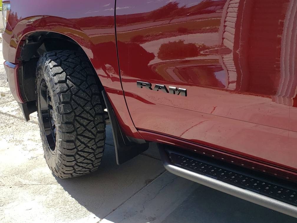

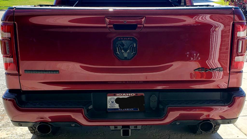

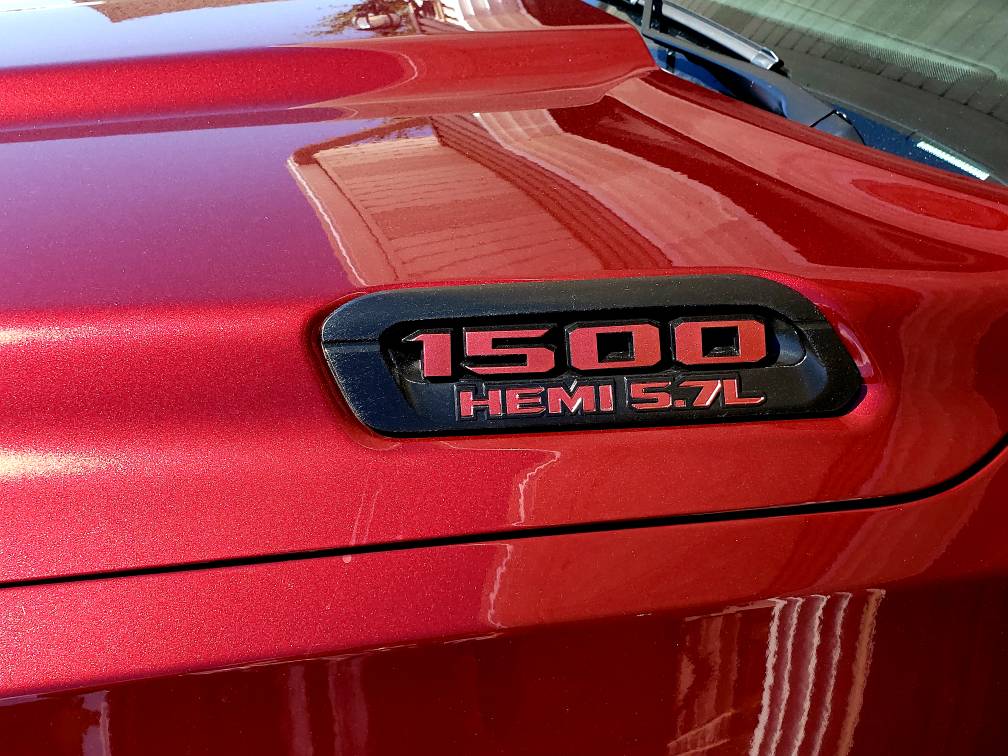

So I tried my hand at plastidiping my badges. Did all of them except for the grill letters. I liked the results but I have to fess up to some blemishes on the rams head - however it turned out better than expected.i also applied some vinyl lettering. Not perfect, but good enough.

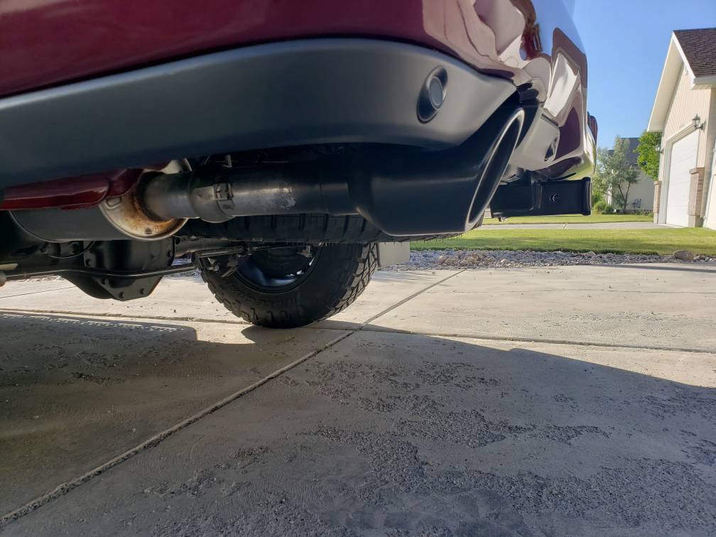

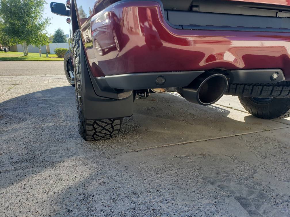

Based on a youtube video, I even plastidipped my exhaust tips a week ago. Let you know how well that lasts.

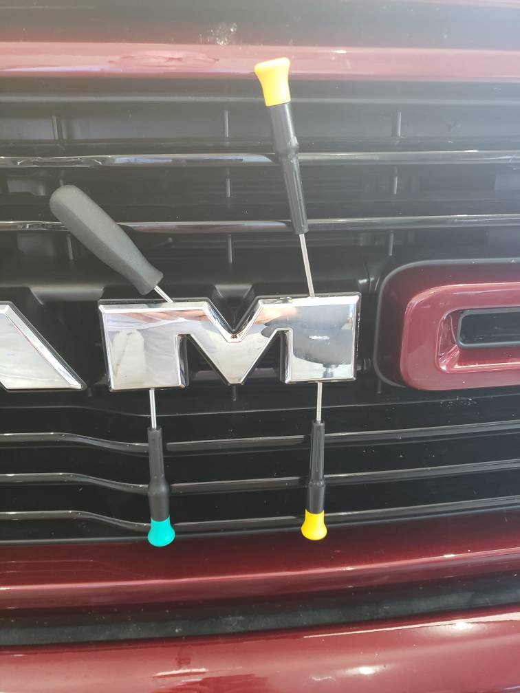

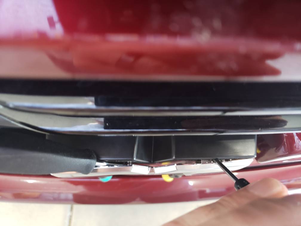

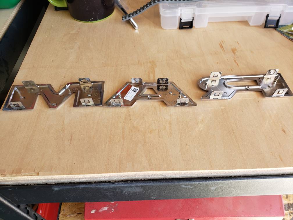

Didn't see a lot on removing the RAM letters so I included a few pics. Like others have said, I started with a straight blade and used small screwdrivers to hold and pull the letter from its base. I would create equal pressure around the pin and work to pull it out, moving the screwdrivers back and forth. I think I created some bad tension toward the end and clipped the tips, however, I did keep all tabs and (most of) the pins, but as you can see I gouged the hell out of the letter is some places.
