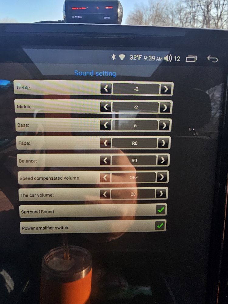

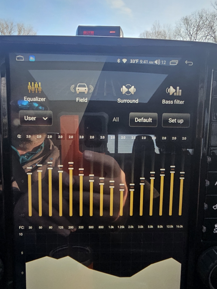

Mind sending screen shots of your eq pages. I also have the alpine 9spkr.

Next time I'm in the truck I'll take a picture. And you can follow my guide to adding the 360 cameras.
I'm currently working with Phoenix to figure out the usb issue. Never got to ask them about the camera. Maybe the wider angle lense on the 360 cameras is why it looked better in the demo. Planned on adding 360 in soon. Might be sooner than later now.
Here are pics of my screen. This works well for me.
