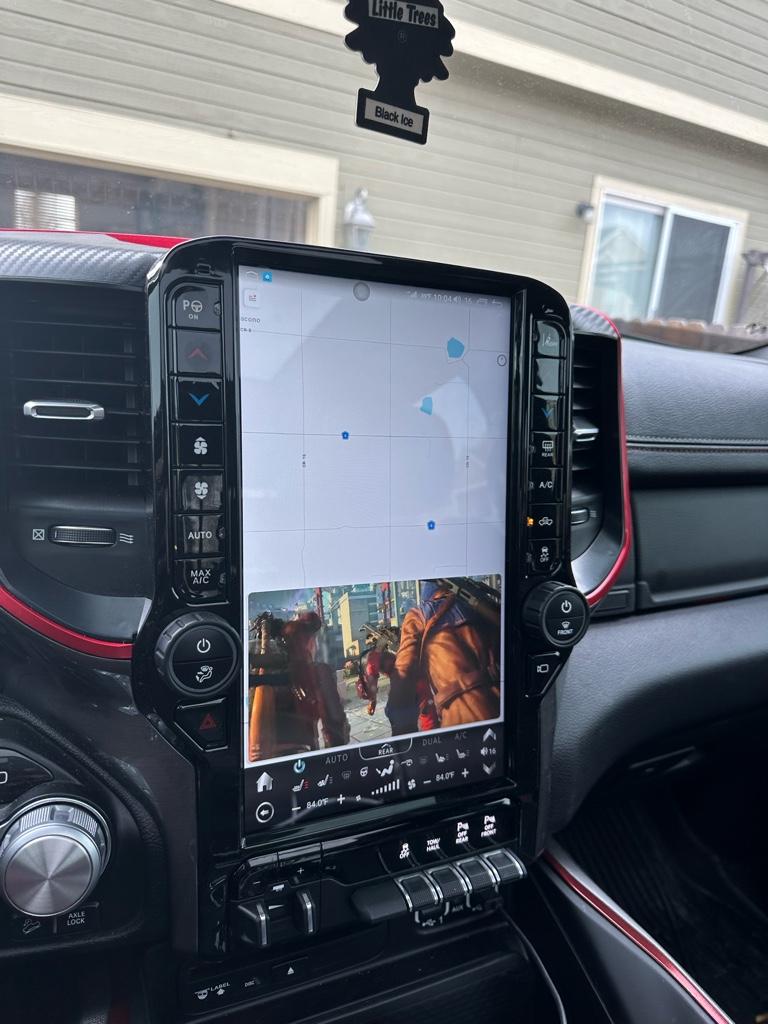

Here are pics of my screen. This works well for me.
Thanks. I'm assuming the other pages in the EQ app are default?
Yes, those other pages don't really do anything.
Thanks, this drastically helped. It was lacking on low volumes sounding super flat. When I'm driving by myself I will probably sit comfortably at 12. Now only problem left is the factory USB issue going into the radios usbs
