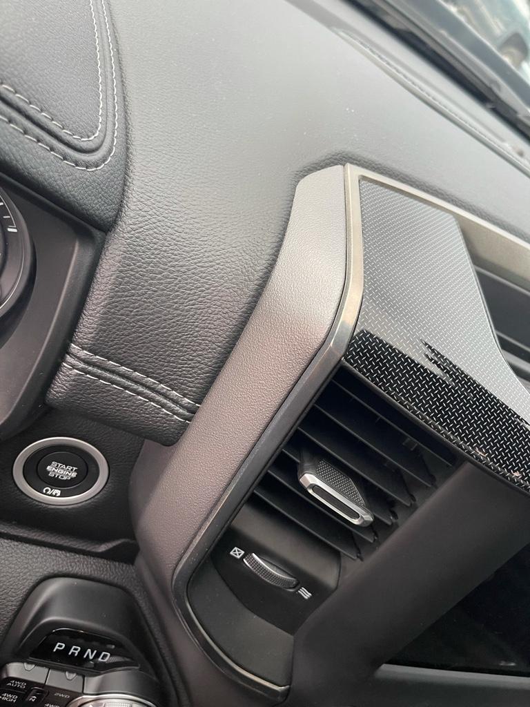

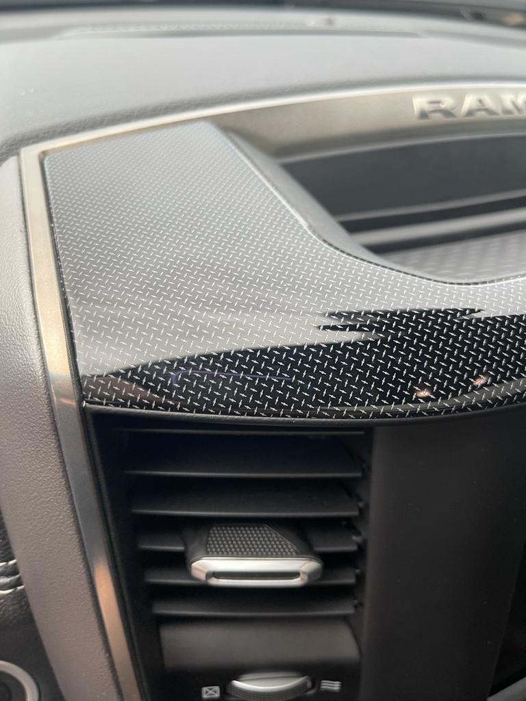

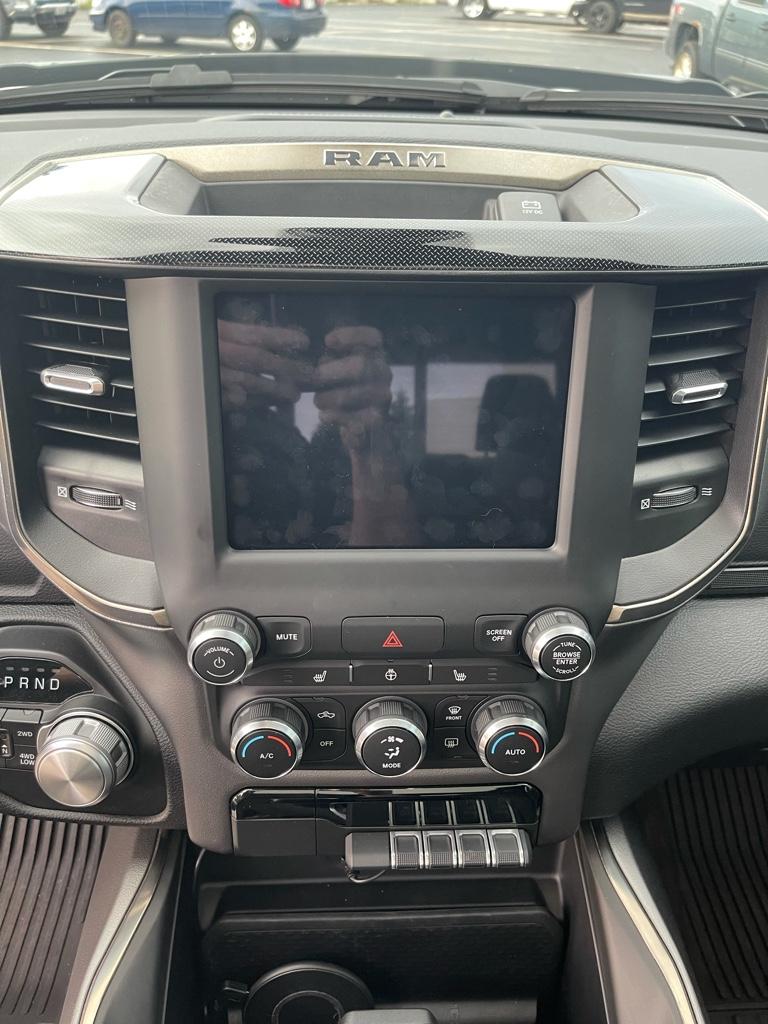

My truck is a 2020 Sport with dual auto climate without lane assist. I think I chose the correct center stack. It has a build date of 02/20 so I think I chose the right radio module. What’s hard to tell is the radio bezel style. Mine is like a gray/dark gray outer with this gloss black diamond plate look on top. I attached pictures of it. Im not 100% sure on the bezel.

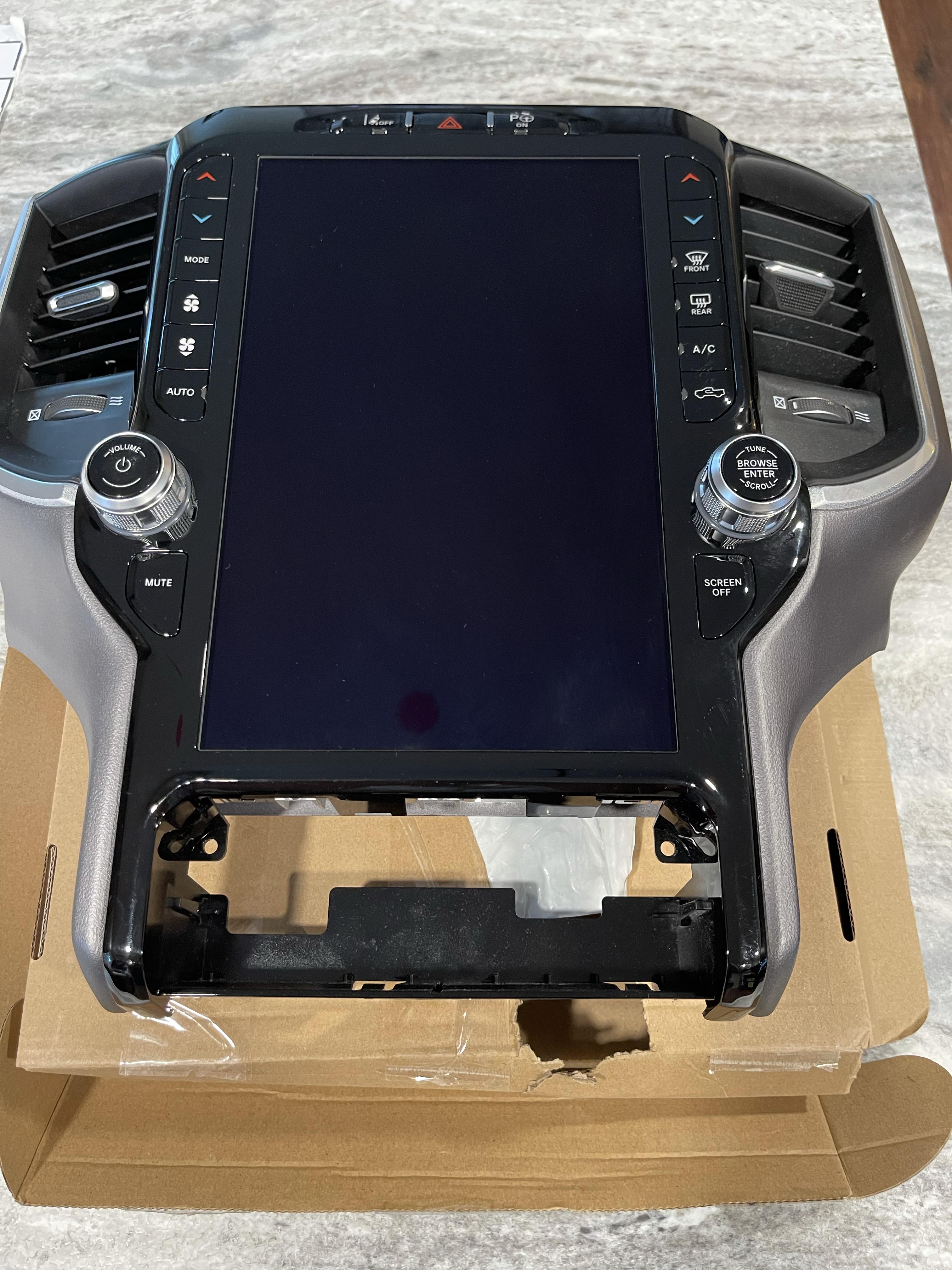

Received my screen and bezel from @SRTFreak. Rest of the parts should be here tomorrow. I can’t wait.
Hey bud do you have the part number for that bezel you got. Mine looks exactly like yours. Mine is a 2019 bighorn sport.
Thanks nicholas
