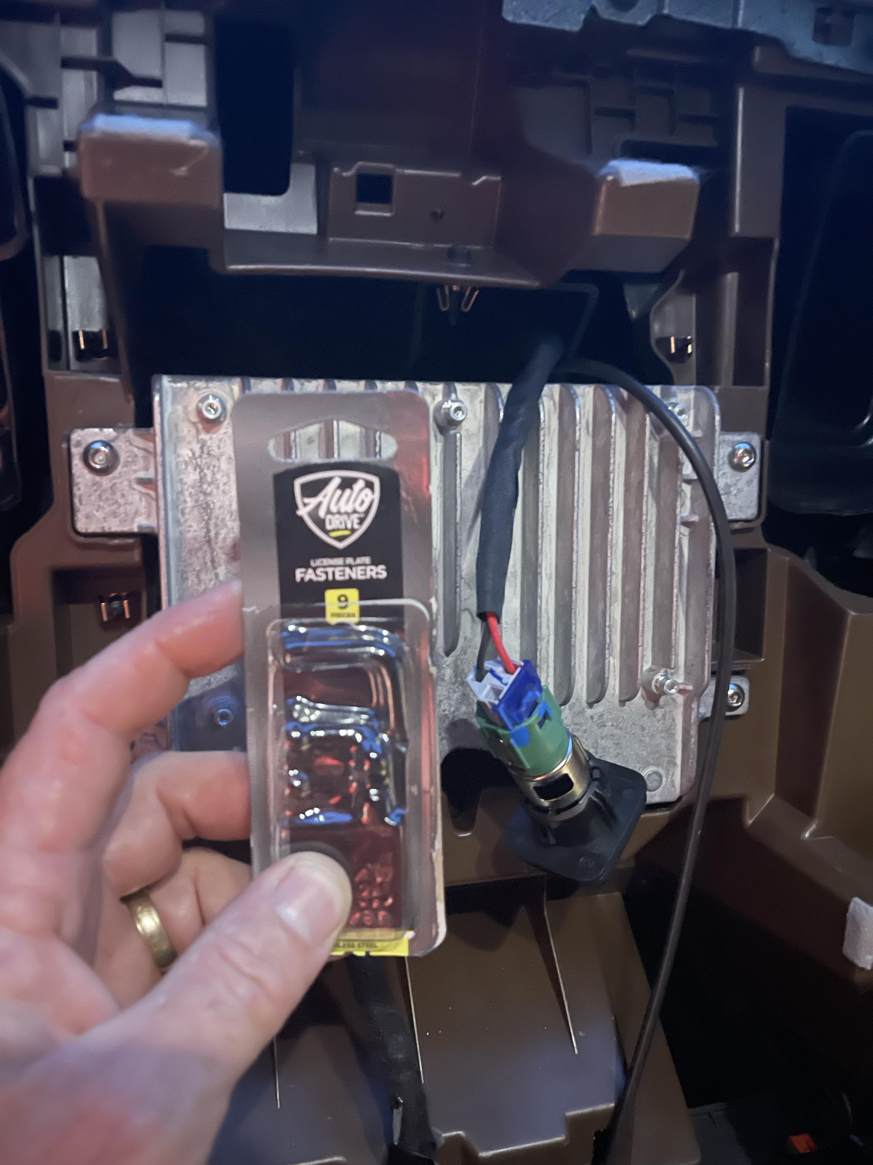

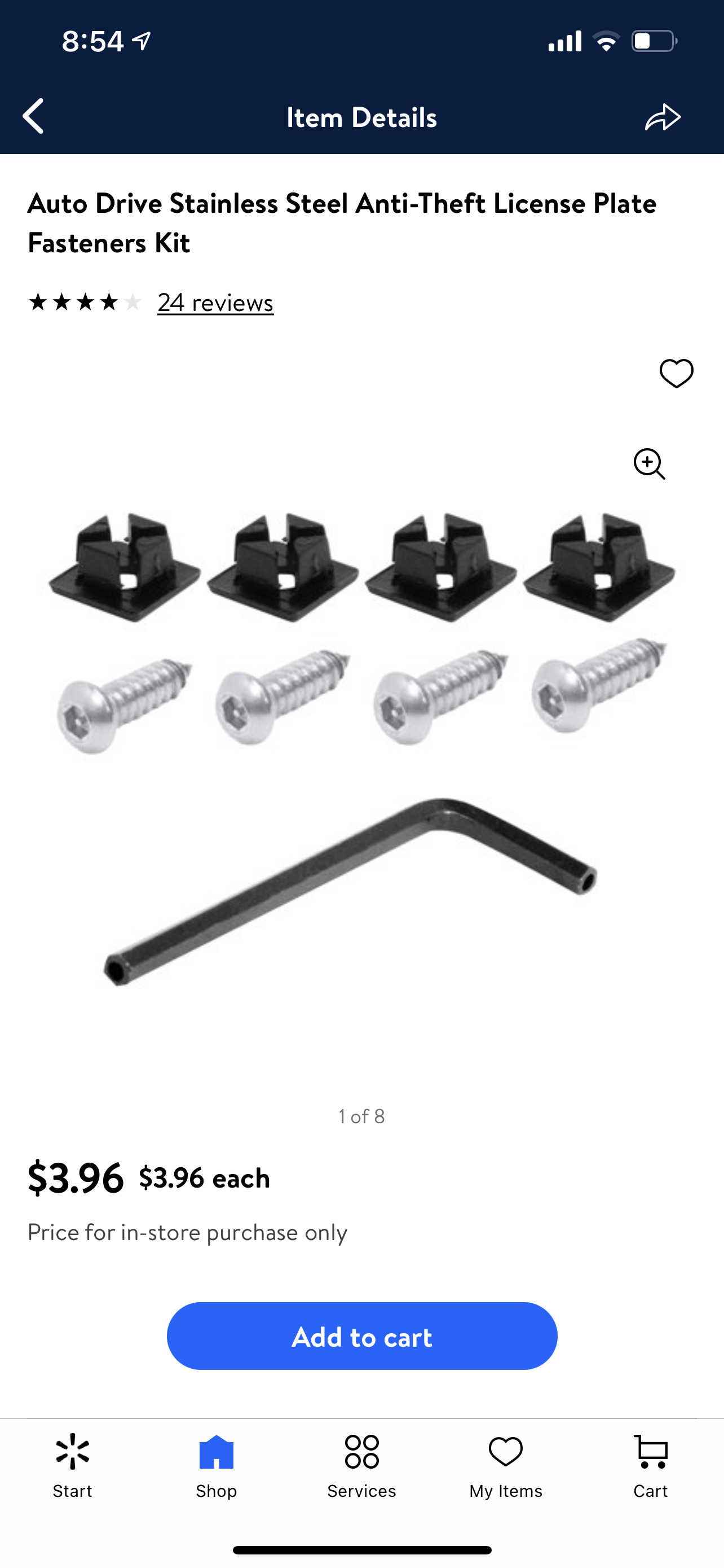

If anyone is looking for a cheap alternative to the pricy push nuts to install the module, I pick up these at Walmart. Cheap and hold the new module in securely.
