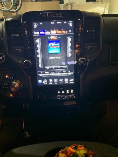

Finished my upgrade earlier this week. Very happy with the results. My Power Wagon now looks even better. Now if I could only upgrade something to improve its MPG :)
Thanks to everyone who have contributed to this thread.
