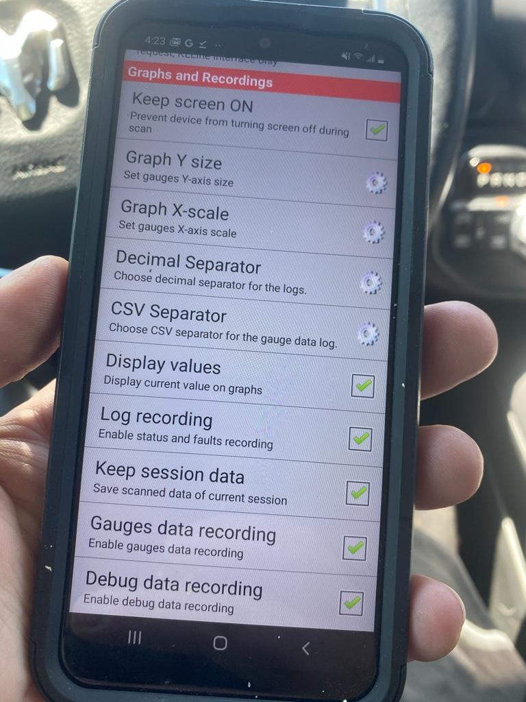

In settings up top, make sure log recording and keep session data are checked

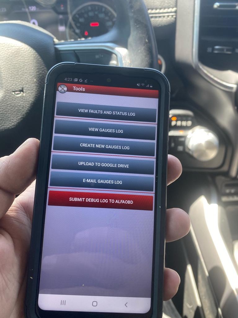

How do I make it read? This page?
Every time I hit view faults and status log it pulls the log up from yesterday
First you need to connect to the BCM with the ignition in run. Then select the battery icon on the lower right. Then select read system status. Let the list fully populate (might take a minute or so). Then select tools up top. Upload to google drive. Upload faults and status log. Select body_chrysler_info. Share that one here.
Then do the same process, but with the ignition off.

And @Jimmy07, as stupid as this sounds it keeps pulling yesterday’s data no matter what I do man
