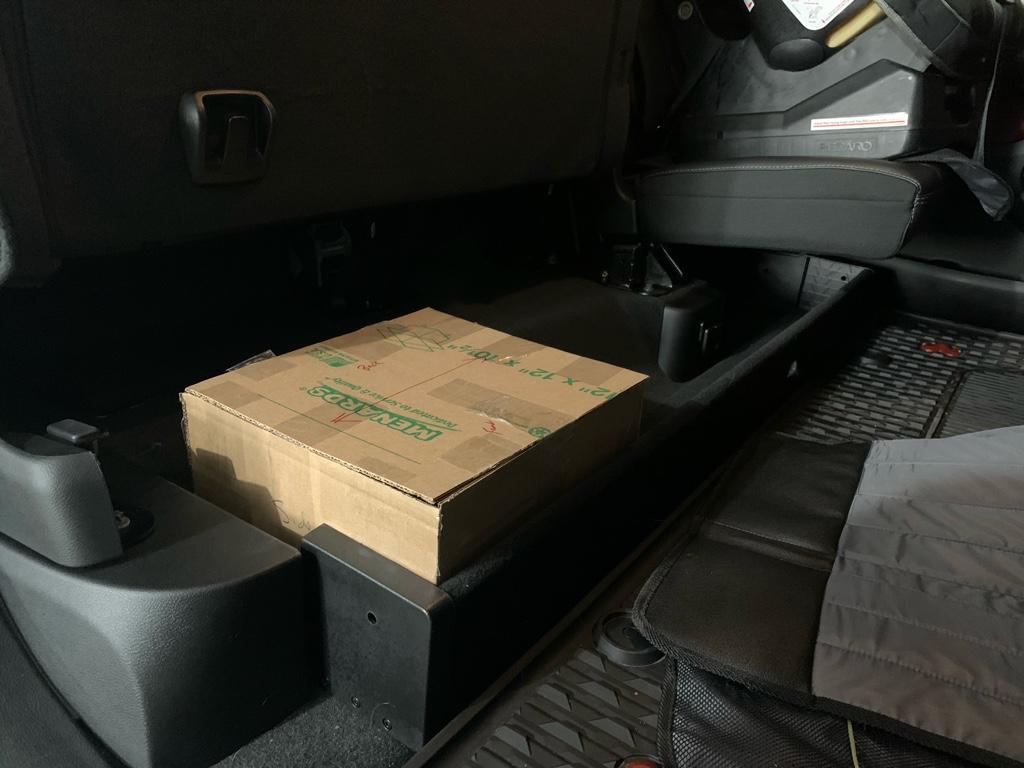

While Im waitibg for the truck, still D1, started putting together the pieces for my build. Best part is I had most of the items in my cache of audio Ive been hoarding for years.
Amp: 5 channel Helix HXA 500Q
DSP: Helix DSP.2
Front Speakers: Dynaudio Esotan 6.5 components, tweets will go where the dash speakers are.
Rear Speakers: Dynaudio Esotan 6.5 components
Anyone out there built a box to hide behind the rear seat? Ive heard there is a bump where the etorque battery would go. Im thinking about running a shallow mount Image dynamics IDQS12 and trying to save the underseat storage if possible.
