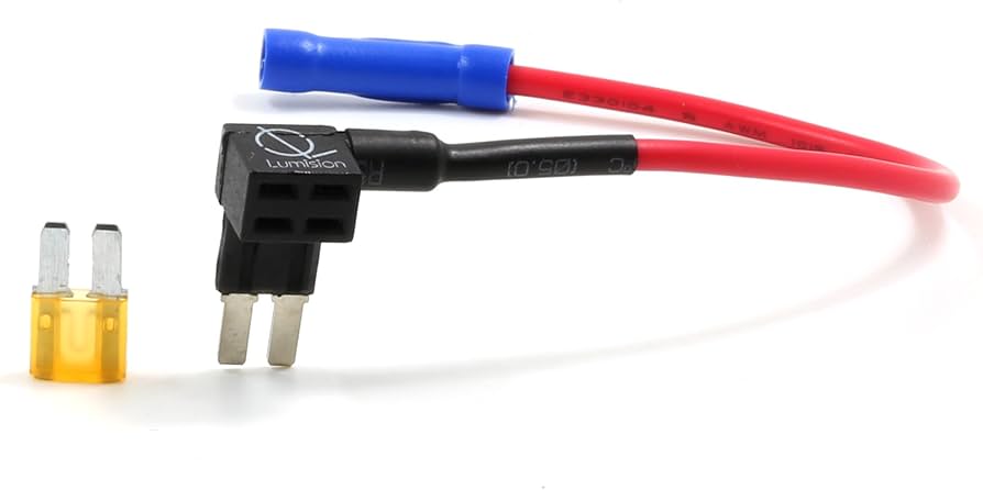

2020 RAM 1500, 8.4" UC, 6 speak., non factory amp and sub, ANC under the seat.
I'm installing a aftermarket amplifier. Where can I get the signal for the "Remote" of the amplifier? From which module or connector?
I've already checked all the connectors near the ANC module and I can't find it.
Hello!!!
Most new amplifier turn them self on when they detect a signal from the speakers.
Hello!!!
A "Micro 2" "Add a circuit" fuse tap in slot 66 of the internal box will do the trick - that's what most of us have done.
