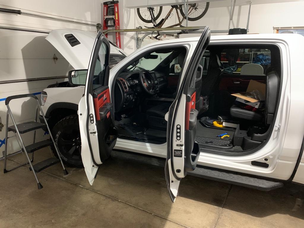

Ran my amplifier power last night. 4 gauge Knucoptz bassik power from the battery though the “aux wire grommet” nipple thing on the firewall through the sills and terminated under my rear drivers side seat where my amp and processor will live.
Running speaker wires tomorrow using the ACH harness cut so i can send the speakers signals to my processor/amp then back up to the harness out to the speakers.

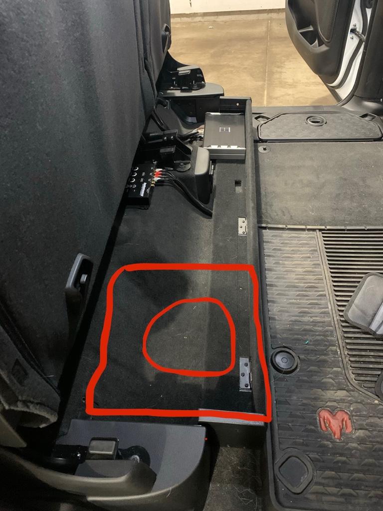

Still undecided on how I will install the hardware under the seats and the final design of my sub box but slowly making progress on my stereo.

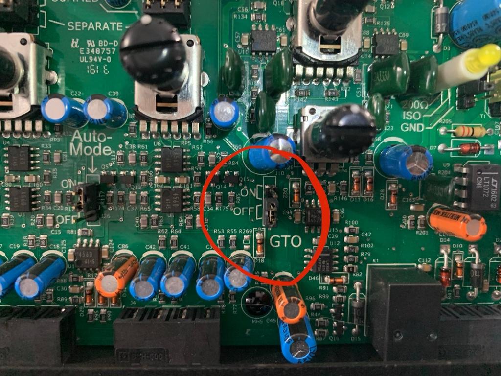

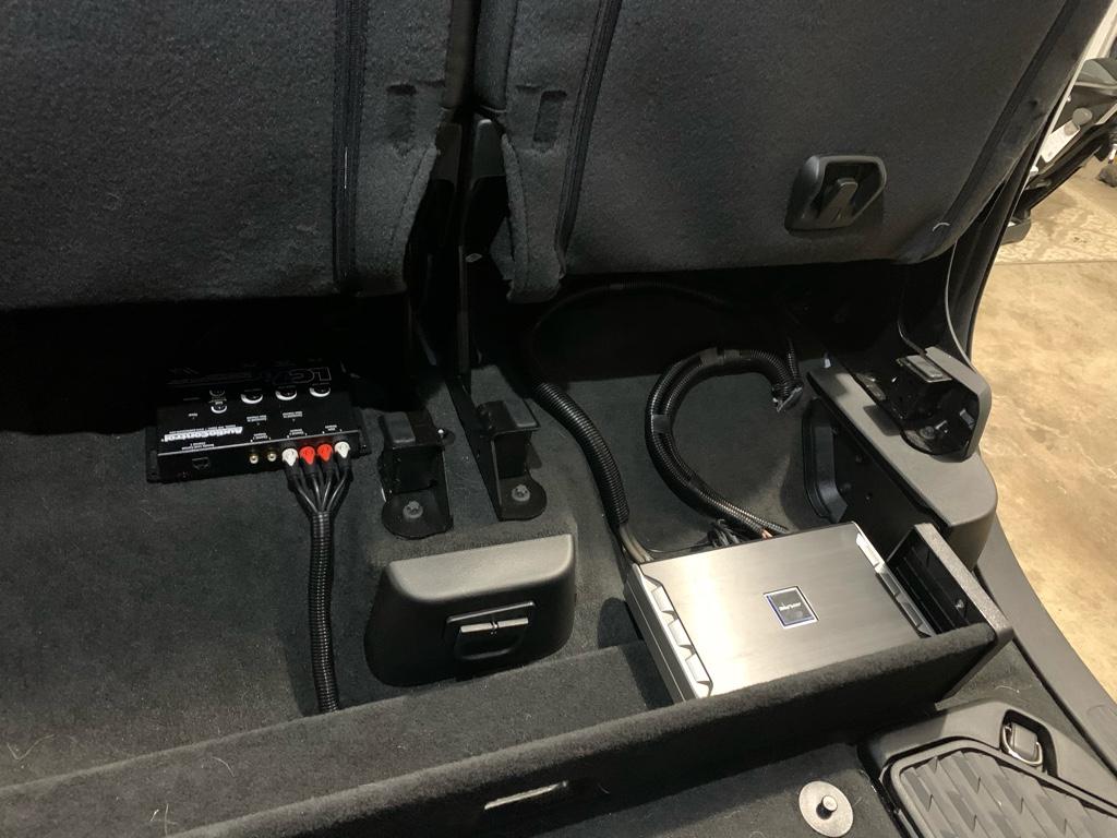

Ok got my processor and amp install Using the GTO auto sensing as my turn on lead which basically uses speaker signal to tell my processor to turn on.
I used the PAC harness which bypassed the ANC system and tapped that for my speaker signals to my processor and amp.
However ever since I reconnected the battery now my amp and processor stay on all the time so that harness I use is picking up a signal in the speakers somehow all the time.
Where is everyone pulling their switched lead from?
Edit: turned off gto (autosensing) on my processor and ran a switched lead from the I rental fuse box under the steering wheel connect via add-a-fuse to position F66. Everything works perfectly!!!!
