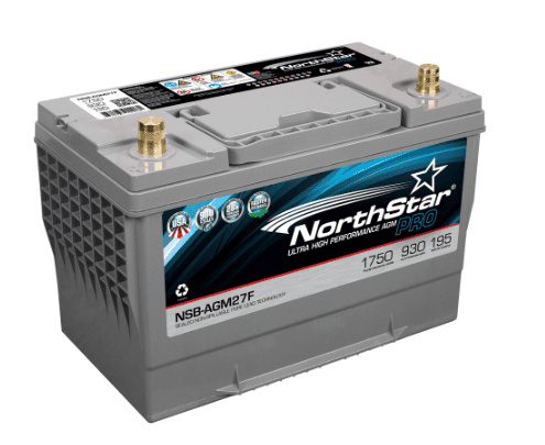

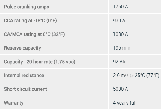

Ordered up a higher capacity battery as an added precaution, and to help with the parking mode on the dash cam that I ordered as well (it will give it more recording time). I've had several of these type batteries over the years, Kinetic (who only make caps now), XS Power and Optima. This time I went with Northstar, as it seems to have the biggest bang for the buck and the best warranty at 4 years.
33970
  • Pure lead AGM technology delivers exceptional CCA ratings and reserve capacity cycling ability
  • Quick starting every time
  • Cycles over 900 times at 50% depth of discharge
  • Faster recharge than conventional batteries
  • Proudly made in the USA at our state-of-the-art battery plant
  • OEM fit is ensured - built to exact BCI standards
  • Housed in advanced plastics for durability performance and heat resistance
  • Advanced AGM construction means no water levels to check or terminals to clean
33971
I was going to say odyssey makes great batteries also then I realized they make the Northstar too, will do the same when the time comes but want to do duel set up.
